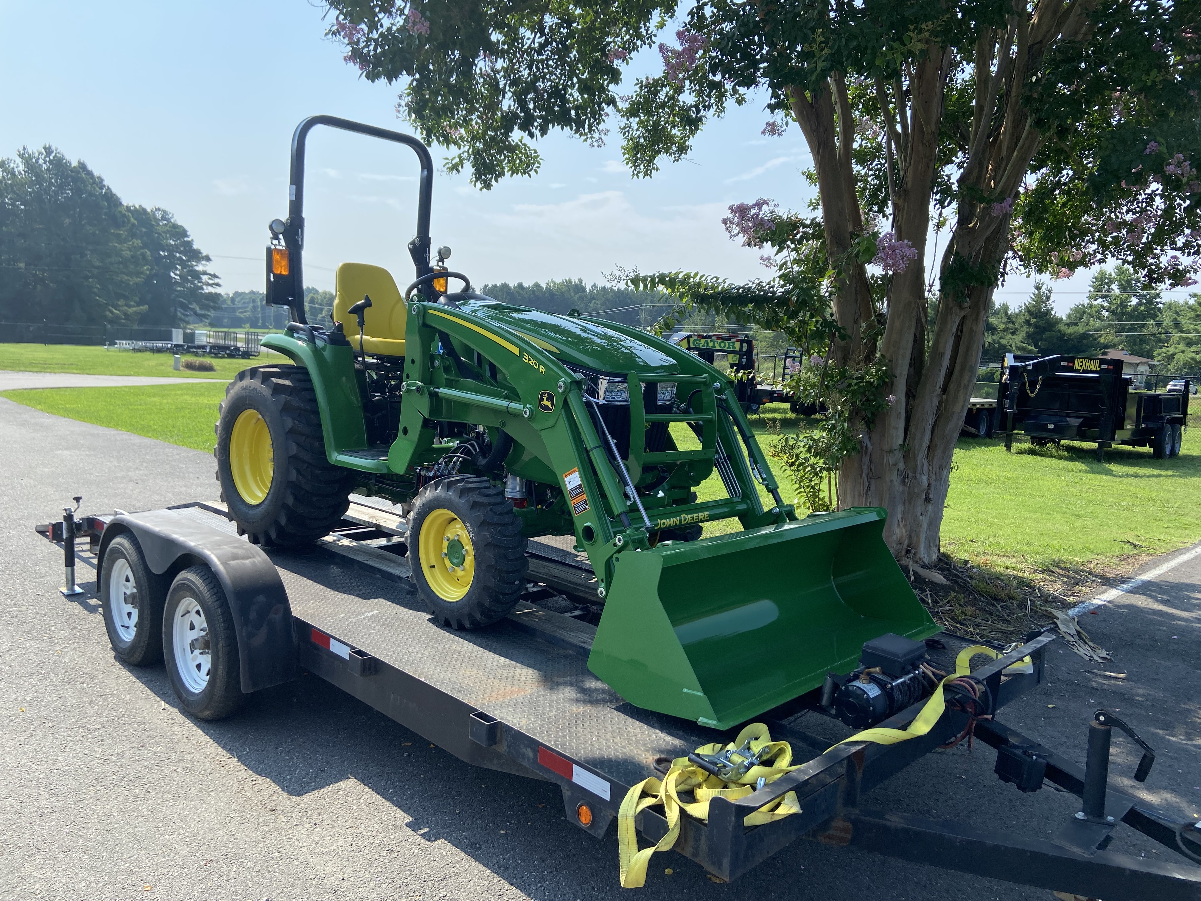

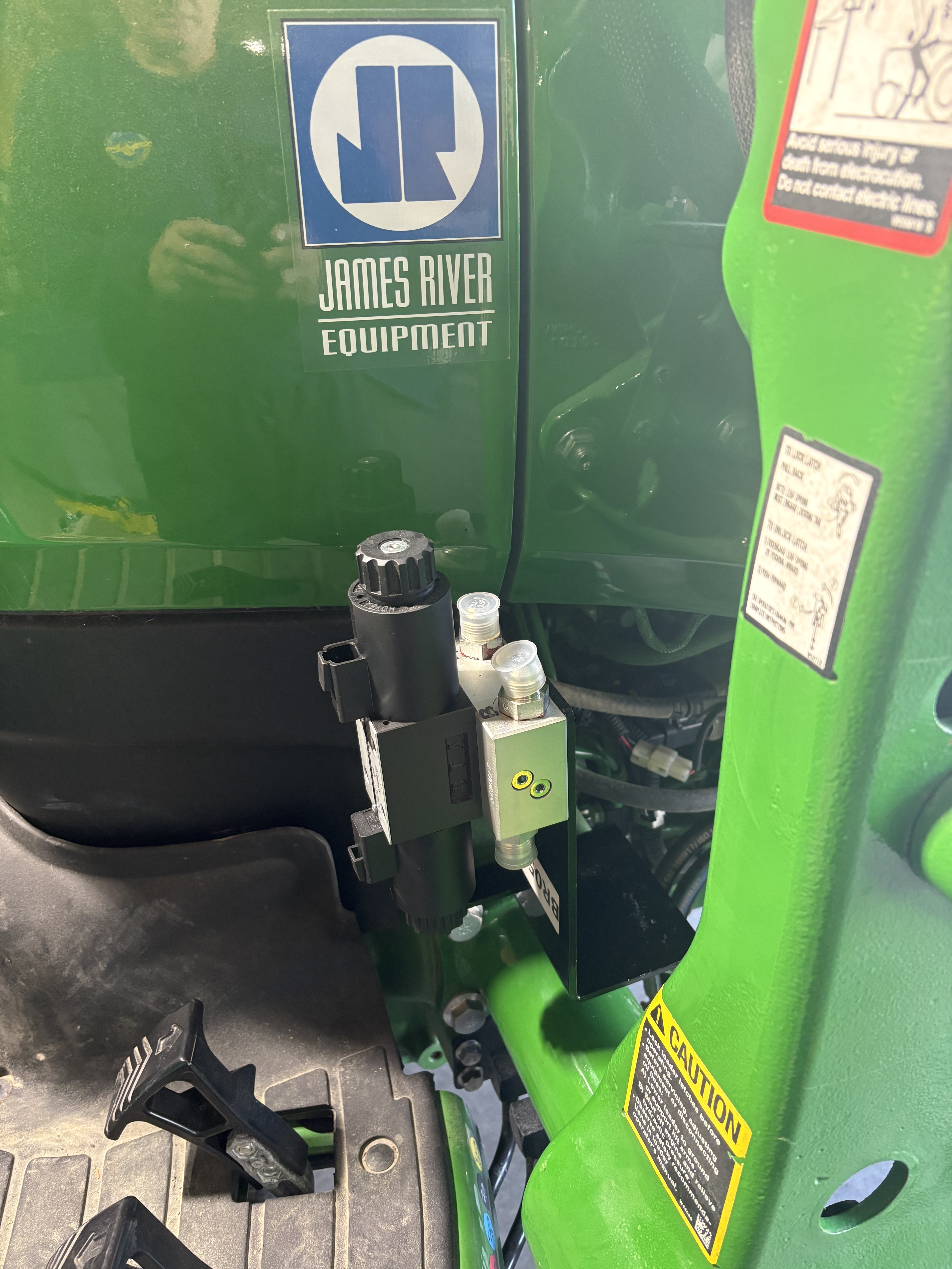

Regenerating some old farmland that I recently purchased. Have a new John Deere 3033R and am trying to figure out how to install a third valve set up on this tractor. Summit hydraulics sent me the kit to do this but no real instructions. If anyone has done this before, any help will be greatly appreciated.
I upgraded from a 1025R compact tractor to this new tractor and I installed that 3rd valve on the John Deere 1025R in about 3 hours. Can’t seem to figure out his new hydraulic system. Please help.

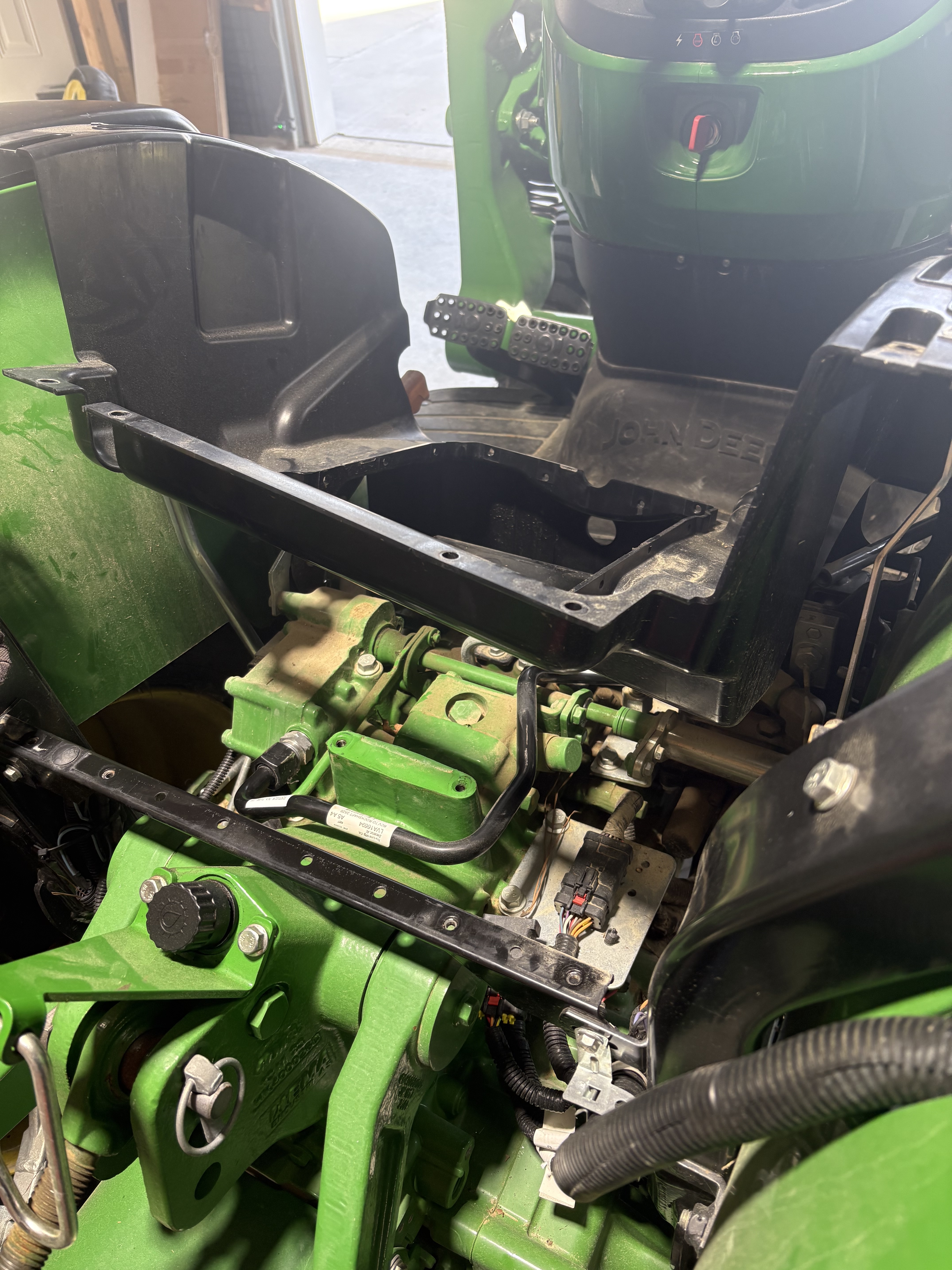

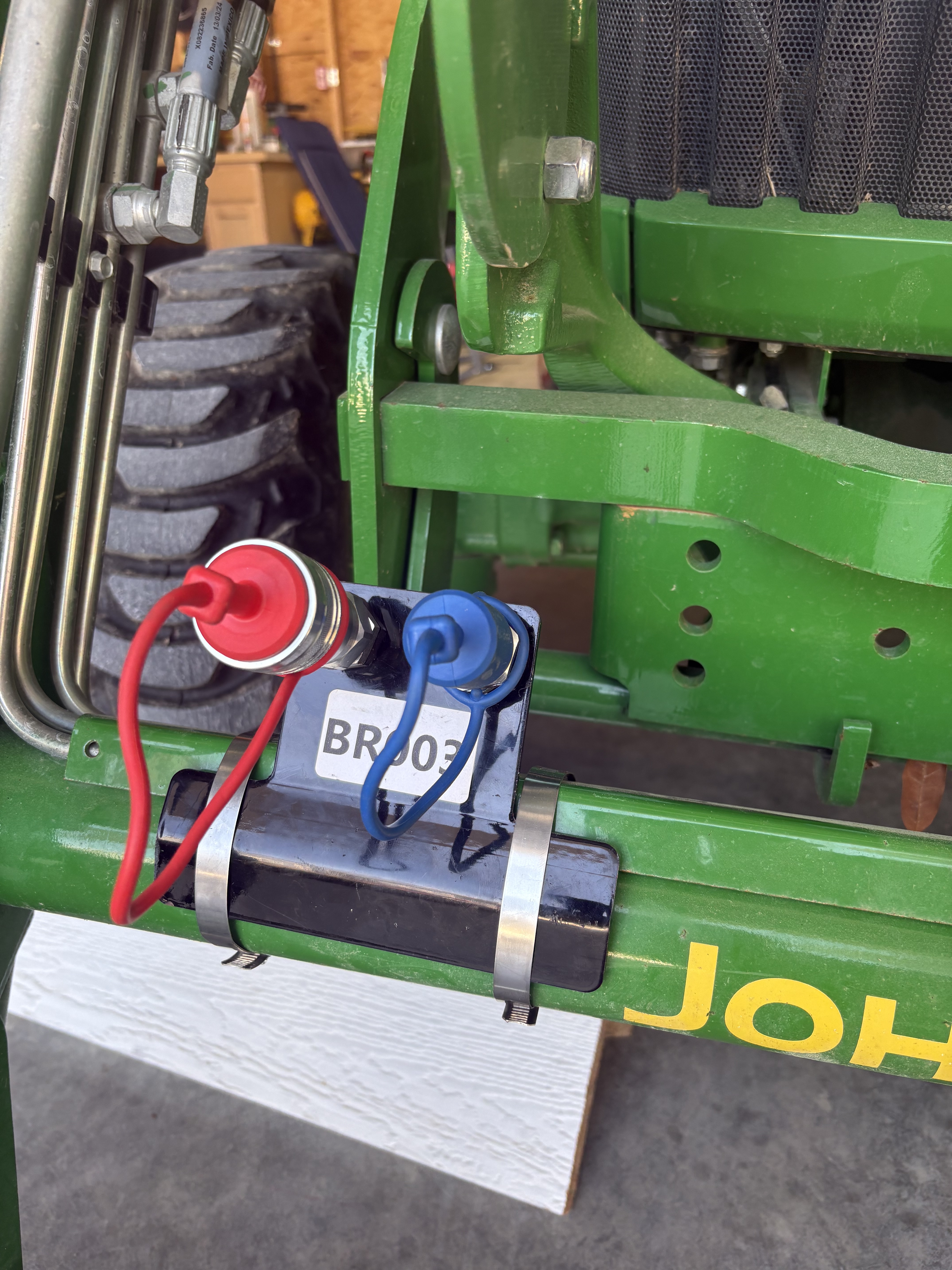

I don't know if pictures help, but this is how I did it. I wasn't concerned with pretty but function.
In back of tractor is power beyond. A long cloth covered hose (T), male end goes into a female coupling (P).
On control valve I put a female coupling on "T" port so long cloth covered hose connects into it.
Same with valve "P" port, a separate 3ft hose goes there to power beyond female "P".
"N" valve connector not used is capped off.
The top two valve ports I had hoses made which go to my top link, also about 3ft. long each.
Front hydraulics (grapple) I replaced FEL knob with one with a rocker switch. This goes to solenoid block that has two top ports (I used two hoses one male, one female connector).
Those hoses about 3ft long and loop around brush guard. Again...I'm not trying for pretty.
Power to solenoid I put a two pin connector on it so unplug when not in use...positive is the female one, doesn't matter if male touches ground. I used a 20A blade fuse right at battery.
I'll post pictures in next reply, hope it helps.
/ Hello #10
Front. Bottom of solenoid block long hoses go all the way to tractor back. You'll use lots of zip ties.

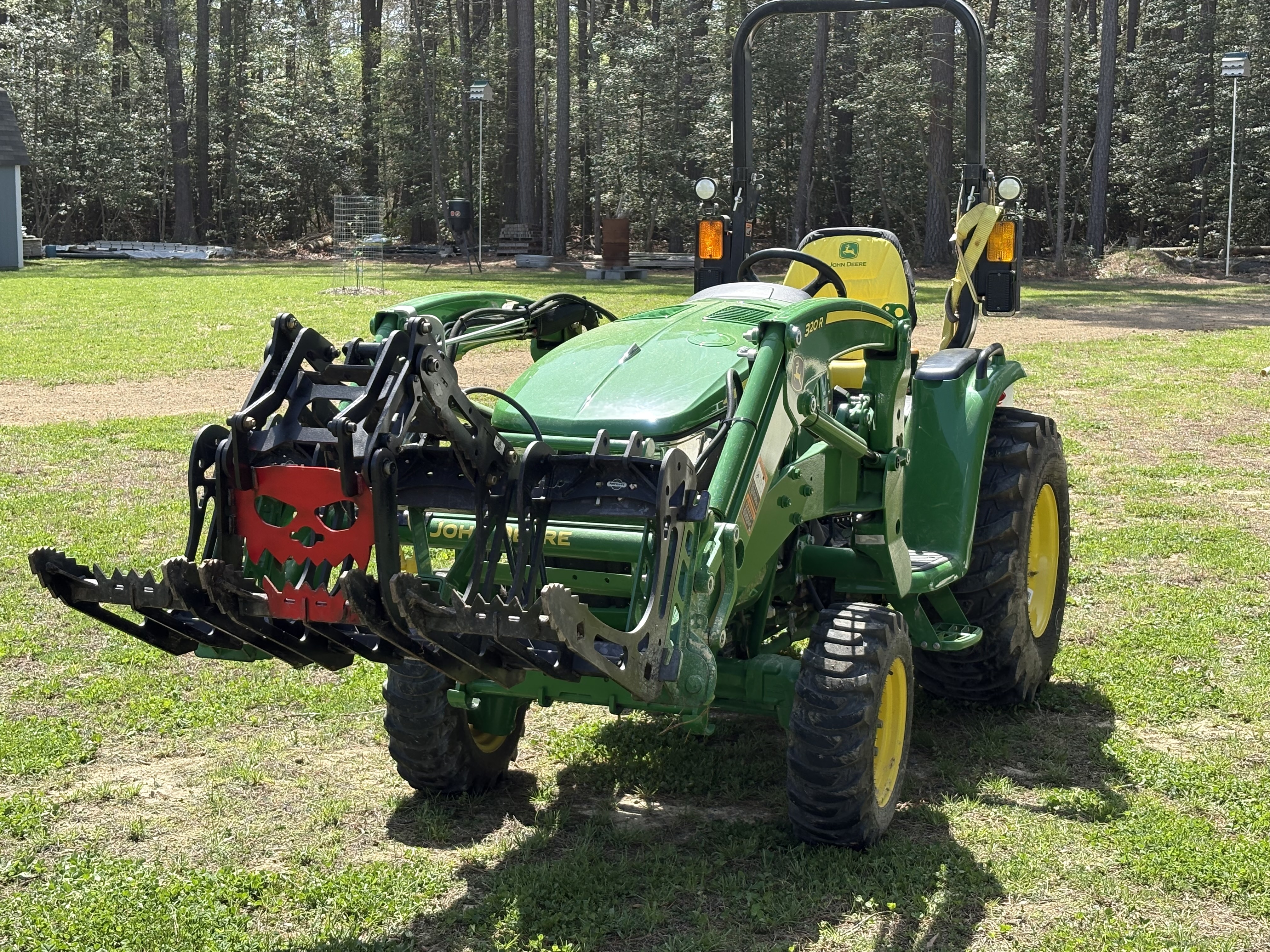

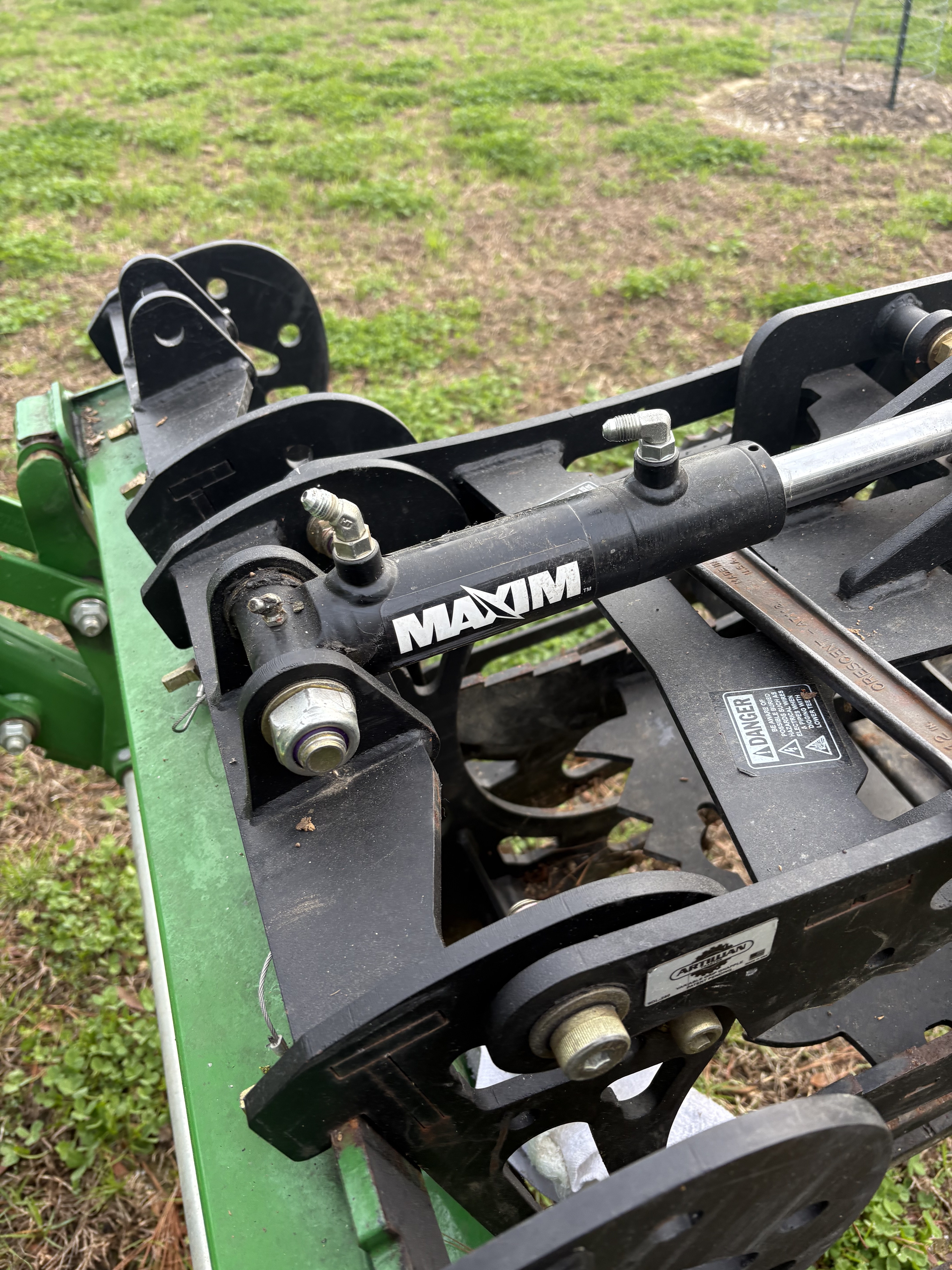

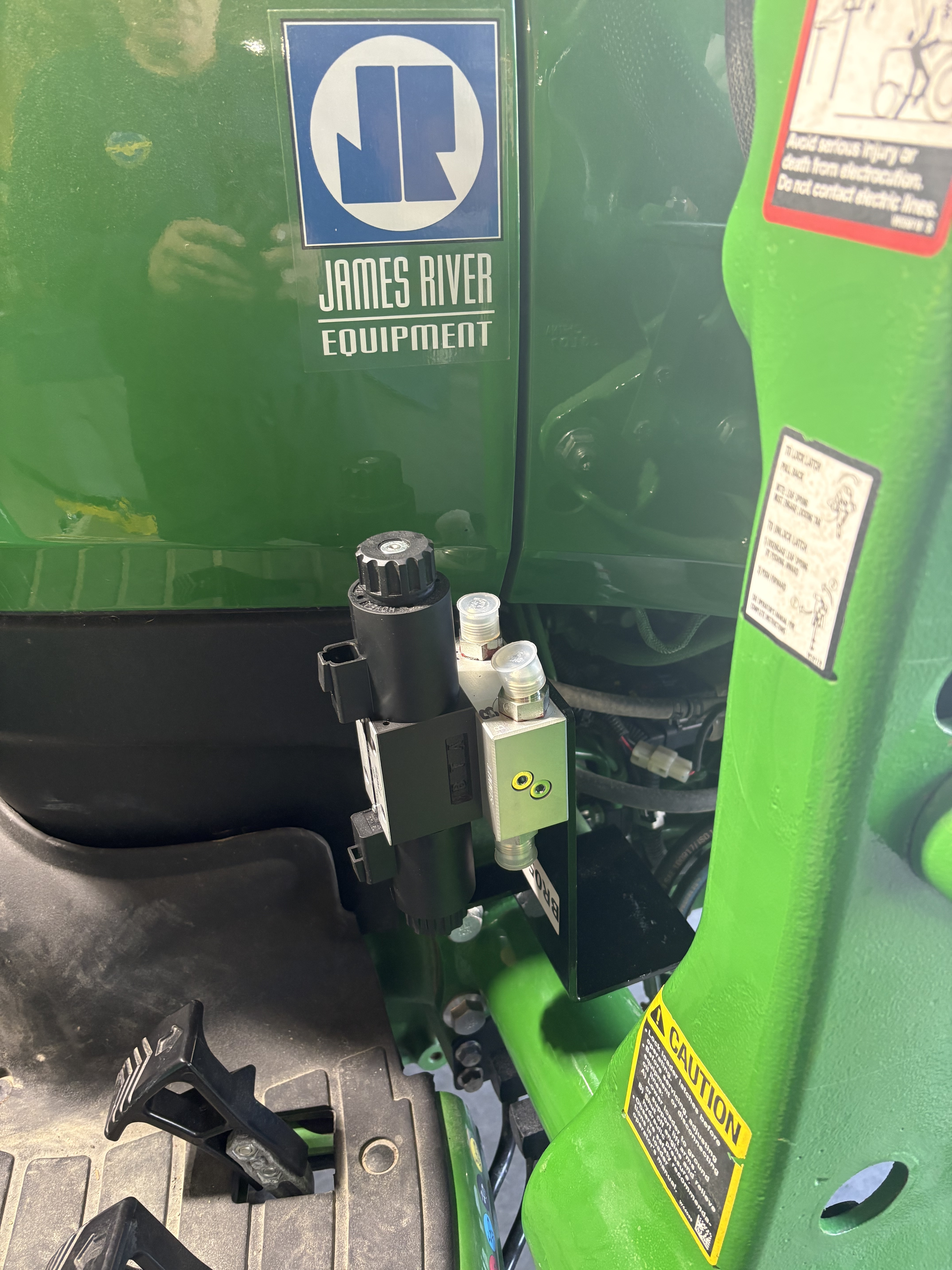

So I finally got my 3rd valve installed and it is working. However it seems that the opening and closing of my grapple is scary lightning fast no matter how gently I try to depress the buttons. Can this speed be controlled at all with the 3rd valve. I would never want to be close to this while it is being opened or closed. Thanks for all the help.

Not really all that hard once I got started

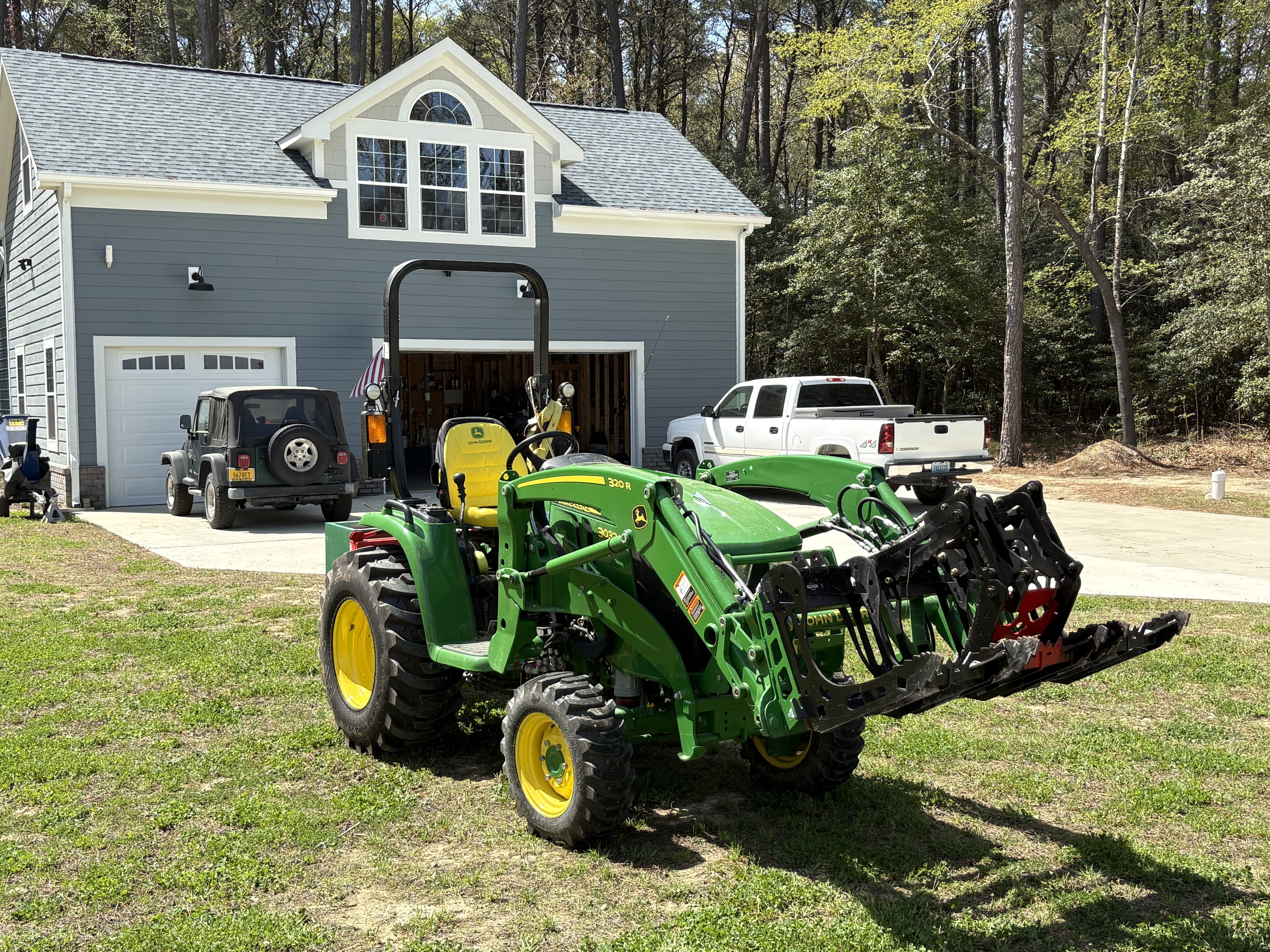

Well I was able to use the grapple to remove a 70 foot long 24” oak tree that had fallen on the property this morning. Works really well, however, the grapple opens and closes so fast it is really scary. Does anyone have any idea how to slow the opening and closing down to a safe speedIMG_6244.jpeg
/ Hello #16
I think that's the adjustment. Maybe someone else will chime in.
