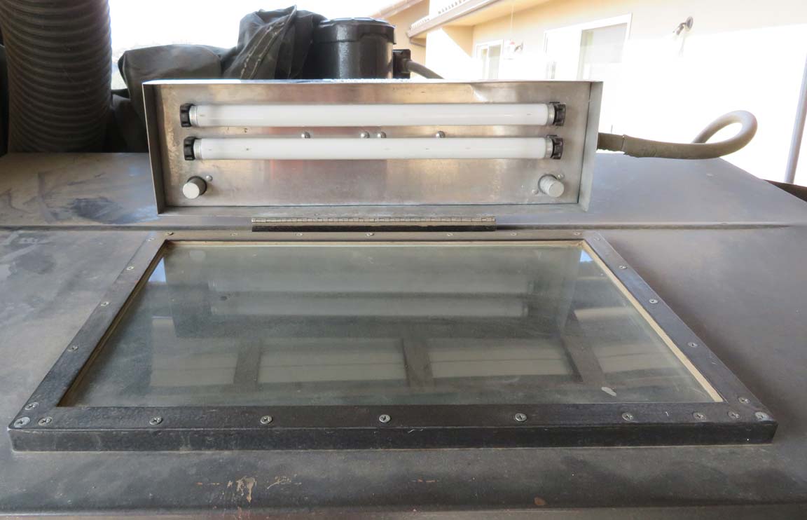

Yeah ... that's the same set up as the ones we had ... I didn't care for it as there was no seal between the fixture and glass view port ... so the viewport glass would pick up glare from the light. Would be easy enough to fix though, with some foam gasketing.
I'm thinking about several different options ... maybe hanging one of those stick trouble lights inside the cabinet. They're sealed (to some degree) ... so they might work well. Dunno.

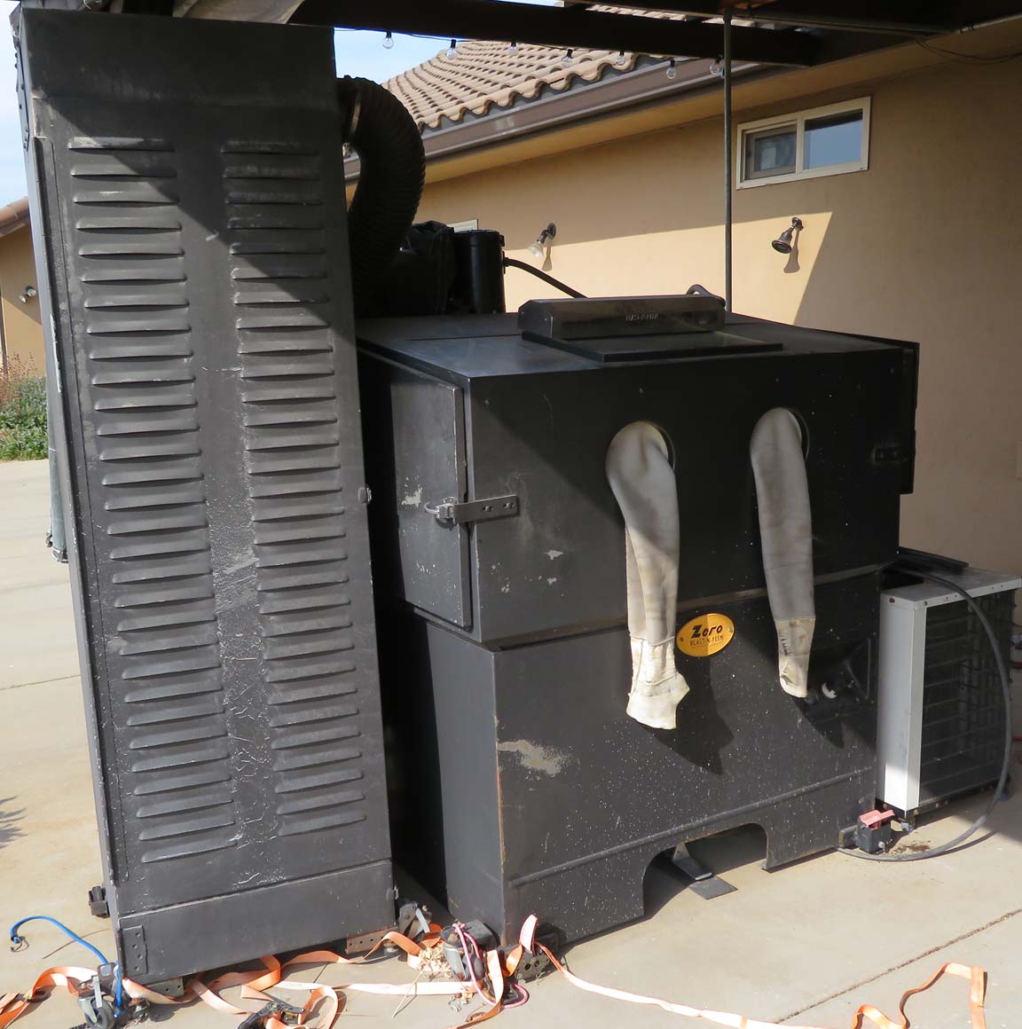

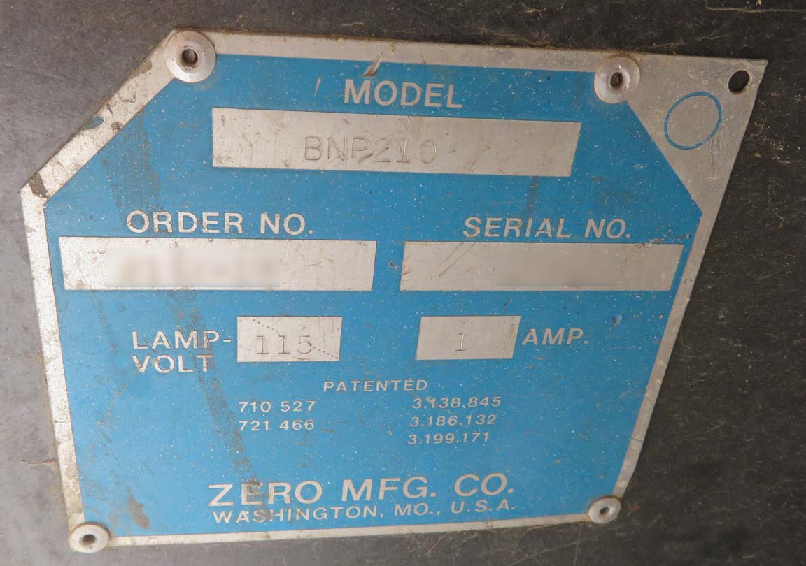

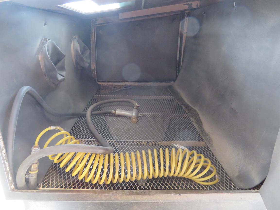

It's something of a mess after this latest round of use, but I guess beauty is in the eye of the beholder.
Just let me know if you need more shots or have questions, OK?

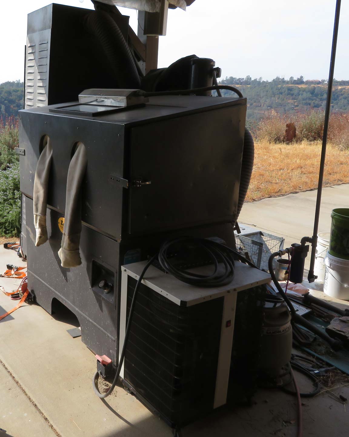

Oh, one thing I didn't mention before is the refrigerated air dryer you see just below the open end of the box. Probably don't need it in the summer out here, but in the winter water literally runs out of the thing, water that used to be in the air. If there's enough, it'll clog the nozzle and you won't get much done. It's another CL find, an orphan from a cabinet maker put out of business by offshore competition. It didn't work, either, and needed some parts, easily found because it's an Ingersol Rand.

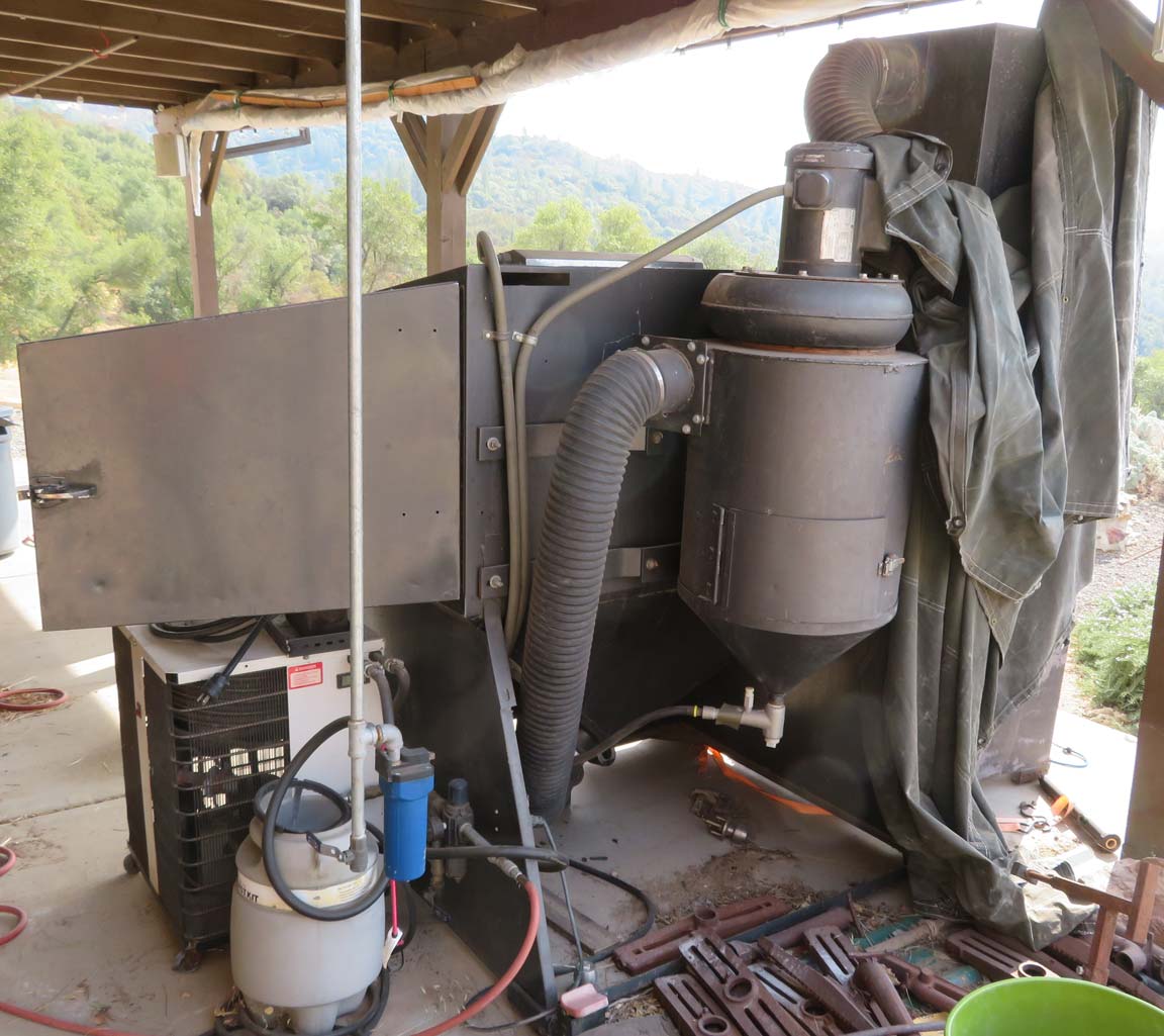

And one more thing. I found the recirc hoses, gloves, and large hose clamps at McMaster-Carr.
The baffles in the hopper were rusted out, so I used another CL orphan 3-in-1 roll/brake/shear to fab replacements and a GMA welder to install them.
Painted the whole mess with Rustoleum, but if I had it to do over again I'd have used automotive urethane enamel.
There's also a compressed air chuck in the box that I keep a duster on. I use it for dusting off parts and knocking media off the walls and blowing it down into the collection chute. There's an old pair of pliers that live in there, too, along with a metal mesh basket for small parts.
Hey ... if it's functional and operates reliably what's not to like ?
Great idea on the rubber sheeting ... :thumbsup:
Will do.
Likely to be the reverse here ... humid in summer. But I'd be using it in an air conditioned shop so the humidity would likely be low(er) ... ;)
Also all the hard pipe in the shop is copper and has lots of drops to catch moisture ... plus I have a Motor Guard filter I could run the air supply through.
Good deal for you.
Thanks. Yeah it looks like they are in line price-wise with the cheaper gloves from TP Tools. And everything I've ever gotten from McMaster has been decent quality.
Which baffles ?
Inside the cabinet, for the dust collection system ?
With as much as you're squirtin' I'm surprised you didn't ... :D
Yeah ... the green ones we had had a compressed air line with a blowgun on it in them as well. Good idea.
Definitely will have to pick up a mesh basket ... :thumbsup:
