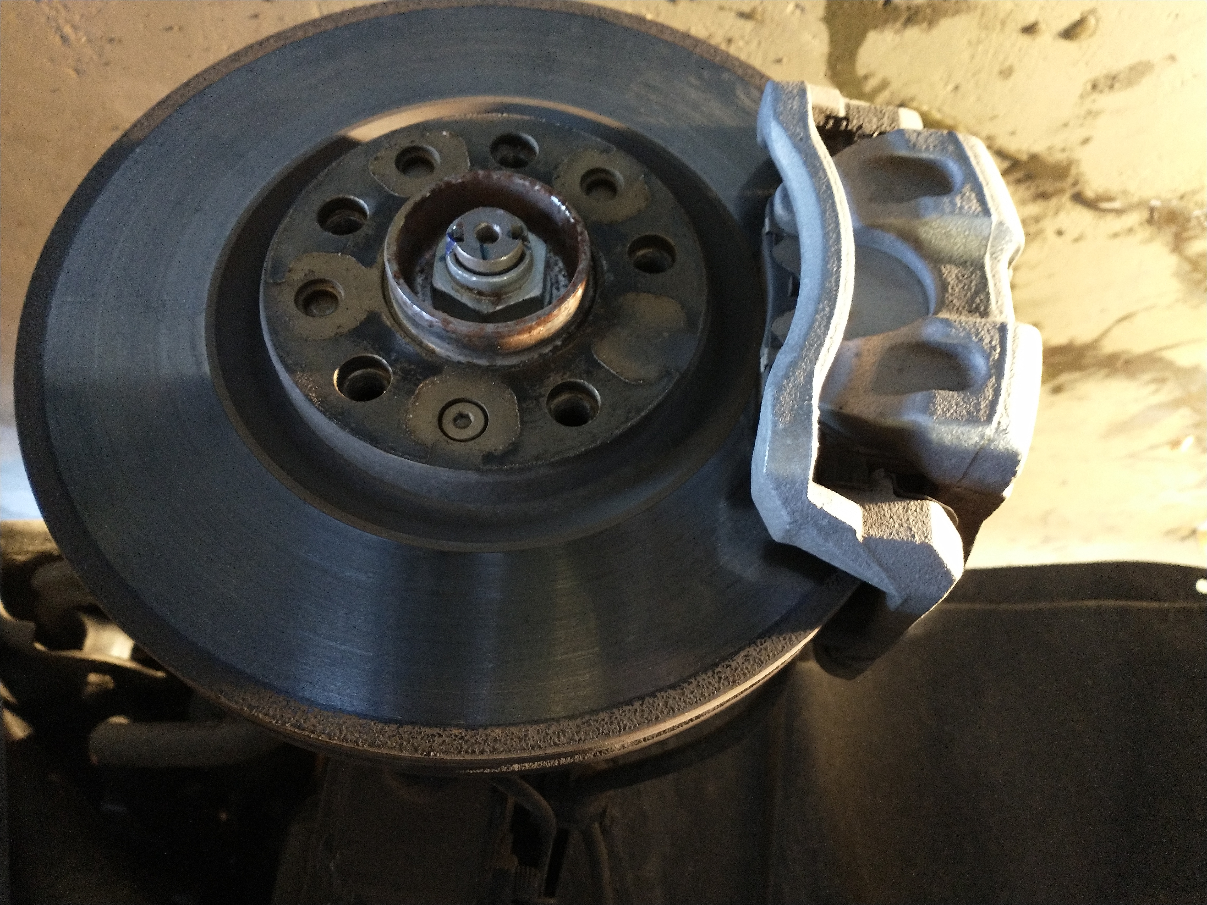

on my wifes little Jeep Compass for some reason they used lug bolt instead of studs and lug nut.
These are a hub centric wheel and with no wheel studs to help line up the wheels to the hubs can be a royal pain to get set on the wheel hub and lined up to start the lug bolts,
I went to my hardware store and bought a couple of long metric bolts remove the hex head and cut a screwdriver slot in the end.
the Jeep wheel hub;

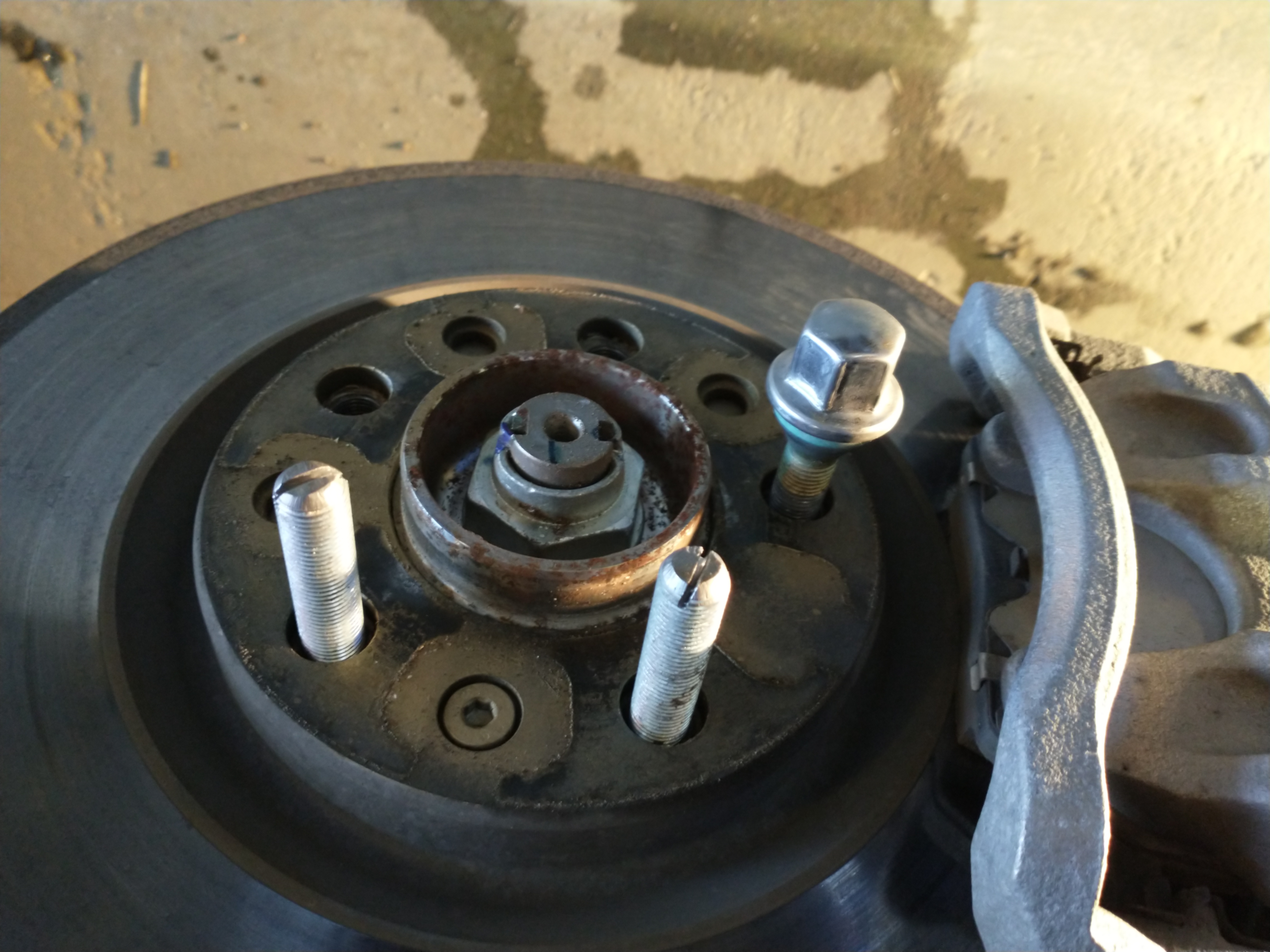

the wheel hub showing a stock lug bolt and the two studs I made, I screwed the studs in 4-5 turns, then used them to line up the wheel to the hub,
slide the wheel over the studs, start 3 lug bolts remoce the studs and put in the last 2 lug bolts. Took several minutes of bending down and trying to line up blind holes to just a couple of screwing in the studs hanging the wheel and removing the studs. Didn't even cuss Jeep once when putting her already mounted snow tires on.
My Buddy replaced the bolts with studs and nuts, used Loctite on the studs into the rotors.
