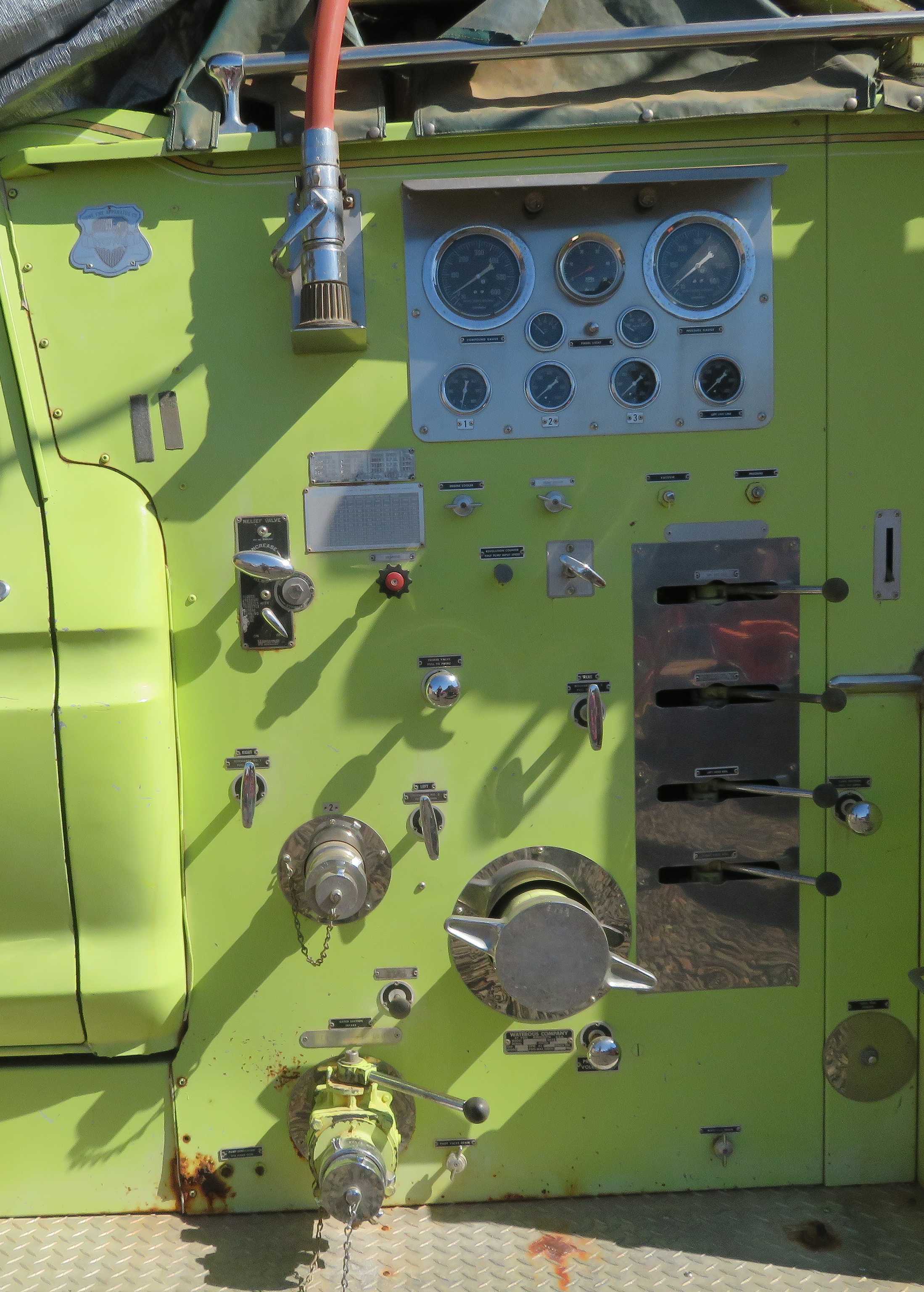

Relief valve could be stuck. Turn clock wise all the way. Should always be left in the highest mode so if it fails you can still build pressure. The bolt beside the relief is the strainer it might need to be cleaned. And if it relief is stuck on low side then wd 40 and work the valve.

There is a Pressure Relief Valve (top row of controls, left end), but it doesn't seem to have any effect, Rick. At most I've seen 45 PSI on the gauge. It's set up to draft water from the 2500 drinking water tank, and the fill valve to the onboard tank is closed. Water is making it out the end of the hose, so the lines are primed, there's just no pressure...

What's your intake gauge reading while at 45psi discharge? What gear are you pumping in?

There are two pressure gauges on the panel, and neither are marked as to what they measure. I've never seen anything but zero on the one on the left, the most I've seen on the one on the right is about 45 PSI.
It's a five speed transmission, and I run the engine at 2000 RPM with the tranny in 5th, which is marked as an overdrive gear. The Waterous instructions say to run the pump with the transmission in the highest gear. I can hear the PTO turning, but I haven't poked my head down there to see it turn, so maybe I'll do that today.
I'll take a look at the pressure relief valve, and review the operating instructions in the Waterous docs. I asked the PO about it, and he doesn't remember ever "messing" (his word) with the pressure relief valve.
I'm not using the on board water tank anymore, mainly because I'm worried that there is still debris in the lines that run between the tank and the pump. No real way to flush them that I can see.

Ok. So you're in the right gear. The gauge on the left should be your intake/vacuum gauge. The one on the right is your discharge/pressure gauge. 2000 rpm and still only showing 45psi? What is your intake gauge reading prior to opening a discharge to flow water? Is it at zero or above? Does it fall lower when you open a discharge?
the pressure relief valve is a wheel, first off, crank it all the way counter clockwise. This is the lowest setting. Then, crank it about 16 turns clockwise. This should put you above 100psi at least. Then should be a short teardrop lever under the wheel. Work it back and forth, then leave the tail pointing to the right. This should be closed. There should also be a round knurled knob under the wheel. Screw that out counter clock wise. It is the screen for the pressure relief valve. Make sure it's clean and re install.

Firetruck update:
The relief valve was screwed all the way in and the switch below it was set to off for the previous round of tests, so I left it that way. The Waterous manual sez in that setting, the pump will develop maximum pressure. So I left the discharge closed and ran the engine RPMs up to 2800, and was able to manage 80 PSI. There's a plaque on the side of the truck that indicates it should be making 150 PSI at those RPMs.
When I opened the discharge valve to the hose reel, and opened the nozzle, I got a pretty good stream of water, but it lasted less than 15 seconds before it petered out to almost nothing. I shut the truck down and took the nozzle inside. When I disassembled it, flakes and chunks of rust came out, some as big as a pea. I blew it out with compressed air, reinstalled it, and got a repeat performance of the running and clogging.
Brought it back inside, found some fine stainless steel mesh, and cut a disk to fit in the base of the nozzle. Took the nozzle back apart and blew it out. Put the mesh in, put it back on the hose, and got a really good stream for maybe 30 seconds before it choked off again.
Took it back inside, disassembled, and found that the mesh had torn along one edge and there were rust flakes up inside the nozzle again, but fewer of them. Put it all back together, made a bigger mesh disk and folded a rim around the edge and gave it another try. Except this time I forgot to put the draft hose in the tank. Got a good stream initially, but it crapped out when the water in the hose was exhausted. At that point I'd had enough for the day anyway.
So some progress, but the pump never really did develop the specified pressure, even when all the discharge openings were closed and the relief valve was disabled. The stream it put out was as big as I've ever seen it coming out of the truck, even from back a few years ago when my neighbor and I were using it to keep burn piles under control. Regardless, I need to figure out how to get the scale out of the pump so it quits clogging up the nozzle.
Any suggestions?
I also need some kind of spanner wrench to work the collars on the hand line and on the suction line. What do the pros use, and where would I get them?
Thanks again!

I think your zeroing in on the problem. You're just going to have to flush every line in your system. You have three outlets for hoses plus your hose reel.
Open the three hose connections, on your panel, one at a time and pump thru that circuit. Don't hook a hose to your outlets .. no sense pumping crap into your hoses / nozzles. After you clear the internal truck circuits .. you can flush your hoses.
Pump thru your hose reel .. without the nozzle.
If you're by yourself .. all you'll ever use is your hose reel. You can't handle a 2 1/2" hose .. at reasonable pressure .. by yourself. To handle a big hose .. you need at least 2 men on the line and a third operating the truck. Trust me on that.
