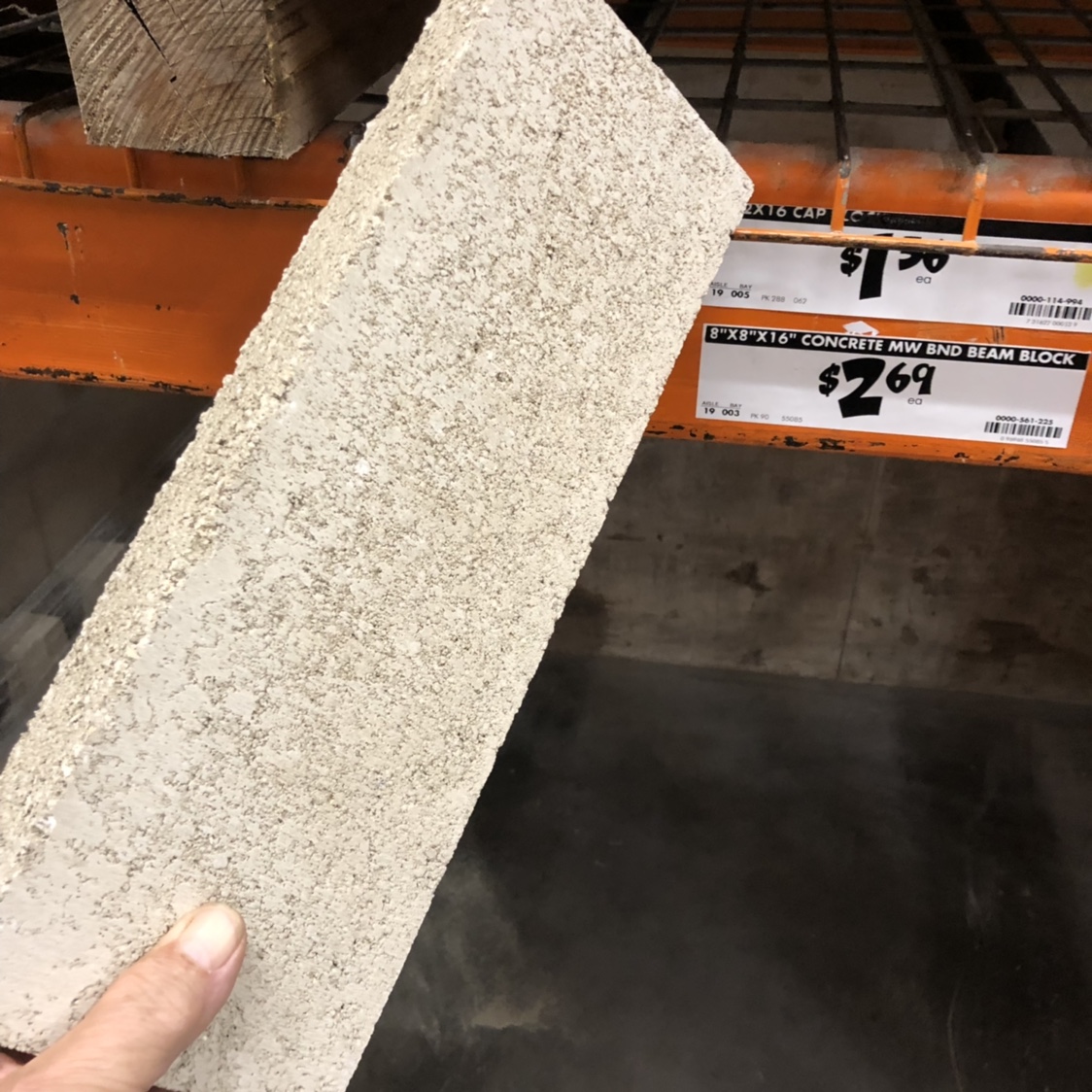

Drew don’t know what they are called, but I’ve seen concrete “brick” about 1 inch or so thick but larger than brick
I suspect your 1x4 wood would soon rot

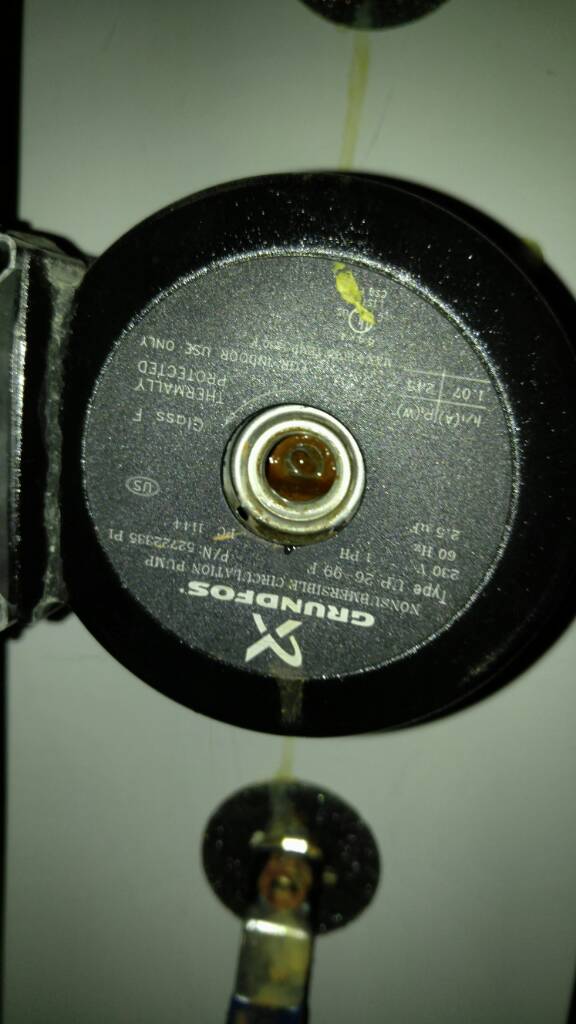

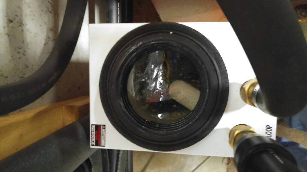

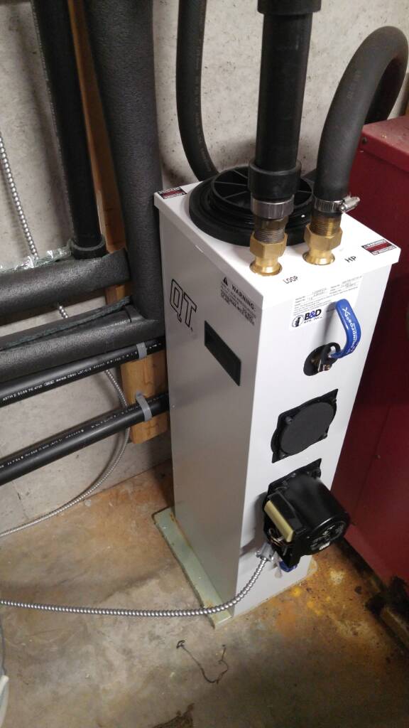

Do you have water flow in the loops? Is it pressurized loops? I use the non pressurized pumps, can open and see the water flowing. Also, amp probe the wires to the pump and check current.1544896718042.jpeg1215181300.jpeg

David- I believe those blocks are called "pavers" or paver block.
I'll look for alternatives at Lowes, thanks David. Rain is just stopping now, so soggy out can't even use golf cart if I don't want to

Do you have water flow in the loops? Is it pressurized loops? I use the non pressurized pumps, can open and see the water flowing. Also, amp probe the wires to the pump and check current.View attachment 583099View attachment 583100
Thanks for helping.
I don't know for certain if the loop is pressurized...these pumps can take 150 psi...and the installation manual calls for 50-75 psi in winter or 35-40 in summer. I don't have a bladder/pressure tank.
I don't feel vibration on the pump cover or pipes.
I need to take a class like I think I remember you said you did.

I suspect you have a pressurized loop system, is one marked in and the other out? Or are both pumps in series with only one set of loop pipes? If it's waterfurnace, it's pressurized.
See that screw cover on the pump, with the system turned off, you can unscrew that cover, and there should be small screw slot in the end of the motor, you take a screwdriver and see if the pump turns freely. Water will leak out when you remove the outer cover, so i hesitate to tell you..

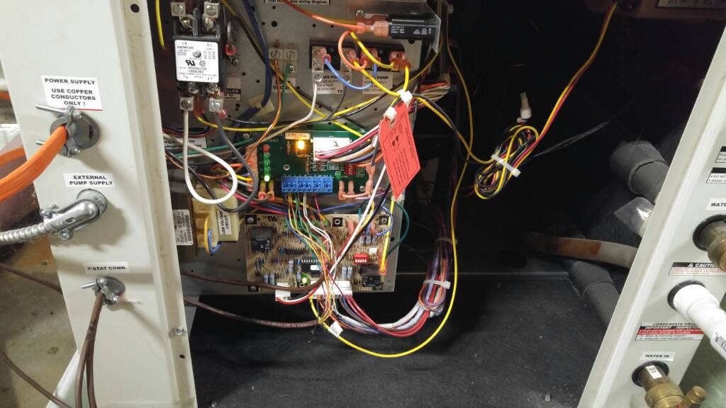

What brand of geo heat pump? Can you remove an access cover and see control boards? Look for any flashing leds.
Mine has chart inside that gives meaning of flashing code.

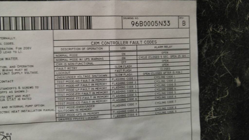

View attachment 583120View attachment 583121View attachment 583122
It is a ClimateMaster Tranquility 27. It's under the house, so I'll check your other questions tomorrow. I removed the cover and checked the LED about a year ago for a tech doing some diagnostics over the phone. I think I remember which one, but not sure how to read the flash. Thanks again.
   / Good morning!!!! #85,879
Mine uses same control board as some climatemasters. Should be same codes as in 3rd pic i posted.
