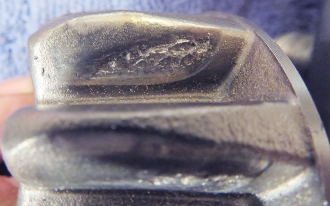

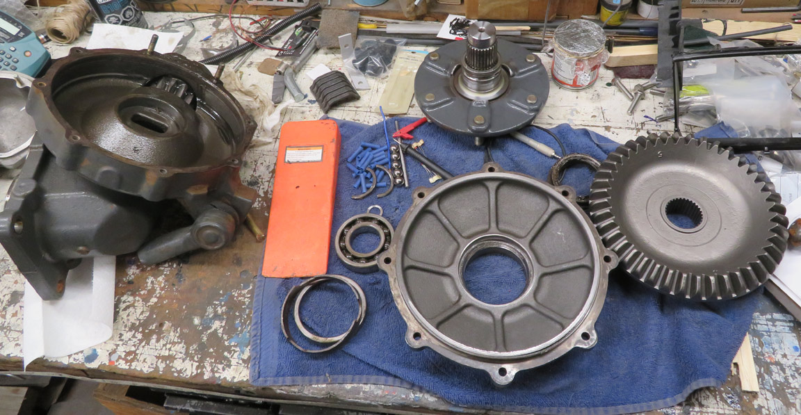

RNG, I had noticed an oil 'stain' on my tractor's front hub /wheel about 2 weeks ago. I pulled the wheel, cleaned up the hub, put it all back together, and used the tractor / loader for a little bit. No obvious leaking, no more signs of oil....?? I'll keep an eye on it, but can't figure out why it initially leaked. I may have parked it on a slight angle a few days before noticing the leak. Hopefully yours will be just as simple.
Thanks for the positive thoughts, Ted, but it's gonna take a $650 Christmas present from the Kubota dealer to get the tractor goin' again. At least according to the parts page at Messick's. The outer axle bearing split in half at the thinnest part of the outer race (it's a ball bearing). For a while the hub cover casting was acting as the outer race, so that wiped out the shoulder that supports the bearing. The inner axle bearing is rough, probably from working off axis after the outer bearing failed. The oil seal failed, and it looks like the surface on the axle it rides on is cut up, so it might be time for a new axle. That part alone is almost half the cost, but if the surface is part of the seal instead I'd be very lucky. All the shards fell into the lower gear case, and when I pulled that apart I found that the bevel gear bearing was shot, and that the bevel gear teeth were badly pitted. I've never seen wear that bad before. I was actually a bit surprised that the total cost of the parts was so low, considering the number of bearings and machined parts involved. I'm just glad that the rain held off long enough for me to get the parts off the tractor.
While cleaning them up in the parts washer, the solvent wasn't having much of an effect. I pulled the parts washer out from under the patio cover to get it away from the house just before I evacuated, and we had a couple pretty good rain storms while I was away, so the tank is probably full of water as well as solvent. The pickup is on the bottom of the tank, so that would explain the lack of cleaning I was seeing. Ended up cleaning up everything in the kitchen sink, using an old bath towel in the bottom to keep from scratching the stainless steel. Time for another 5 gallons of Stoddard solvent next time I'm in town...

Thanks for the positive thoughts, Ted, but it's gonna take a $650 Christmas present from the Kubota dealer to get the tractor goin' again. At least according to the parts page at Messick's. The outer axle bearing split in half at the thinnest part of the outer race (it's a ball bearing). For a while the hub cover casting was acting as the outer race, so that wiped out the shoulder that supports the bearing. The inner axle bearing is rough, probably from working off axis after the outer bearing failed. The oil seal failed, and it looks like the surface on the axle it rides on is cut up, so it might be time for a new axle. That part alone is almost half the cost, but if the surface is part of the seal instead I'd be very lucky. All the shards fell into the lower gear case, and when I pulled that apart I found that the bevel gear bearing was shot, and that the bevel gear teeth were badly pitted. I've never seen wear that bad before. I was actually a bit surprised that the total cost of the parts was so low, considering the number of bearings and machined parts involved. I'm just glad that the rain held off long enough for me to get the parts off the tractor. Time for another 5 gallons of Stoddard solvent next time I'm in town...
Any decent machine shop could turn that stub axle down and heat and press fit a sleeve on it, then machine to the proper finish size.
