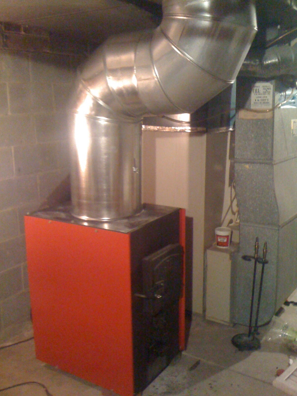

Drew,
Here's your fix ...
Even installed a damper in the ducting, so it can be closed for summer cooling activities ... :rolleyes:
I saw a neighbor's setup like that a few years ago, but the top of woodburner has a inverted V shape, top truncated to enter the ductwork. It really does a nice job of heating, the V top acts as a heat exchanger? It also gives it a chimney effect, pushing air up. If I can get ahold of him, I'll try to get some pics.

   / Good morning!!!! #27,988
Irv,
The top of the actual firebox - which you can't really see in the pic (because it's covered with the 10 gauge plate I added to mount the duct work to) - is in the shape of an inverted "V", although it's fairly flat ... maybe a 2" rise from the outside edges to the "peak" in the center. The red sheet metal panels on the side cover the heating chamber where household air is heated before being ducted into the central heating duct work.
There's a small rectangular air intake (not for the firebox - but for the air to be heated) on the rear of the unit ... maybe a 4" x "8 opening and there's a small (thermostatically-controlled) Dayton squirrel cage blower mounted that intake, that drives air into the space/cavity around the firebox to be heated.
I just adjusted the settings on that thermostat to get it to come on earlier and shutoff later (lower temps in both cases) ... to scavenge as much heat as possible out of the unit.
Personally I think it does a pretty decent job considering it's trying to heat this drafty old place ...
We're heating around 2200 sq ft (upstairs only - I've got all the registers in the basement closed off) ... and we're able to bring the temp up (albeit somewhat slowly) even when it's in the 20's ... it's around 68 or 69 in here right now.
   / Good morning!!!!
#27,989
My neighbor has a pretty small house, not much more than 1200 sq ft. I think the rise on his collector is only 5 or 6 inches, so you aren't too much different. I don't know about a blower, it might be there, but I didn't think to look at it very much. This thread is pretty cool, I have 3 furnaces, 1 at home, 1 rental, and 1 at my wife's shop. I'd like to not have to pay the local repair guy, if I can avoid it.
