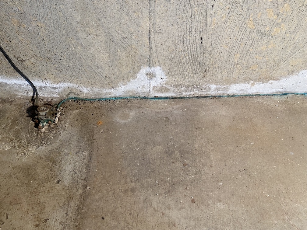

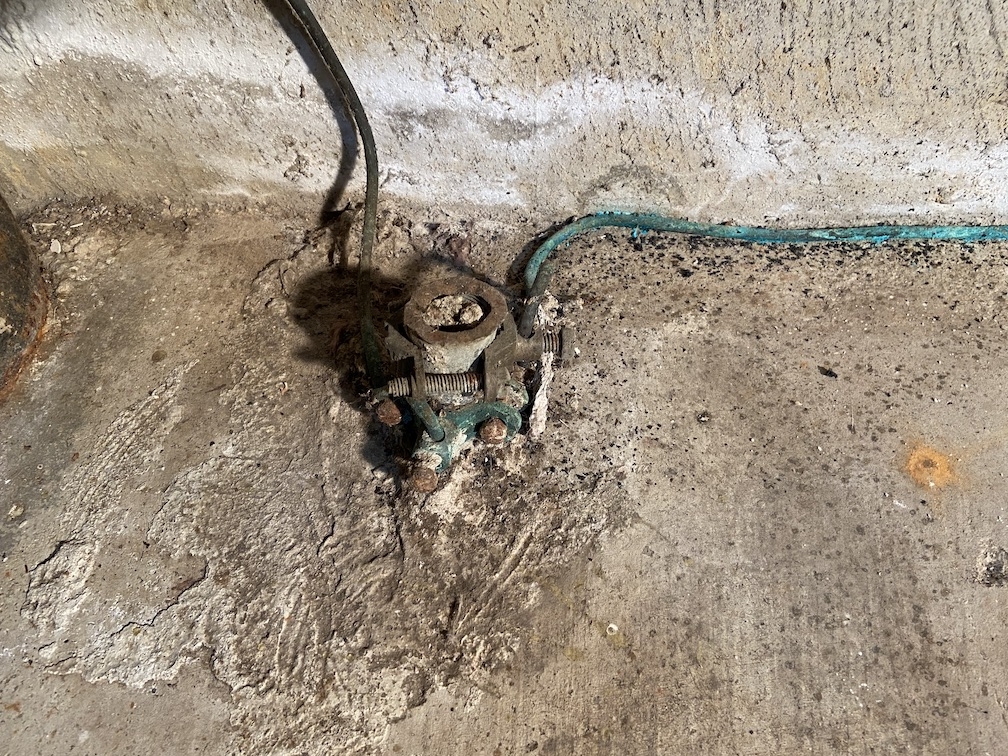

RS, I agree on the new ground wire. Could be a lot of pinholes in that wire covered over by
green grunge. With all the other work you've done, while it's out and exposed,
tell your wife you had 22 consultants and they all said to change out the wire. ;)

Time for a little consultation with the TBN brain trust.
Below is a picture of the (sole/only) ground rod here at the house:
It appears to be a galvanized round pipe, roughly 1" in diameter. It also looks to have been replaced (or maybe just installed after the floor was poured ?) No idea as to it's length ...
The two solid copper wires connect to 1. 200A main breaker panel, and 2. 125A subpanel which fed from No. 1.
So far as I know we are not having any grounding issues, but I have not tested the ground rod to see if it has good ground.
No idea if there is a ground wire connected to the household plumbing at any point (perhaps through one of the circuit breaker panels ?)
There is an issue in the main bathroom with (at least) one light fixture where if you touch the light and grab the faucet at the same time you'll get a fairly nasty shock.
The present location of this rod would place it behind a wall as I finish off the room.
Have read that galvanized ground rods do not last as long as copper and since I think I have several 8' copper-clad ground rods was considering replacing it.
The picture below shows the amount of corrosion that has formed on the copper wire running from the main panel to the ground rod ... likely from the efflorescence from the concrete and being along the floor.
Don't figure that the corrosion is really too much of a problem as the wire should be solid copper, but thinking it can't be good long-term.
Figured the solution for that would just be to get the wire up and off the floor/wall/concrete.
Thoughts ?
With the caveat that I am not an electrician, yes I would get the wire up.
You may have what is known as an Ufer ground (after the engineer who invented it, Herbert Ufer), where the grounds are attached to the rebar in reinforced concrete. It is a much more effective ground than ground rods. I bring this up as a reason why you might not want to get rid of the existing ground system.
IIRC, my recollection is that the ground wire(s) around here need to be visible, as does the ground rod top itself and the connections, so inspectors can verify that the connections are tight, and functioning, but I don't know if being behind an enclosure door counts*. The NEC was updated recently to require two ground rods, or the testing of a single one to a resistance of 25 ohms or less. Bear in mind a new second ground rod needs to be at least 8' away and at least 8' in length, 5/8" in diameter, and be driven so that the UL markings are visible, e.g. right end up. I have known of inspectors who have been known to quibble whether the 8' burial rule means the top needs to be buried or not.
(* Does the UFER Ground require to be visible? says doors are allowed.)
As always, I would check your local codes. My $0.02 would be to replace the wire, and put the ground rod and wires behind a door, as driving a new rod would likely require the enclosure door, and a second rod driven outside, and wired in, or two rods outside, because I suspect driving an 8' rod in your basement might get tricky.
All the best,
Peter

Our ground rod is outside and the wire is about a foot high off the dirt.
