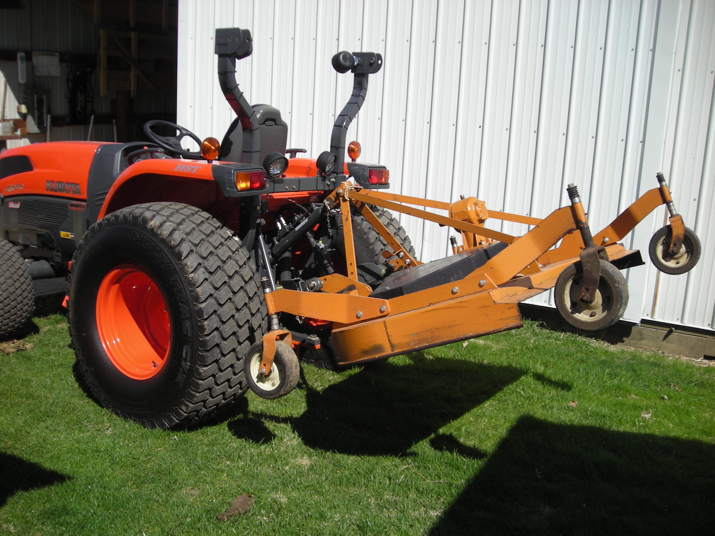

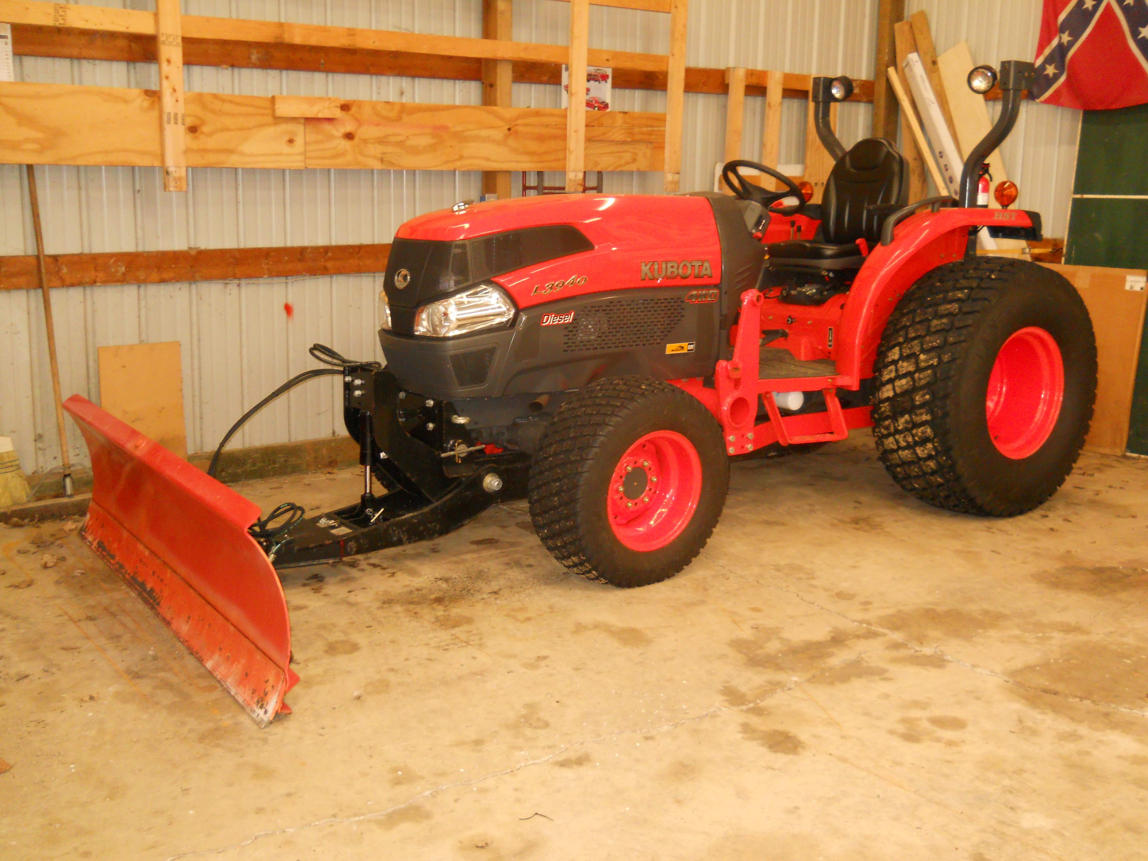

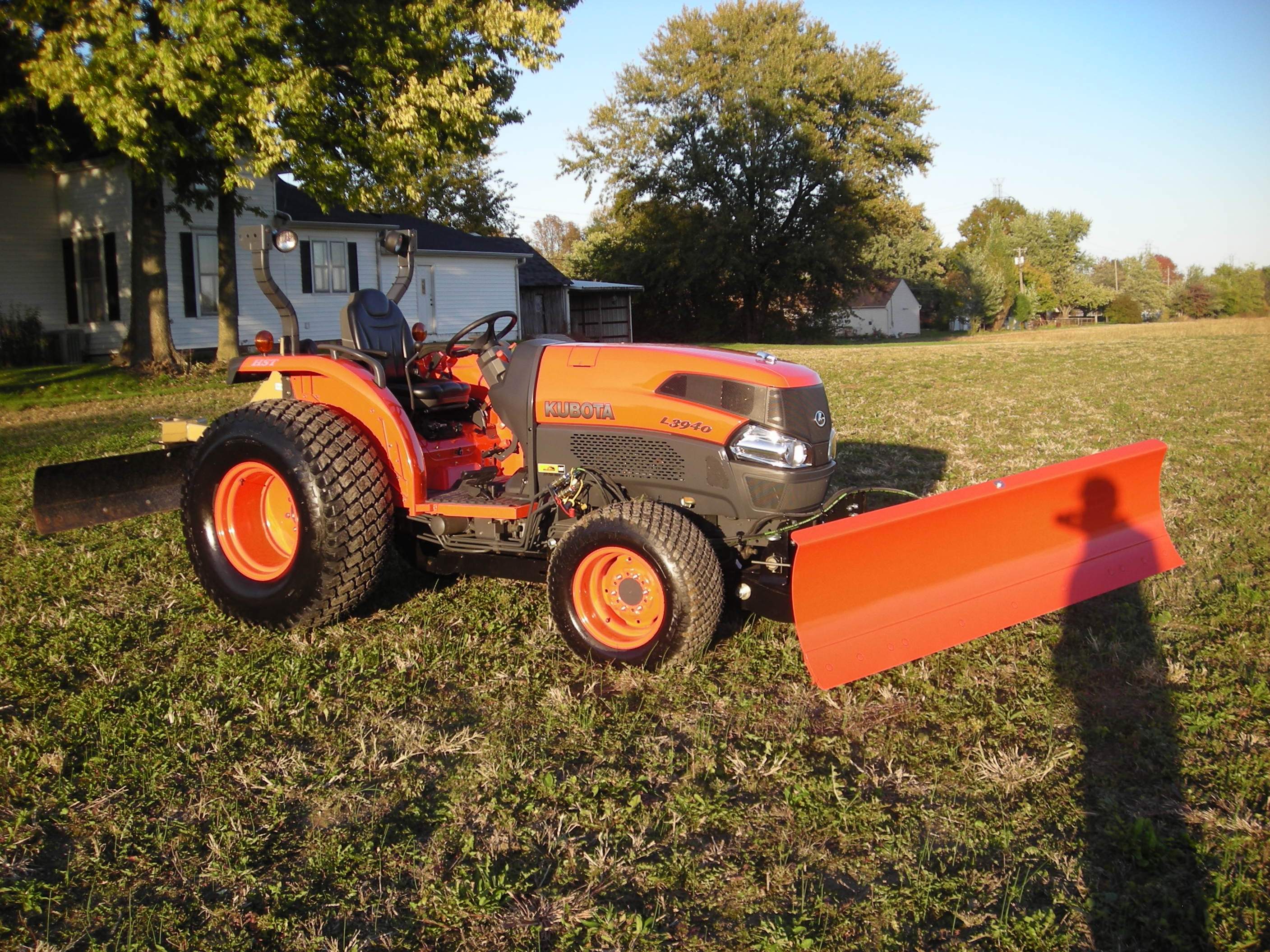

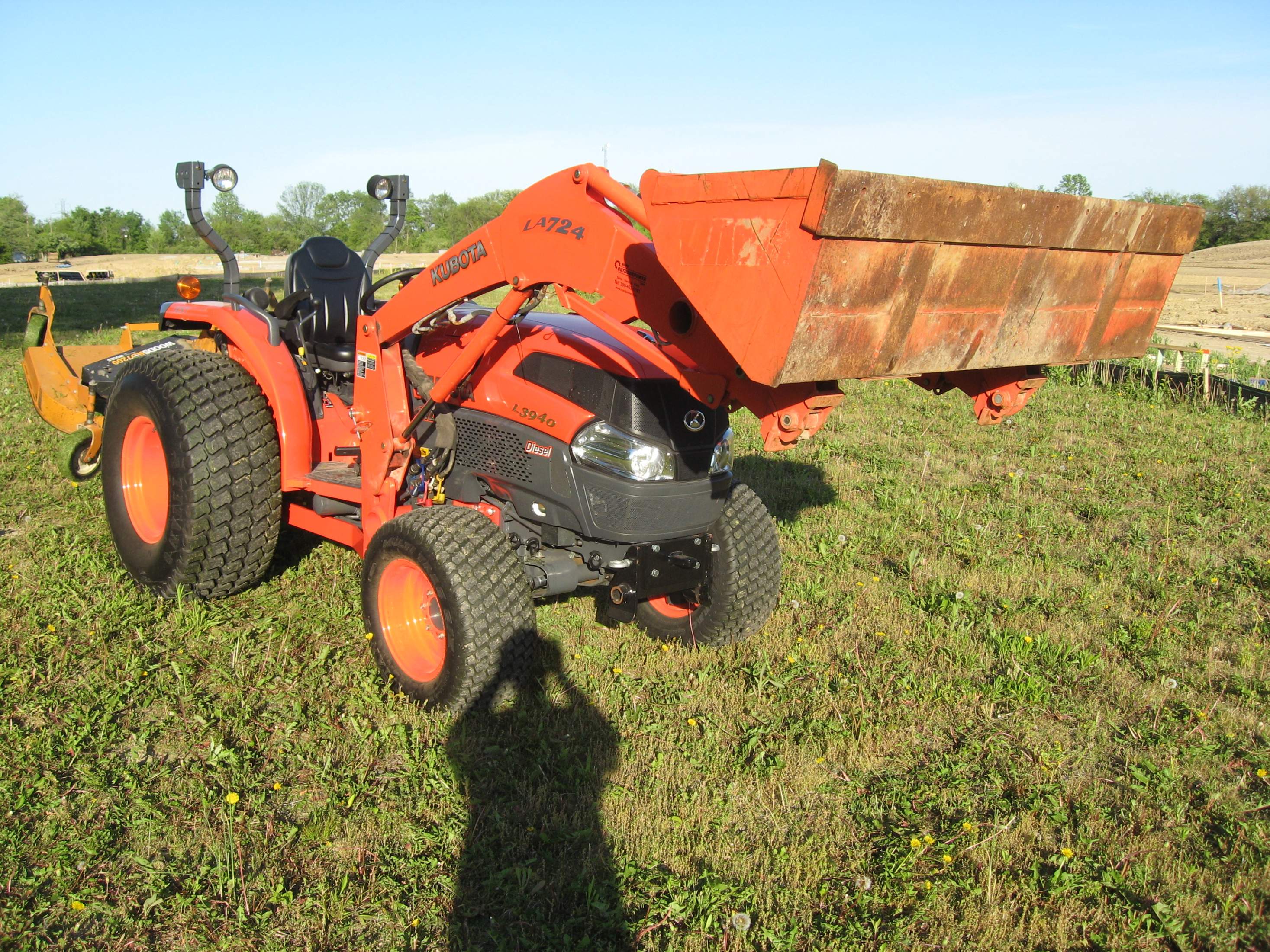

These turfs are superior to R1's and R4's on a black top driveway. They have many bitting edges and sipes in the treads. I now run a ballest box on 3 point, and run in 2WD most of the time clearing snow. The only time I engage 4WD is if we have ice under the snow. I have similar situation in central Indiana, but we may get a little more ice than you. Typical snow falls are 2" to 6", and I clear a 600' long black top driveway. In the summer I am mowing 2.5 acres of grass with a rear discharge finish mower. Good luck with your decision. Philip.
