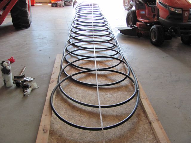

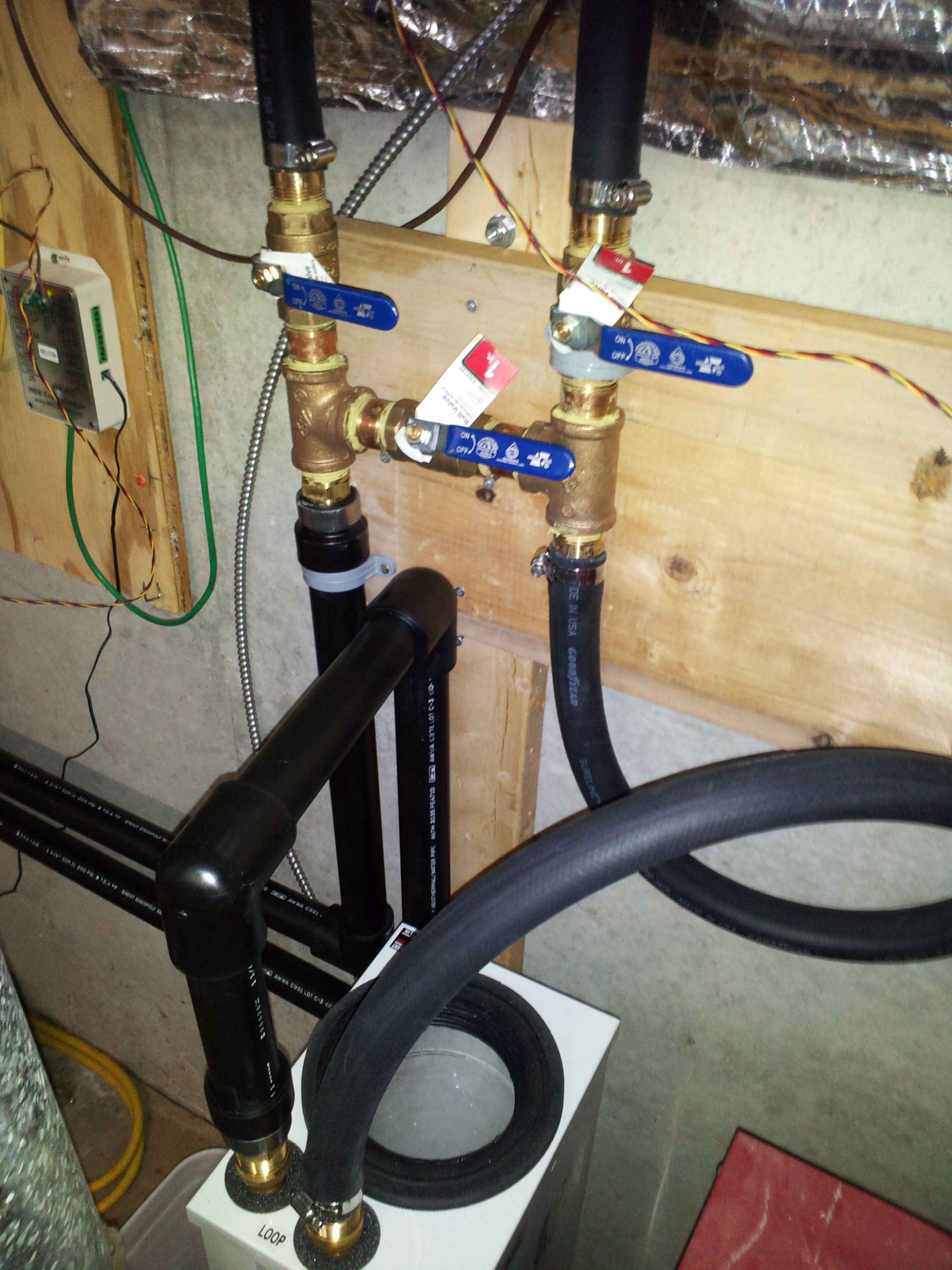

flow pump, with bypass valves. Picture take with pump running and cover off, you can see the water level, and it makes it easy to add the glycol. geopump2.jpg

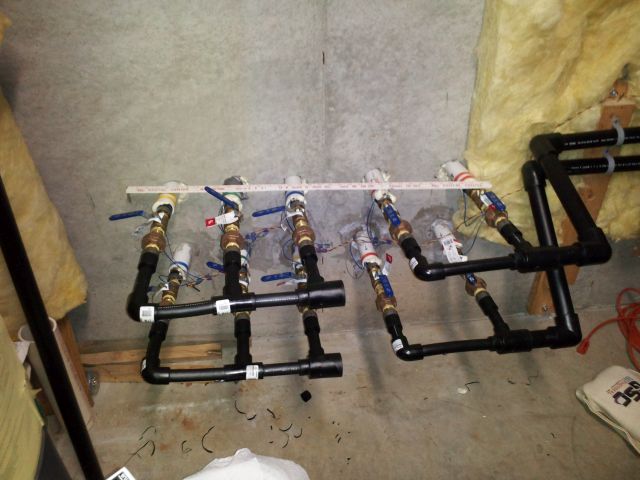

Why did you decide to go with the pressure-less system? Guy I spoke with at terrasouce reccomended a pressurized system, and cautioned using the pressure less system as you cannot use propylene-glycol based fluid as it is too thick, and cannot use methanol based either as an open system allows the alcohol to evaporate and some type of acid to build up. In general, he just advised against them.

glycol is the safest to use, and there are less problems with a non pressure system. I thinks it's easier to do nonpressurize for a DIY. The design software will size the pump for you, based on your loop lengths and type of antifreeze used. Maybe it depends on the equipment terrasource sells? Looking at their web site, looks like they only sell pressurized systems. It's been a few yrs since I took the geo course, so I don't remember all the tradeoffs.
   / geothermal questions and possible DIY
#69
Terrasource actually will sell both. But the guy I spoke with advised against the non-pressure system. Said he would sell me whatever I needed, but would require me to sign a form stating that I understood the possible issues with using the wrong type of antifreeze in a non pressure system, and he wouldnt warranty anything damaged as a result of using the wrong stuff.
   / geothermal questions and possible DIY #70
Glycol is neither better or easier to use. It has a lower specific heat, meaning it can not carry as much heat, and it has relatively high viscosity when cold. This results in bigger, or dual pumps. Ethanol based (Environal or equivalent) is the standard in most colder areas today. Also non pressurized systems can lead to rust and corrosion due to the ready supply of oxygen. Except for open loop (well based) systems I have never seen anyone using an "open" system.
Doing a closed, pressurized system is no issue, even for a DIYer.
