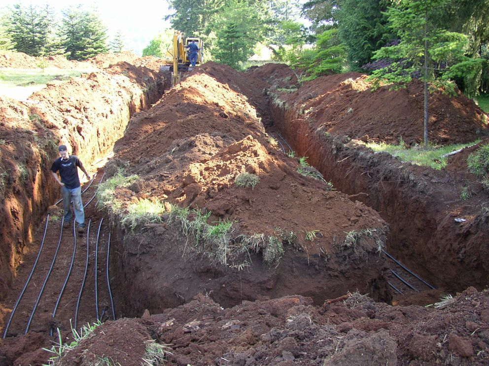

Wanted to post another update:
Got a quote back from the first company. All systems include ductwork install as the house has none.
Bryant 226ANA048 4-ton 16 seer 2-stage heat pump, Bryant FVYCNF005 variable speed fan coil, bryant T6-PRH thermostat, $10,576
Bryant 288BNV048 4-ton 18 seer variable speed evolution heat pump, Bryant FE4ANF005 Evolution fan coil, Bryant evolution control, $12,199
Bryant 280ANV048 4-ton 17.5 seer extreme evolution heat pump, Bryant FE4ANF005 Evolution fan coil, Bryant evolution control, $14,727
Bryant GT048 4-ton 2-stage geothermal heat pump, bryant T6-PRH thermostat, earth loop and excavation $18,435
I wanted a price for me doing the digging. But they didnt feel comfortable with me doing it. Not sure why, Just digging trenches. But got a story about how deep they are and dangers that he would feel better if his guy dug them. Thats fine with me....but you for sure arent getting my business now. I guess if all of them will be that way, it will make my decision on the DIY clear and dry.
Odd thing though, when I had all of the companies out to give an estimate (3 of them), and told them all about doing the excavation, ALL 3 of them told me that was a great Idea to save money since I already own the equipment. Seems a but of a change now:confused2:

Well, I know I can buy a DIY kit for ~$10k. Thats me doing the digging. Ductwork will still need ran, which from the ones I ahve talked to, thats 3000-3500 and something I really dont want to mess with.
So that puts me in at $13000-$13500 for a DIY. I would think a quote in the $15k range with me digging would make me a buyer. This guy was close. Probably would be there if I did the digging and backfilling.

Another update for everyone.
Got another quote back today. I dont remember any of the name brands of equipment, I left the quote up at the new house, but they are as follows:
For a 4-ton air to air, price was ~$8700-ish (dont remember if that was 2-stage or single)
4-ton 2-stage geothermal unit with ME doing the excavation and them doing everything else.....$16,500-ish.
So about 2k cheaper across the board than the other company. The $16.5k is getting close to me just having them do it.
With the ductwork running about $3k, They are still about $13.5k for the geo install whereas a DIY kit is in the 10k range.
Im gonna have some decisions to make when it comes time. Weather the extra $3500 to have them do it or not is the big dilemma right now.
