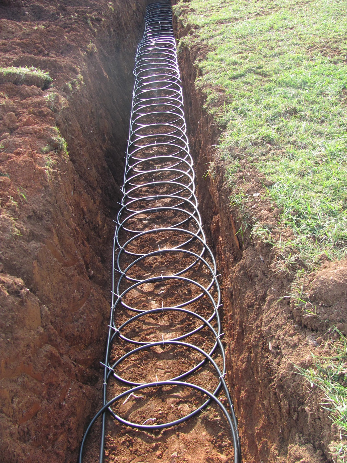

I bought backhoe and did it myself.
Our installer said this was not the ideal way to install. It will warm or cool the ground depending on the season and won't be as efficient as having a separate line in 4 or 5 runs. Ours was installed with a line borer 20' deep with separate lines coming into a manifold. 1 ditch about 12' long for the manifold and line bored to a 3' square hole to run 2 lines into the basement.
Our whole backyard is septic field so the lines run under that. Plus minimal mess.
Jeff
Jeff
The design software will give you the correct amount of pipe required any way you want to configure the loops, in the end slinky’s take up less space, or less digging, but you need the area available. I expect using boring machine to be much more costly, but less tearing up of the yard. All part of the final cost.
I also installed the headers inside, and have valves on each loop, so it can be flushed with the circulation pump, instead of a flow cart. Been in 10 yrs now.
Trenches allow you to backfill around the pipes with good topsoil for the best heat transfer. Soil type also goes into the loop calculations.
