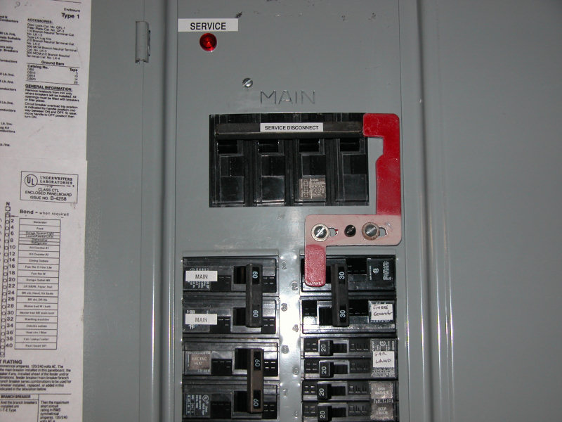

Is there any safety concerns between an interlock kit and a transfer switch with separate panel? The generator company I'm considering buying a generator from frowns on the interlock kit. Says the generator will be sharing the same neutral bond and they won't sell and interlock kit. I'm trying to make an informed decision so I can get the ball rolling on my set up.

Gen. Lee,
I vote for a manual transfer switch. If your talking to a generator company and not home depot, then you are a candidate for a real transfer switch either auto or manual...
When installing a transfer switch the neutral dosn't get switched they are all terminated in the same location.. I install alot of these and don't see the problem with an interlock but do prefer the transfer switch.. Mine is automatic for my wife if i'm not home I want her protected...
