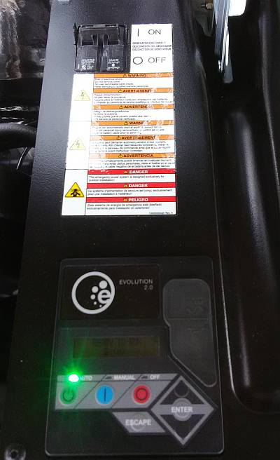

Had a couple of glitches. Went to the activate site and entered everything, but it never gave me a passcode. Got the confirmation email, but no code. Had to call to get that. Once entered, I did an auto start (killed utility power to the ATS) and it fired right up and transferred power. Shut down once I restored utility power.
WiFi won't set up though. Books all seem to say you should be able to so that activation would happen automatically. When I had TS on the phone, they said no, it had to be activated first.
So, now I'm not sure. Books also say a steady green LED indicates the WiFi module is locked up and mine is steady. It was flashing for a while.
I may try that again later, but it isn't necessary for standby operation as far as I can tell.

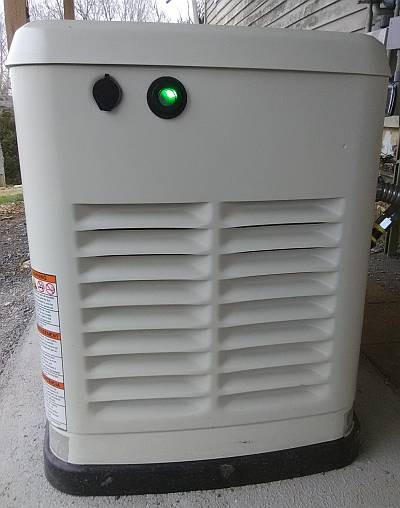

the green light flashes when power is lost and generator is running. it may also flash during exercise or when running manually, but i never pay attention to the led so cant tell you for sure. The led should be solid green if gen is ready to run state. it has nothing to do with wifi status.

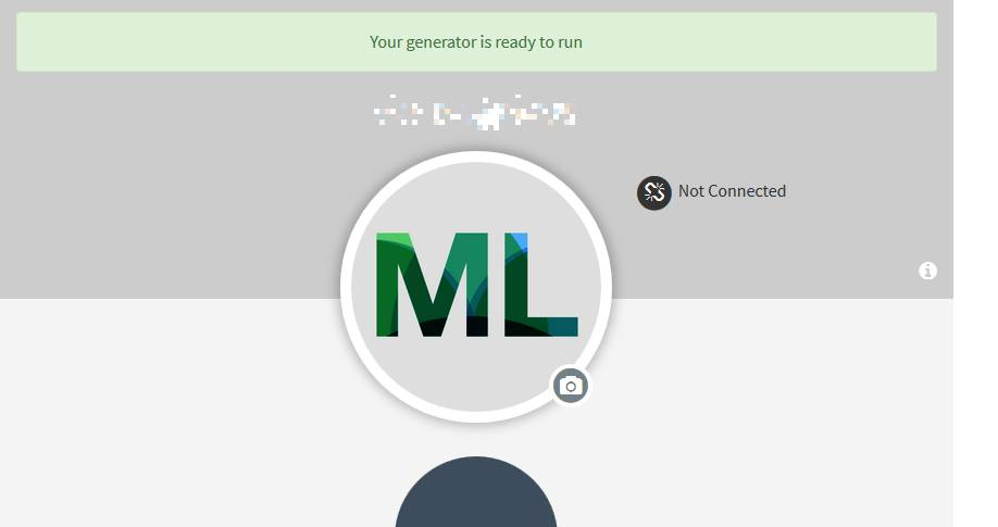

I've been through the steps a few times. I get the right SSID and enter the PW for my router. After a while the controller screen shows connected to my router with the proper SSID listed, then goes to a signal strength meter. For some reason, that only shows about 20% even though the router is about 5' away (through a wall).
But the phone screen with the website never shows a successful connection. It shows 'Trying to connect', then unsuccessful.
The MobileLink site shows 'not connected'.
The LED I'm talking about is in the end of the unit (not the one on the controller). It goes to Red while I'm in setup, then changes to green. But the discussion in the WiFi setup guide doesn't match what I'm seeing.

thats the light im talking about also.
The first app you use should be "mobile link setup" . in this app you link this generator to your wifi in the house. you need to go into setrtings on phone or ipad and pick the MLGxxxx address and connect to it. Then the ap[p will show you possible wifis and you pick one and ask to join with that wifi password. i take it youve gortten this far.
Next step is to go to the website https://www.mobilelinkgen.com/default.aspx?AspxAutoDetectCookieSupport=1 . Click into "Signup". Here you tell mobile link your specific generator. you will see 2 boxes open up, the first one you enter the serial number of the generator. The next one you enter the mac address ( XX:XX:XX:XX:XX:XX: ). After this is entered a 3rd box should populate that allows you to enter the ssid (MLGXXXXX). here you set up your account.
then download the app "Mobilelink for generator" on phone or whatever to access your account.

I've been there. This is the screen I see:
There was something weird about the PlayStore ... it was telling me the ML thing wasn't available for my devices for some reason. But I can get there on a PC.

that is weird. im not sure why it says not connected. you could try calling mobile link tech support. sometimes wait times are long, but they have always solved my issues.
why does it say its ready to run, but not connected. odd.

is your wifi 2.4GZ or 5.2GZ. mobile link cant connect to 5.2GZ units
   / Generator Selection?
#430
2.4
