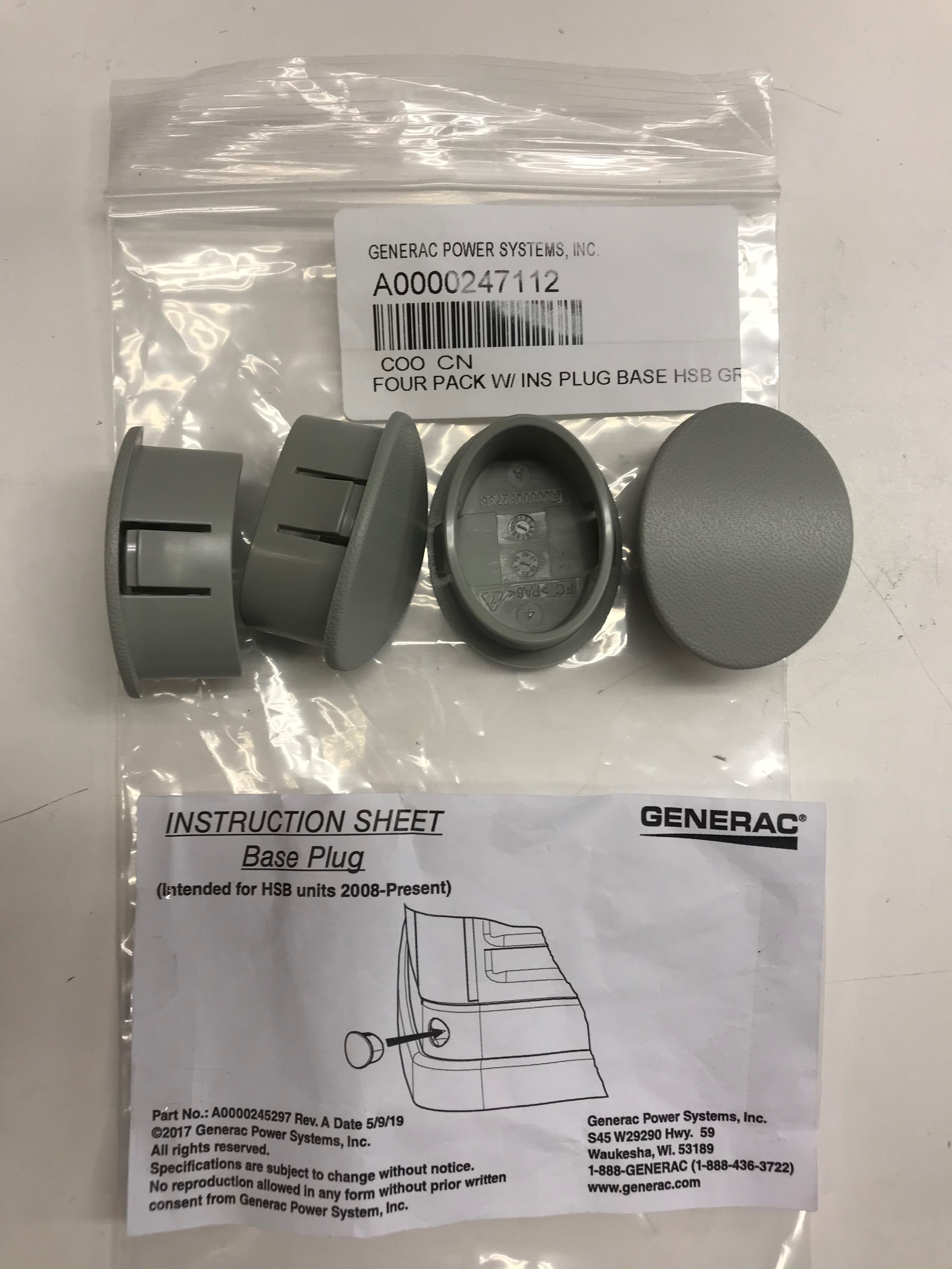

you can also just order 4 oblong plugs for the holes. correct part # A0000247108 for Bisque; A0000247111 for industrial grey (honeywell grey); A0000247112 for standard grey. Base Plugs.jpg

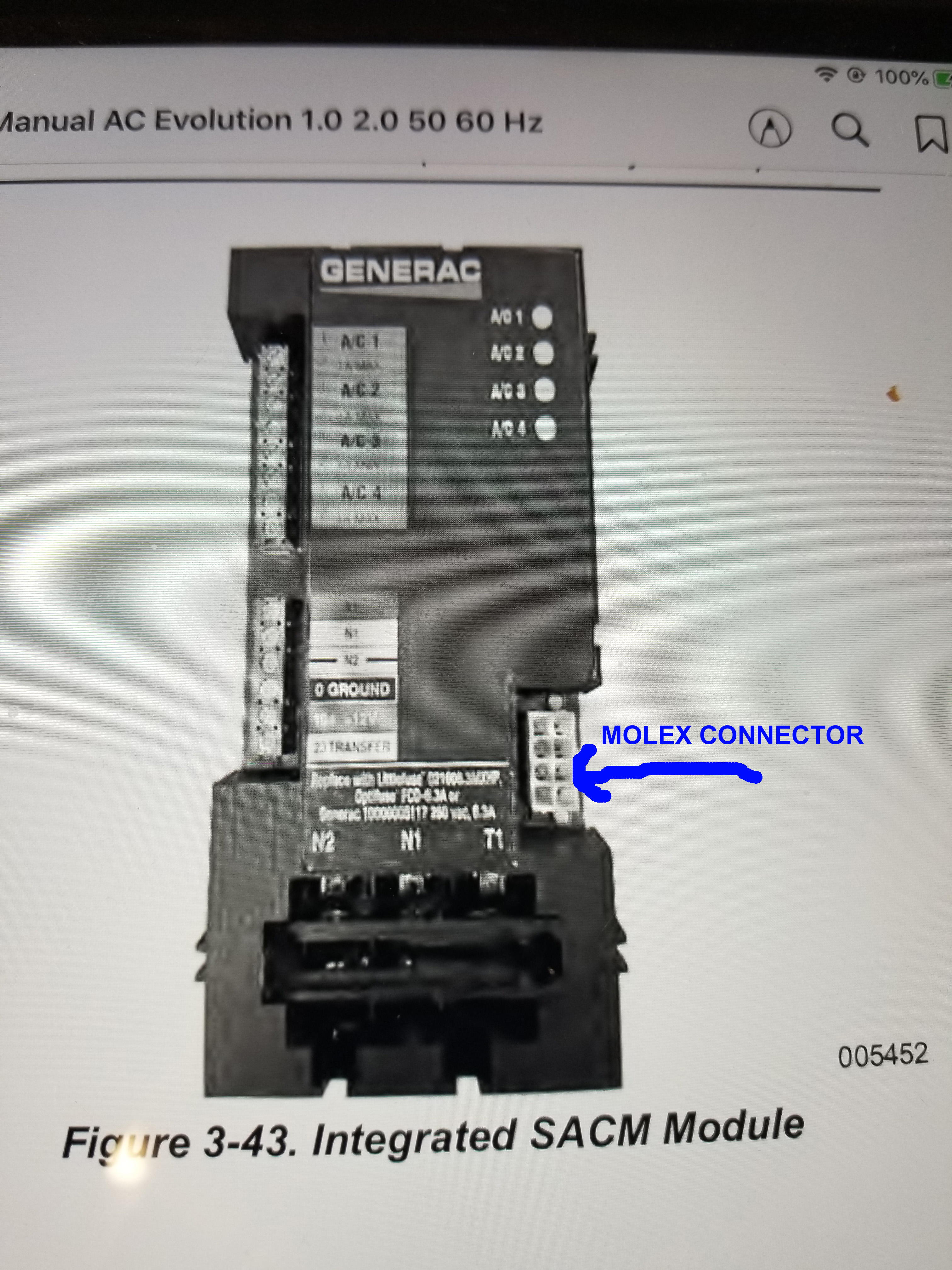

Am I correct in thinking that the N1, N2 and T1 terminals on the controller in the ATS are hot and that I need to turn power off before connecting to them?
/ Generator Selection? #384
they are hot. yes. dont connect the ones in transfer switch until AFTER the generator side is landed. the correct procedure is all power off. generator battery ground unhooked. hook up positive side of battery (so it cant short out). land all 6 generator wires. then land all transfer switch wires. then connect ground on battery. then repower the transfer switch.
now, if you have the newest version of the transfer switch. there is a molex connector on the SACM board. If you simply unplug this you are killing all N1, N2 and T1 power to generator. you wont need to kill house power. MOLEX copy.jpg

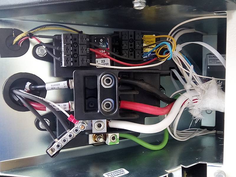

#385
Guess I'm OK then:
attachment.php
Ordered a piece of the cable, probably a week or more for arrival. Not sure when I'll get a battery and don't want to apply power of any kind until I get closer to install/activation. Will have to wait to work out a fuel supply first and that could be a month or more. Guess I could make the connections and leave that Molex unplugged.
