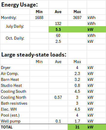

Geez... 2am. I guess I'd better get a few hours sleep, the alarm goes off at 5:50am.
But I did have a moment to tally our loads tonight:
Looks like I need a system capable of delivering at least 132 kWh per day or 5.5 kW average power, with some healthy margin.
My peak usage is likely somewhere near 32 kW with undocumented lighting, depending on how accurate my guess on the pool equipment might be. But in reality, the pool heater usually only runs mornings, when all other loading is minimized. I also guessed at the electric WH draw, I just didn't feel like walking up to the attic to check that tag.
I'll leave sizing up to the pro's, but I'm guessing we have options from < 10 kW genny with big batteries, right up to > 30 kW genny with no storage.

The first company to come out and evaluation the property was talking about a 28 kW generator, the largest air-cooled option from Generac, and then using smart load management modules to just delay start-up of a few of the largest loads.
Personally, I had liked the idea of a 15 kW generator with a big battery bank, as my average draw is only 2.5 to 5.5 kW. But this installer had a few issues with that idea:
1. They don't do batteries, he'd have to look into contracting that part out.
2. He argued the single-cylinder Generacs (15 kW and under) are less reliable than the V-twins, he really likes to stay with their larger models, from experience.
3. He suspected the cost of battery + maintenance is going to be higher than just installing a 32 kW unit with load management.
Batteries are expensive, yes - one time, though you need to counter that with lower generator cost + lower fuel costs (and better power recovery during an outage) + your fuel lasting longer.
No maintenance to speak of; he may be back in the lead acid battery days.

I had really expected to find companies offering hybrid energy solutions, essentially a generator upstream of some large managed battery system. This would allow generator to be sized just a little larger than average daily load, e.g. 10 kW generator for my 5.5 kW daily average in July, and have battery capacity fill in the occasional 30 kW peaks.
But I'm really not finding any local vendors for such a solution, and the little bit of digging I've done on equiopment suppliers is not generating a lot of confidence in ever finding one.
Any suggestions? I think we'd be looking for ~60 kWh of storage with a peak delivery capability greater than 35 kW. System must be able to charge while discharging. I'd pair this with whatever lowest-cost reliable 10 - 15 kWh generator a local installer promotes, for my July peak of 5.5 kW average daily load.
I'd probably also want to install battery outside, knowing full well capacity will be reduced in cold weather. I don't really care, as our cold-weather usage is only half of our hot weather usage, just 2.5 kW average and 60 kWh/day.
I don't really need or want an enormous 30 kW class generator, just to have that capacity available on those few minutes or hours each day when multiple appliances all call for energy at once.
I would have a look at Briggs & Stratton, Enphase, Franklin (aPower 2), and Generac. Generac does offer their Pwrcell battery backup systems. I like, but do not have the Enphase battery system, because of its ability to have partial failures and continuing to operate.
Historically, the battery cost has made the cost/benefit for most customers come out on the "add a mongo generator" page. That is changing, but your goal is not common, yet. The first system that I did like that was '99, and I have been a fan ever since.

Interesting that the prices Google throws up for Generac Power Cell are only $500/kWh on the small units, but $1000/kWh for larger units. Usually economy of scale pushes things the opposite direction, more of something usually costs less per unit.
In any case, based on that alone, I'm re-evaluating my numbers. Clearly, 60 kWh of storage is not a realistic plan. :ROFLMAO:
I think I have some old hourly usage data stored from July 2024. I could integrate that over time and see how much battery I'd really need to keep up with a typical ~15 kW generator. It might be a pretty small number, if we can dig up all of the details on charging rate / efficiency, etc.

Pretty much any Enphase solar installer should be up to speed on batteries. I can't speak to others, but I was 7nder the impression that at the corporate level Generac and Briggs & Stratton were both pushing batteries fairly hard.
That $1k/kWh is exactly the stumbling point for most people. I would comment that seems high to me, but often installers are like that when they have more business than they can support. You know that is.
I would not overlook the power of "soft starts" or VFDs to ramp up the large motor loads in a reasonable manner. A few dollars spent there might reduce the maximum surge current that your system needs to support.
