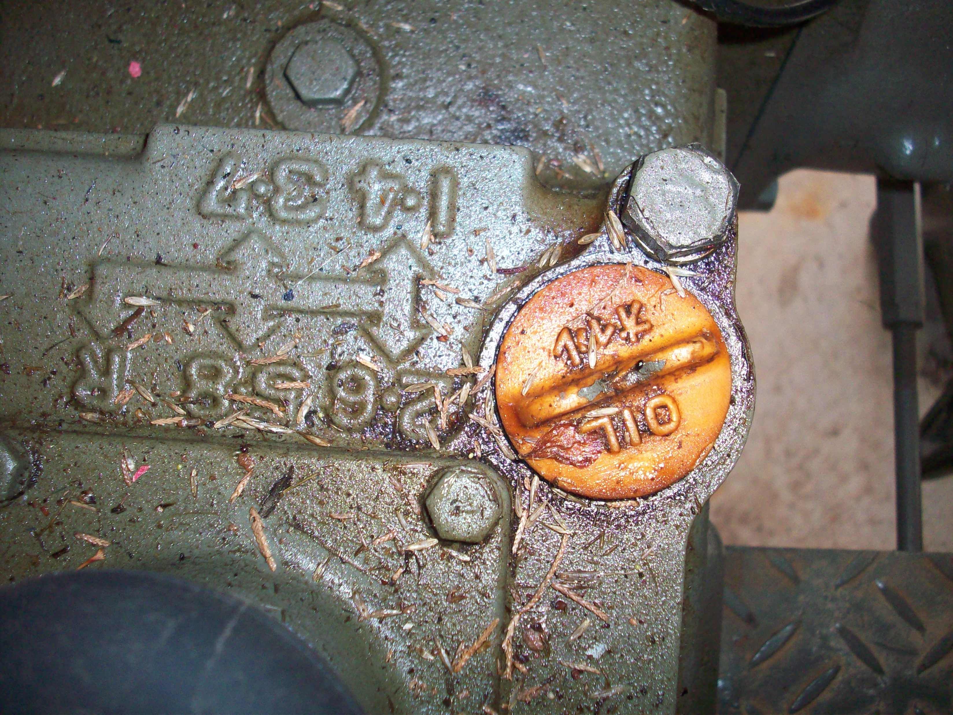

Thank you for your reply. We are not so wellknown with tractors. We have a YM2310 (2wd). We had a leak - I don't know if it's called gearbox, but it's under the seat - we pourred the oil. There is a orange lid with oil written on it. Now we doubt what to apply. Some people say we have to use SAE40 and some 90.
I'm not that familiar with a YM2310, but I can't think of anything under the seat that would have "OIL" written on it. All writing should be in Japanese. A picture would help.
/ gear oil #9
Here is a picture of my cap on my transmission/hydraulic resivoir.

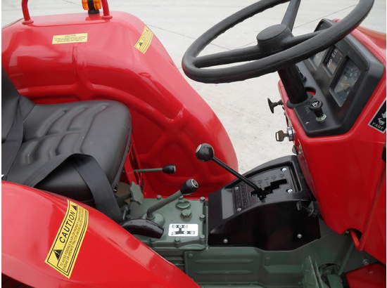

Clemson, the 2310 will have a very different look to it with the powershift. Your shifting pattern indicates a tractor with a manual transmission with a 2 speed range--the YM 2310 has a powershift transmission. The powershift has 2 gear shift levers, one for the range 1-4 (I believe that is true) and the powershift (R--3). I have included a picture of the deck of a 2310.
If yours does not match this picture (courtesy of Fredrick's Tractor--second pic is from a tractor dealer in Lithuania), then look by your left heel when sitting on the tractor and tell us the numbers that you find.

Yea i realize my shift pattern as well as shifter will not look like his. I posted the picture for Norm who said that it should only have japaneese letters on it. That was the only reason i posted a picture, purely for the oil cap. To get it to focus on my auto focus kodak m853 camera i had to pull out to that distance.
Yep, I find that "OIL" thing surprising, (or maybe it says "710". Never noticed on my YM2000B after 10 years. Will have to take a look. BTW, that LO-1,2,3,5, HI-4,6,7,8 is because the top gear in LO range, (5), is a higher ratio than the bottom gear, (4), in Hi range.
