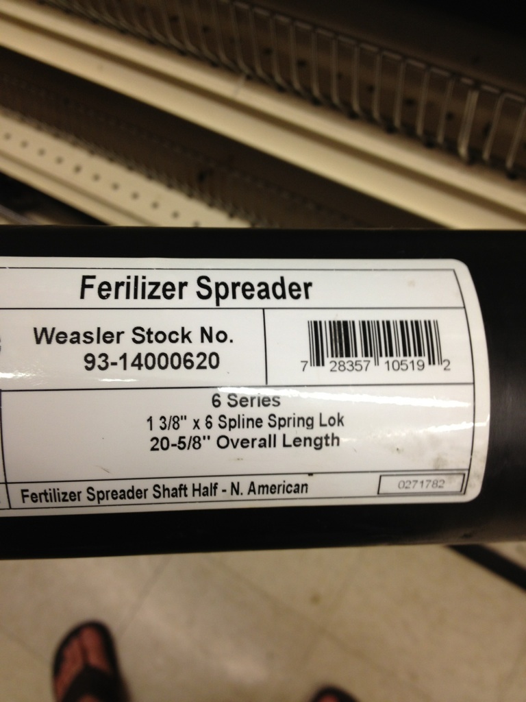

To those looking for a little more cost effective drive shaft option when doing this modification I found one. I stopped in my local tractor supply and found part #93-14000620 made by Weasler. It is a half shaft complete assembly and the same brand of shaft on my factory bagger drive shaft. I purchased this half shalf assembly and cut off 5 1/4" from the shaft and 6 1/4" from the outer tube. I had to do a little minimal grinding to all four sides with a grinding wheel and clean up with a flap disc to get it to slid into the female portion easily of the shaft on the bagger but it works perfectly. I recommend measuring twice before making any cuts and test fitting the bagger to the tractor when taking measurements.
I ended up ordering this assembly from Blain's Farm and Fleet online for $69.99 plus shipping and had it in two days. They sell two versions with the same part number the only difference is the safety tube is either the inner or outer portion. I needed the outer portion of the tube with the decal. I added a pic of the part number on the shaft and can post more if there is an interest.
