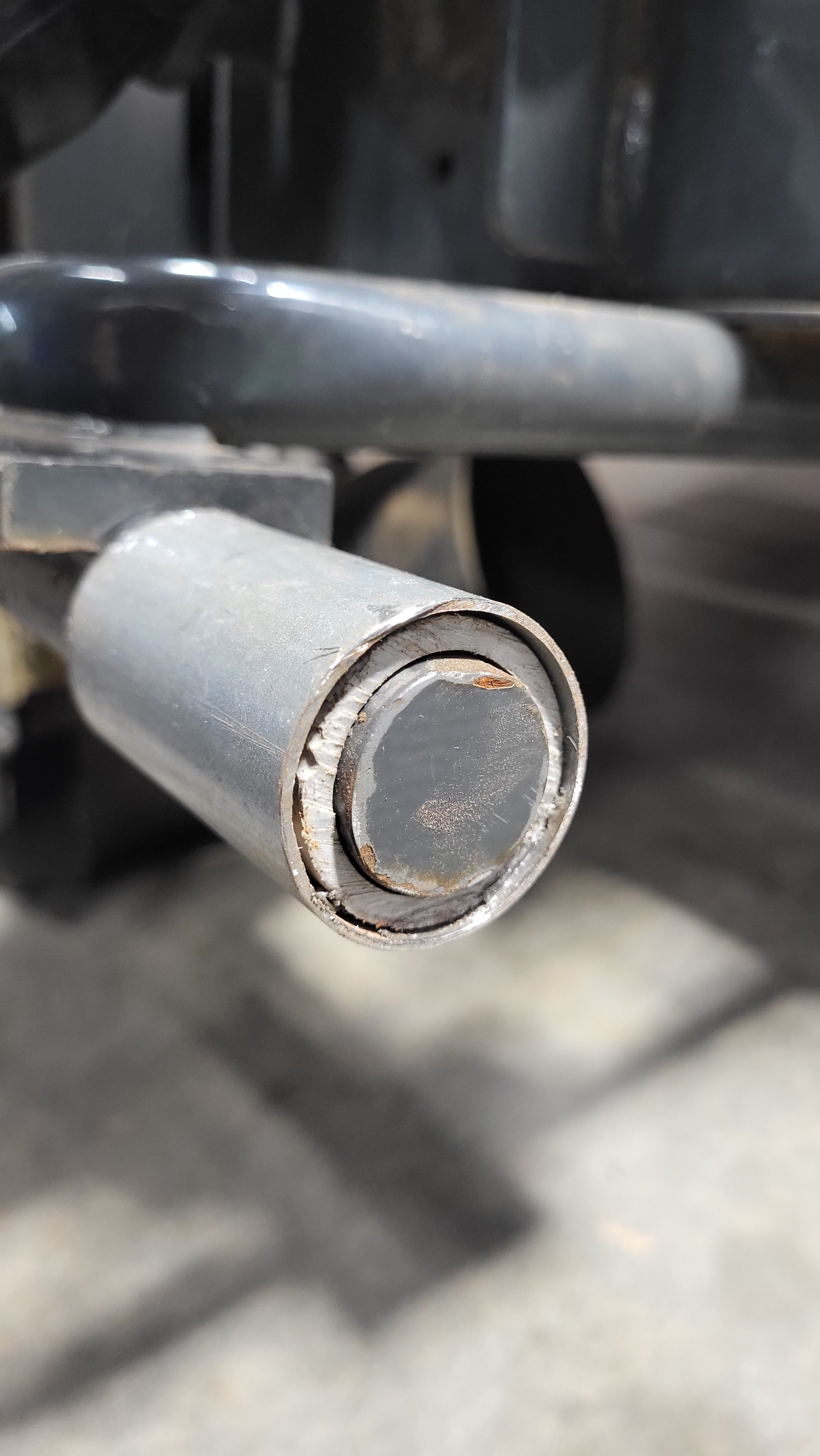

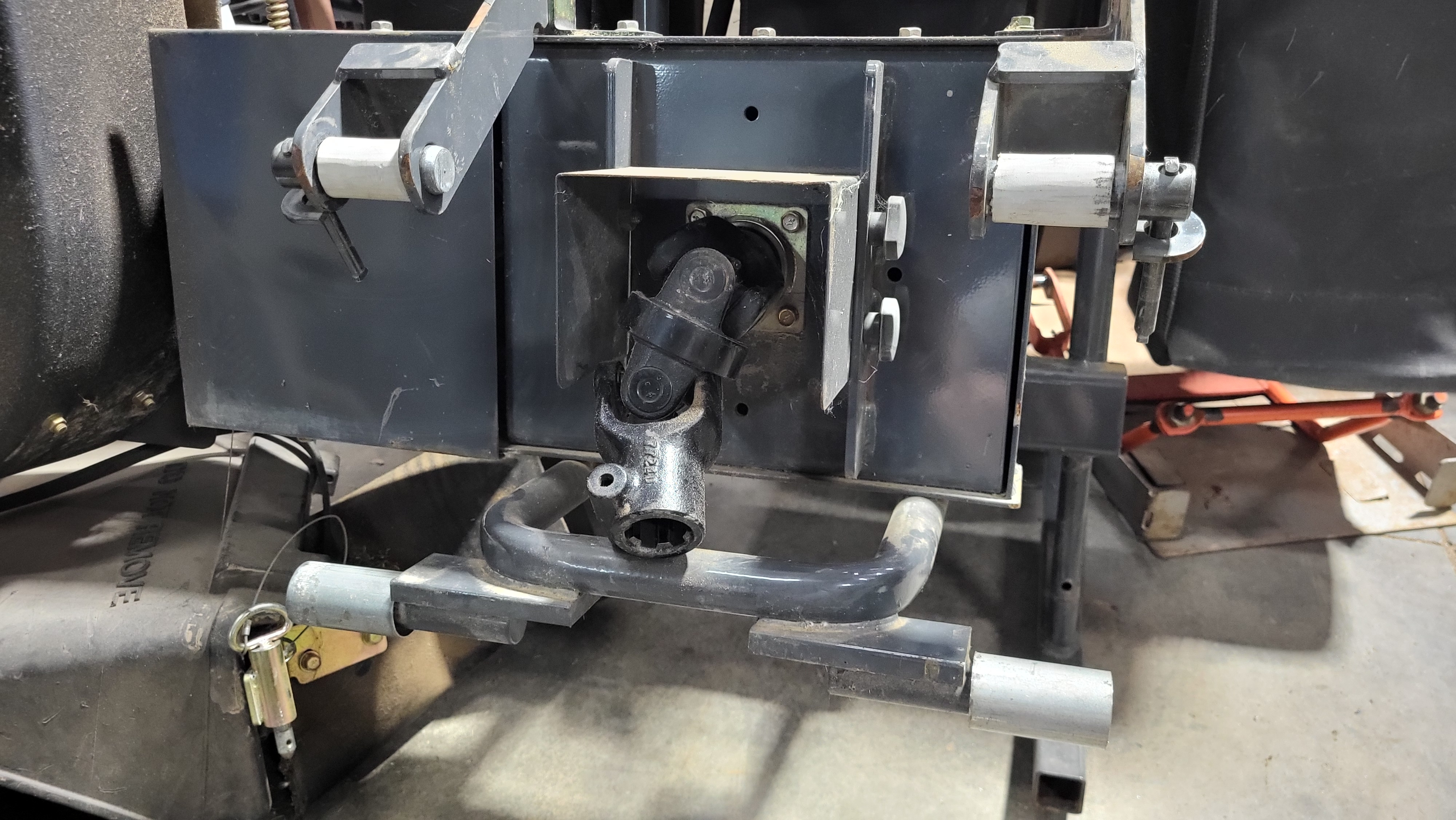

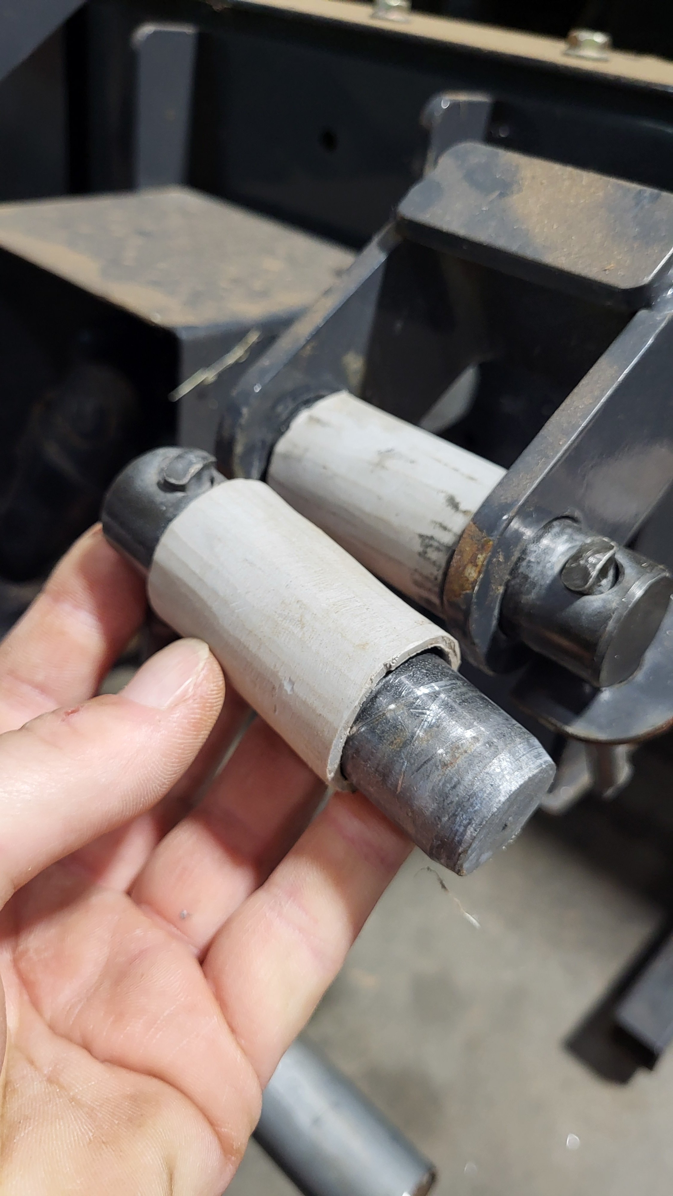

Just in case someone wants to make thier own "bushings" easily for one of the 23BX baggers to fit on a BX25D backhoe mount:
1" schedule 40 rigid PVC ground down slightly works for the top.
Same PVC plus 6 layers of duct tape plus a piece of old galvanized trampoline leg works for the bottom lolol 😁
I almost started looking for a lathe to buy but figured I needed a better excuse than this.... I'll find one eventually.
PS the adapter kit is listed on the Messicks website as of May 2025 but I didn't try to order it.
I'm supposed to pick up the Hustler Bac-Vac this coming weekend, will post some pictures of that project.
