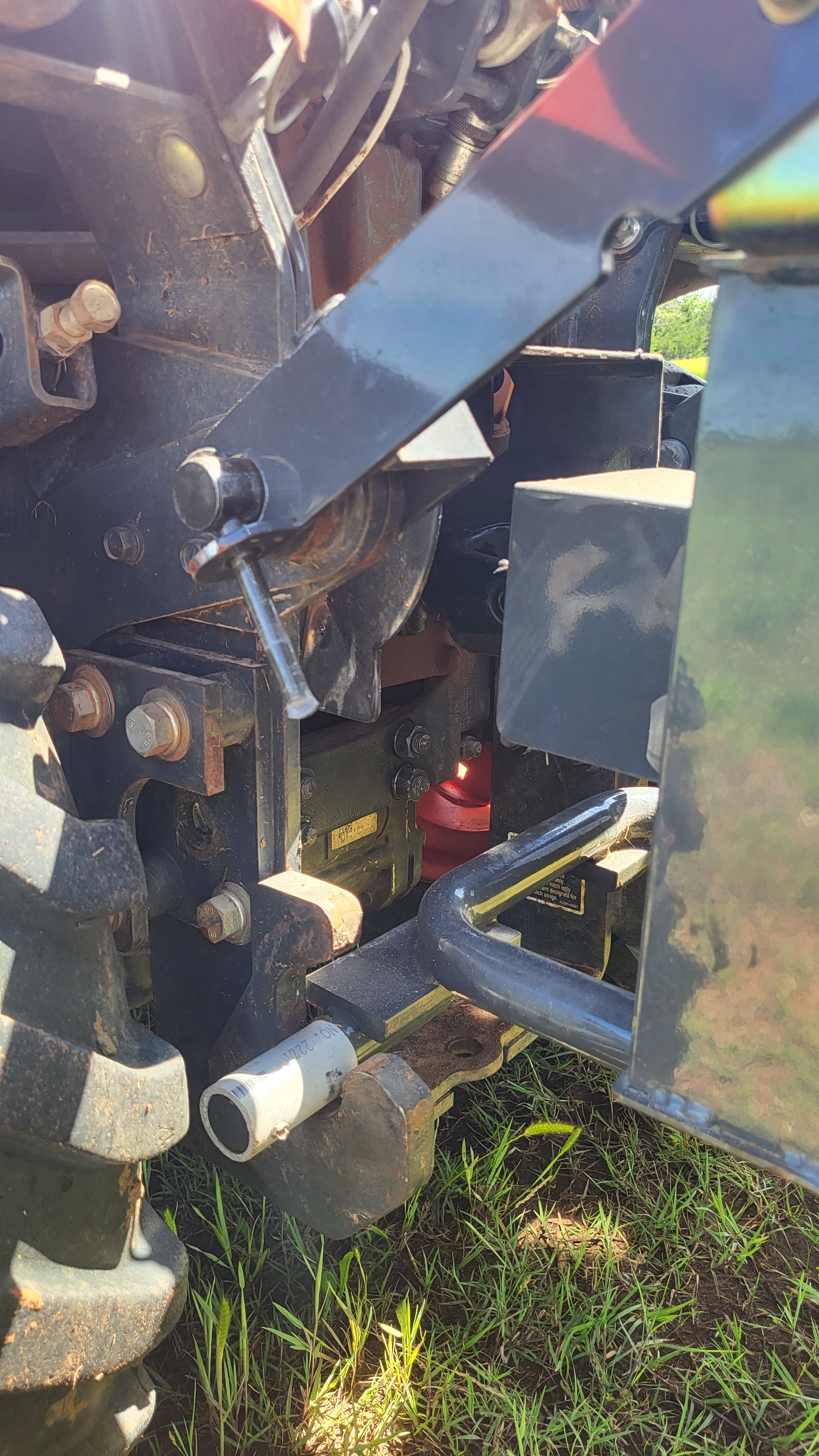

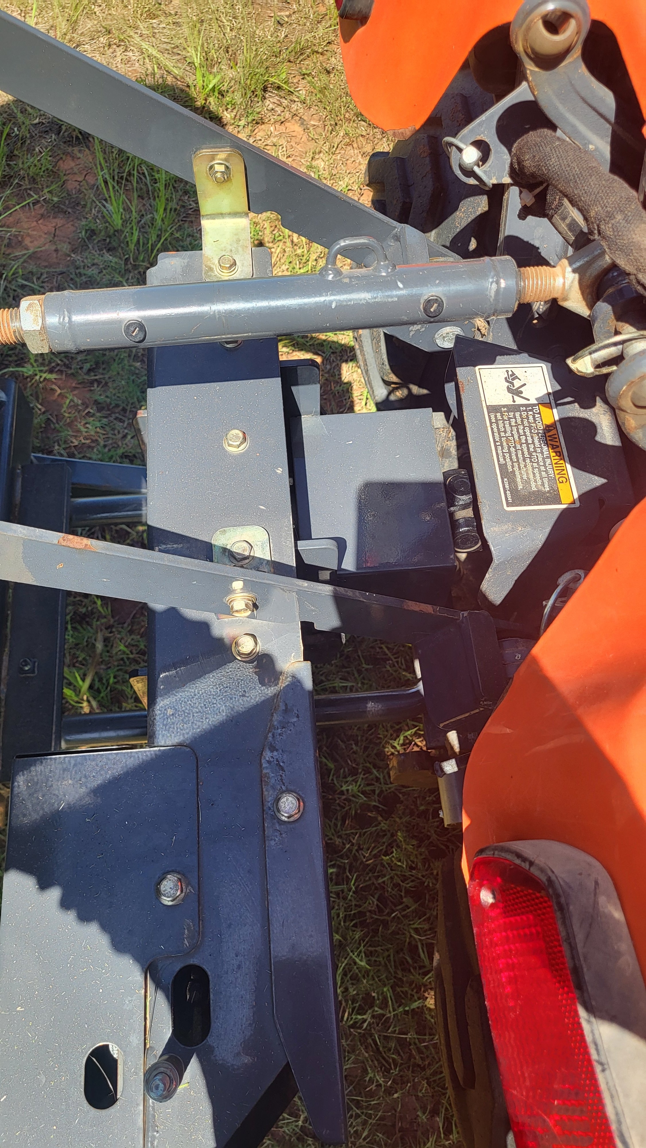

I bought a used GCK60-23BX grass catcher aka bagger for my BX25D. I have now learned that the 23BX means it is frame mounted amd the 26BX model is 3 point mounted. I didn't realize there was an option I assumed it was just a change they made at some point and depending on what year you bought it would be one or the other.
The GCK60-23BX will mount to the backhoe frame with the help of an adapter kit BX3086, but I was able to use some PVC conduit and make my own bushings to get me by until I order the actual kit. If you have a normal BX there are included mounts that bolt to the side of the tractor frame. If anyone wants more detailed pictures I can take them.

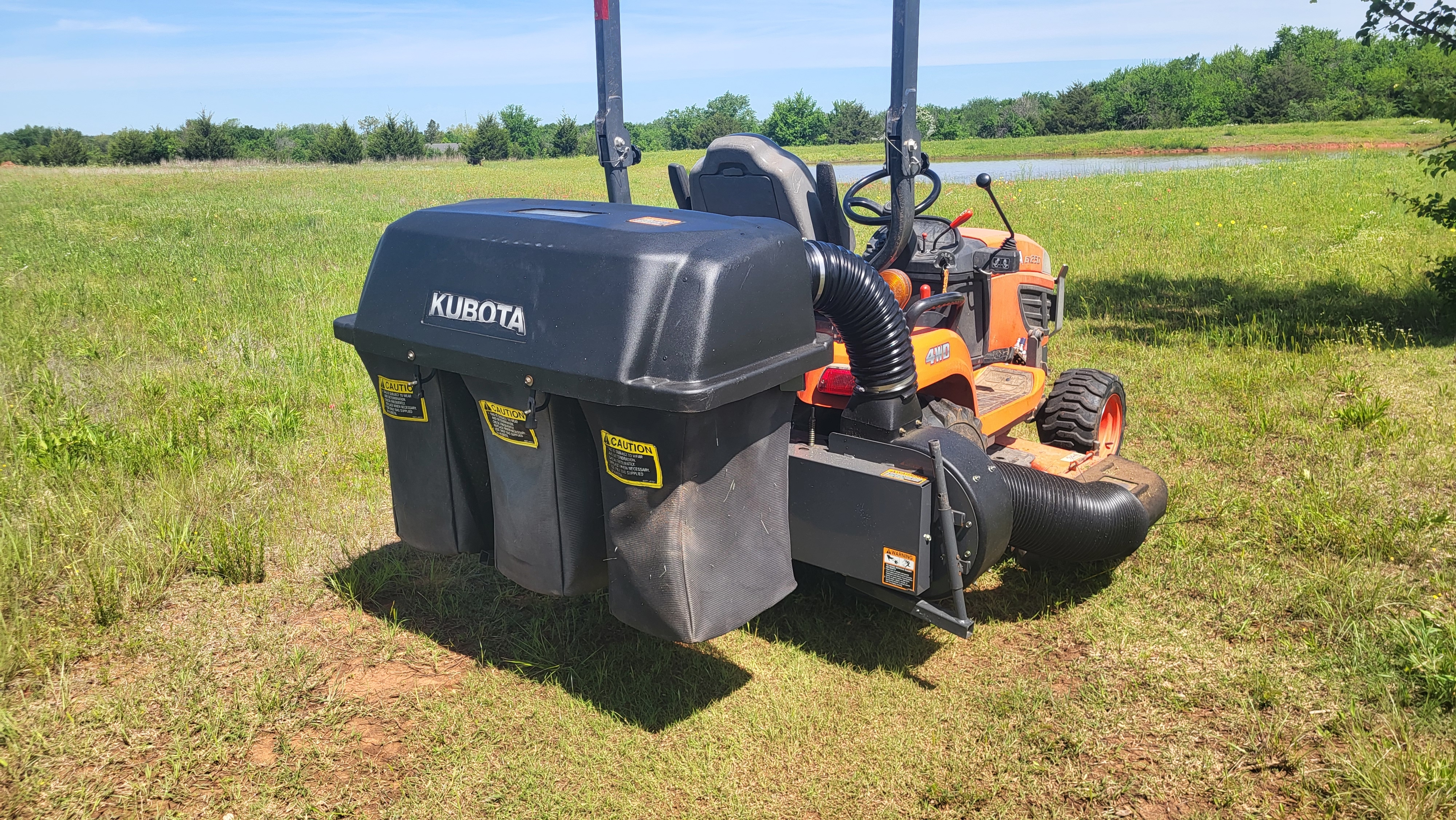

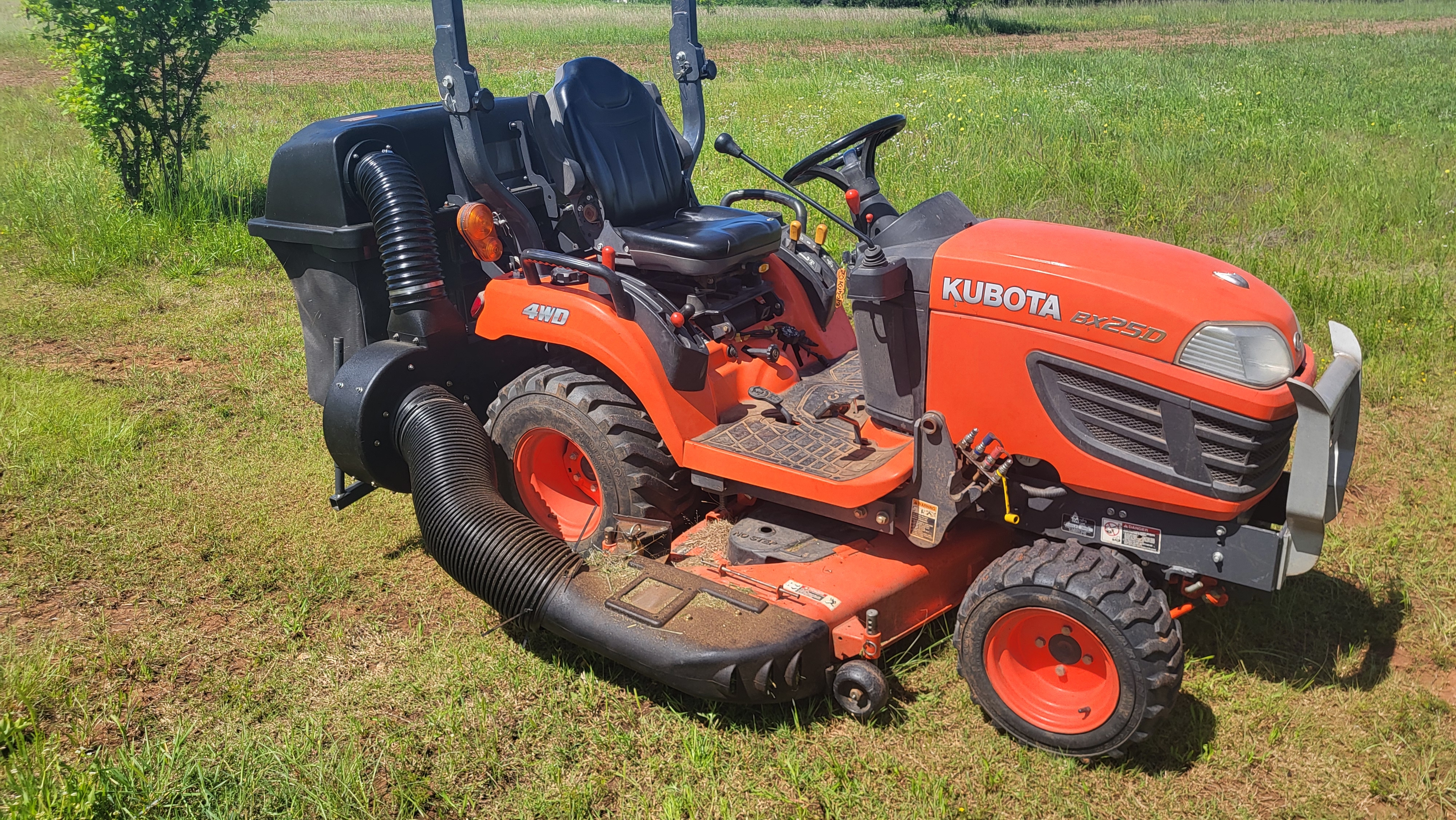

I've only used it enough for two full loads and so far it is great. I have used a cyclone rake for the last 2 or 3 years but I rather have a PTO powered fan vs a separate engine. The Cyclone rake did work very very well and the capacity is very nice. If anyone has questions let me know.

I had a BX22 with the bagger and it mounted to the 3PH... It was a pita.. It did work very well but I always hated taking it off and putting it on. I always thought it should have just had a horizontal bar that sat in the hook area where the BH sat, Then be able to push it forward and slide a pin through the spot where the top link attached to the tractor.

Okay that's good news then, this one connects just like the backhoe but you also connect the top link. It was very akward the first time at least, but is very sturdy and is nice and close to the machine so the weight balance feels fine.

The hydraulic top link would definitely be nice! I used a motorcycle jack and a floor jack in combination to mount mine but it was still quite a dance to line it up, it is nit balanced so trys to fall to the right side the whole time.

How many stands does yours have? Mine had 2, one under the blower and one on the bagger upright closest to the blower.
I moved that one to the further upright from the blower, and it seems to be fairly balanced.
I will say you do have to watch how you move it or else it will end up upside down quick.

Mine has two stands as well, I wasn't real sure where to set them, tried diff positions but ended up just using the jacks. I'll slow down and use a little more patience next time, I was just anxious to try it out!

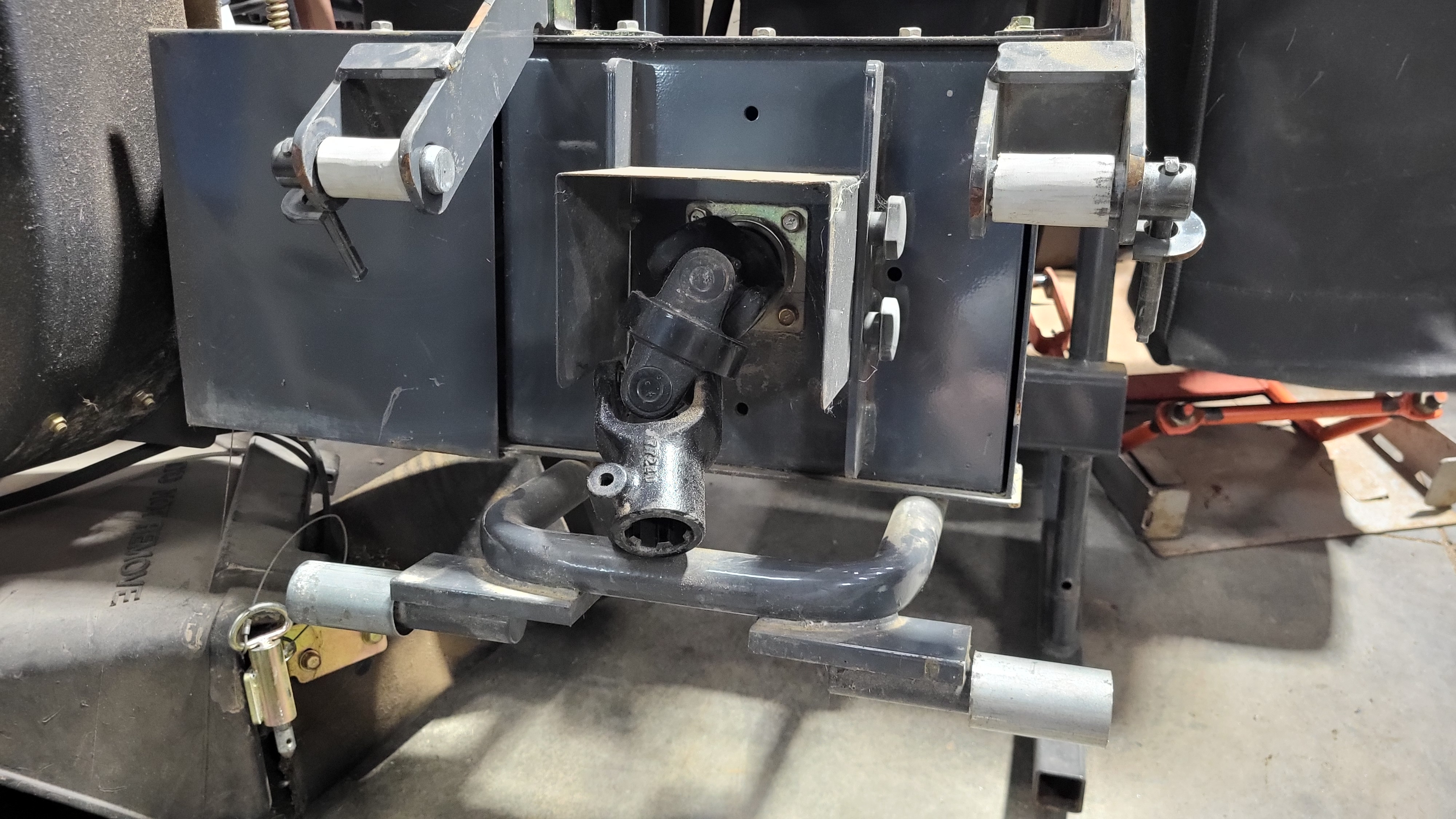

Just in case someone wants to make thier own "bushings" easily for one of the 23BX baggers to fit on a BX25D backhoe mount:
1" schedule 40 rigid PVC ground down slightly works for the top.
Same PVC plus 6 layers of duct tape plus a piece of old galvanized trampoline leg works for the bottom lolol 😁
I almost started looking for a lathe to buy but figured I needed a better excuse than this.... I'll find one eventually.
PS the adapter kit is listed on the Messicks website as of May 2025 but I didn't try to order it.
