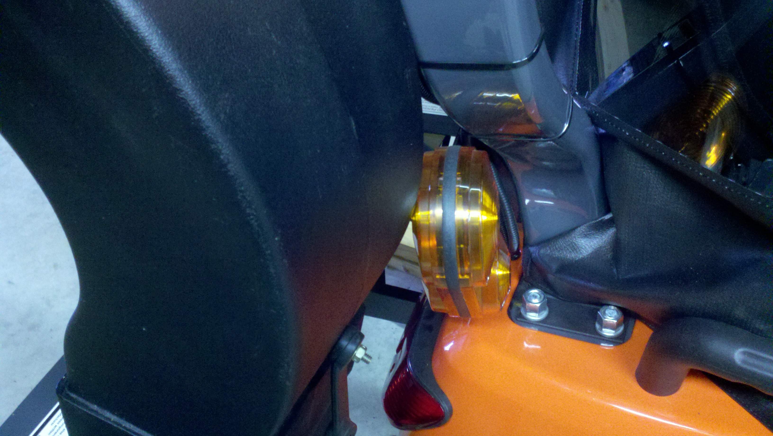

To mount the thing the first time, you will need to rotate your yellow rear mounted turn signals so that the larger round part of the light is down towards the ground and the small one is up. This is exactly the opposite of what Kubota has done when they installed them. The reason for this "adjustment" is because the blower shoot on the right side is so close it will actually hit the light if you don't rotate it 180 degrees. Just losen the nut and turn your light (I turned both so that they match and I honestly think they look better this way). Doing so will allow about 1/4" clearance between the GC shoot & the light once the GC is installed.
/ GCK60-BX Conversion to BX25
Okay this is the last pic I have for tonight. This one shows the little bit of clearance that you will gain if you turn the right yellow light upside down.

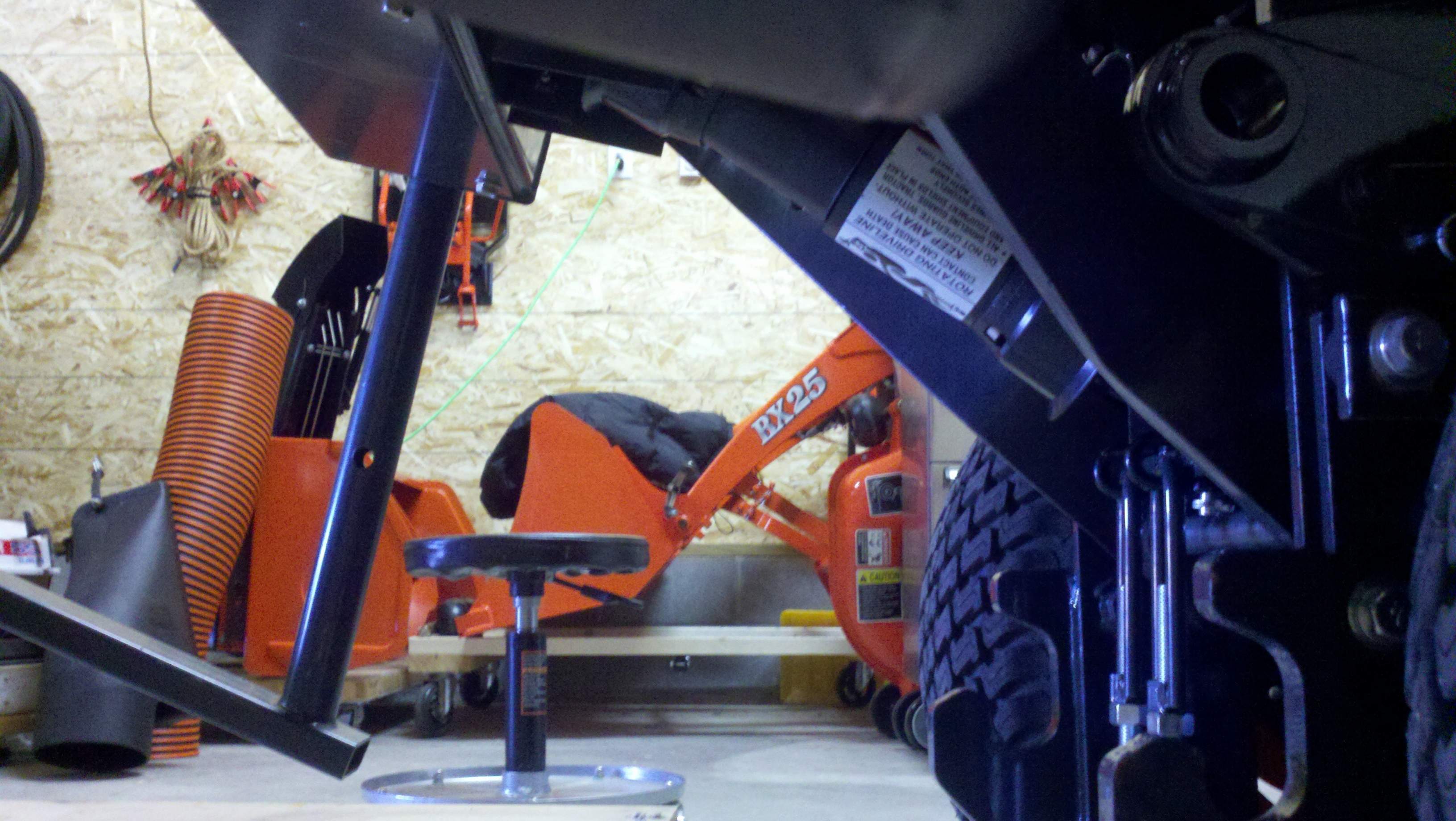

I HIGHLY RECOMMEND NOT INSTALLING THE DRIVE SHAFT AT THAT 45 DEGREE ANGLE. I spent a lot of time today talking with several mechanics who are some to the best in the business and EVERYONE I spoke with advised me NOT to run that drive shaft at the 45 degree angle. It needs to be as straight as possible.
Given the information above in this post this is what I did today to move forward - I don't give up very easily. Having disconnected the drive shaft I jacked up the GC and released the top center link and allowed it to rest on it's two storage legs while still attached to the two lower links/arms of the 3 point hitch. Resting in this position I determined that if I could add/weld exactly 6" of 1.5" tube stock (1/4" wall thickness tube stock) and drill a new hole for mounting that top link then things will align including the drive shaft BUT the original GC drive shaft will end up being too short. I then determined that the drive shaft from my front mounted snow blower is longer, it will actually go inside the other half of the GC's drive shaft, and it is a length that I really think will work. As I had mentioned in a previous post, the rear PTO coupler will need to installed on the end of the snow blower's longer drive shaft to allow the connection to be completed to the PTO & GC.

I started today with 2 drive shafts the original one from the GC GCK60--BX and my front mounted snow blower BX2750 snow blower which is approximately 1.5 inches longer than the original GC drive shaft. Problem was, as I mentioned before, the coupler ends are different. So my intent & reason for visiting with my parts folks today was to find out if the universals for the 2 drive shafts were interchangable. The parts numbers were completely different but they looked to be about the same size & shape. So I went home with the 2 shafts and proceeded to disassemble both universals with the intention of swaping the coupler ends. After hours of delicate manipulation w/o damage to any of the bearings, caps, or lost needles, it became obvious that they are identical. I did the swap and got the GC aligned now so that the drive shaft is 100% straight & level! The cost for this will yet to be determined because when I called down to the parts department to order a new half (drive) shaft for my snow blower they informed me that their computer system was down & I'd have to try back on Monday.
Recapping from everything above that I have done, there really isn't that much to do to make the GCK60-BX fit the BX 24 &/or BX25. The first thing is to weld 6 " of 1.5" tube stock onto the end of the top link of the GC and drill the top link hole for mounting. Some matching Kubota ROPS gray paint finished this modification very nicely and drill that mounting hole prior to doing the welding. The GC 3 point mounting arm can be unbolted from the GC in short order by unbolting the 2 lower mounting pins/bolts, and the four 1/2" bolts on top that afix or secure the top link arm to the GC (actully the 2 on the left side only have to be loosened because the holes are slots and hence the thing just slides out from under them. Next is to get a longer half drive shaft from your Kubota dealer. Both of these part numbers will work the first is 70060-03113 (the one I used) from which is for the older BX23 tractor series when mounting the snow blower. The second part number is for the BX24/BX25 tractor series when mounting the snow blower 70060-02182. Trust me when I say these 2 parts are identical in fit, size, & appearance. Price the 2 items at your local Kubota dealer and take the cheaper one. Once you get it you will need a good vise, some sockets, & a dose of serious patience to disassemble the 2 drive shafts. The c clips for the universal bearings are on the inside so be prepared to get greasy. Just use sockets in your vise to press the thing apart but be careful not to loose any of the needle bearings. Once you press the bearing caps out you will need a pair of visegrips to gently twist the caps to free them completely from the yoke - BE GENTLE BECAUSE YOU WILL BE REUSING THEM WHEN YOU REASSEMBLE THE DRIVE SHAFT. Oh yeah use the longer outter shroud or plastic cover for the new GC half drive shaft, the old shorter one will leave a gap between the two drive shafts when connected and this is dangerous. Use the longer drive shaft protector, it will come with either drive shaft/part number listed above.
When you hook up your GCK60-BX after making the modifications above there is only one way to do it. You MUST position the GC behind the BX and CONNECT THE DRIVE SHAFT FIRST. Next i used a floor jack (here is where the motor cycle jack would be a better option) to raise & tilt the GC forward just a little to align the top pin/link, once aligned insert the pin. I found it best to jack just below the right lower link on the GC which is about the middle of the GC. While the GC is still slightly elevated on the jack (having inserted the top mounting pin), I raised my GC fixed supports and stored them inward as they are designed to do. Now by either raising or lowering the jack in very small incremints I was able to install my lower two 3 point hitch arms on the GC. Once on and secured, I removed the jack, & I then attached my lower linkage and tightened them to level it up..
I've included some pictures to show the new drive shaft position which is now straight & level AND MUCH SAFER!!! There is one final picture that shows the GC on the BX25 - IT CAN BE DONE. Other than the cost of a new half drive shaft for my snow blower (I'm thinking it will be $200) the cost was just a $20 weld job and some paint to the top link of the GC. In the grand scheme of things this was a lot less hassle than having to sell my GCK60-BX only to replace it with a GCK60-23BX AND my solution was much cheaper! The new GC does have a belt driven system versus the solid shaft drive system of the older GCK60-BX which I prefer.
