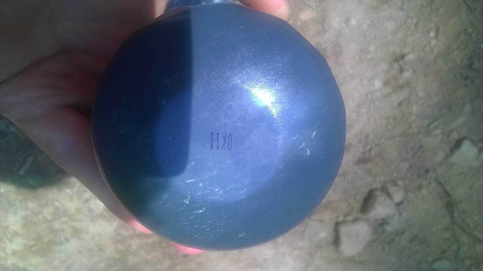

I've always felt the entire tractor was a bit slow/weak, but today the front loader was a huge disappointment. I was trying to do some grading, and the loader just wasn't able to lift much of anything. I couldn't even empty a bucket full of dirt from pushing, which made the whole exercise very frustrating.
It seems to lift relatively fast when the bucket is empty, which would seem to indicate there is not a restriction in the lines (???).
It drives pretty good and pushes dirt pretty hard, so it seems the drive is unaffected (???).
The backhoe has always seemed slow, but I have watched other videos and it doesn't seem out of the ordinary. The hoe does seem a little weak, but with my disappointment in being slow, that didn't seem out of the ordinary either.
The loader doesn't have a fast weep when the bucket is empty or full, which would seem to indicate the cylinder seals are fine (???).
I'm aware of the issue with the short spline shaft, but that seems to affect the drive also, and the drive seems unaffected in this case.
This shows the issue:
http://youtu.be/3cvNxkM77d8 (1:42 long)
This shows other functions that seem to be unaffected:
http://youtu.be/pkOXrtHZvMQ (1:24 long)
Can you guys suggest anything to look at? Thanks!
