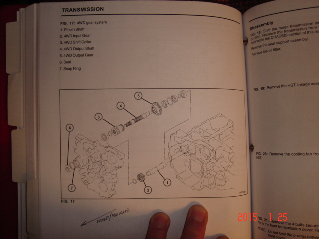

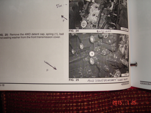

The 4WD control lever is attached to the shaft that goes into the right side of the transmission by a roll pin, and the shaft does rotate when the lever is moved. There's a cap, spring, and ball internally that acts as a detent mechanism, located about 2 inches below where the shaft enters the transmission, but of course that's behind the hydrostatic pedal linkage and mounting plate, so I can't get at it, can't even see it. No detent action at all is discernible, so maybe that's the only problem. (Guess I can hope, right?)
Inside the transmission, there's a gear which slides along the "4WD Output Shaft," but so far I've not been able to locate any drawings or pics of just how that slider gear is moved by the lever & attached shaft. The manual does show a small shift fork, in a similar (?) arrangement for the speed range control, but nothing on the 4WD shaft that I've been able to find so far. By the appearance of that sliding gear in the book, however, it must have a shift fork that moves it (#3 in the manual drawing).
Next step, I guess, is to disconnect the 4WD driveshaft from the 4WD output shaft to determine if it really IS in 4WD or not, and then to see if moving the lever has any effect on it.

Here's a better pic of that 4WD gear; judging by the collar on it, there must be a shift fork in there to move it.

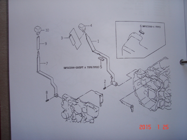

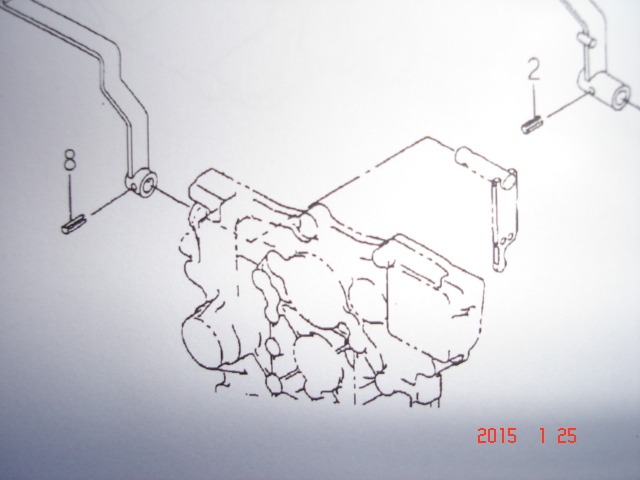

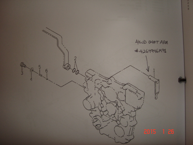

I finally found it!
On page 100 of the parts book, there's a drawing of the shift levers for both the 4WD and the 3PH. Attached to their shafts, just inside the transmission front cover (the 4WD shaft is actually IN the front cover), are short levers which apparently bear on the shift collars.
Right now, I'm betting that 4WD lever was tack-welded on and has broken free, since I can see the shaft rotate when the control lever is moved between 2WD and 4WD. Ugh.

Found more on page 96 of the parts book. Sure enough, that lever is mentioned as a separate part.

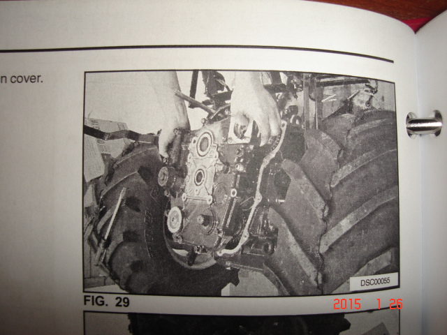

Contacted current dealer (about 1.5 hrs away); estimate is 12 hrs, over $1K just for labor. Ouch. I was really thinking I could do it myself, IF the transmission front cover could be removed without separating the transmission, essentially the whole back end of the tractor, form the front end. The front end would include the forward frame section(s) and the engine.
Thought it was possible, until I looked more closely at the pic in the book of the tech removing the front cover; notice that screwdriver on the rear tire? Yep, that photo has been rotated. The rear section is separated, and the whole thing tipped up so he's actually LIFTING the front cover off, not pulling it horizontally.
OK, so what? Well, it seems, according to the service manual, once that front cover is off, all the gears/shafts inside simply lift out of their sockets with their bearings attached, if you need to get at them. What that also means, I think, is if I try to do it with the transmission horizontal (in its normal orientation), some or all of those gears are going to just fall out & drop to the floor, since they're only held in place between the matching bearing sockets cast into the front cover and the transmission housing. Not good. And if that happens, how am I going to get them all back in, and held in correct alignment, while I put the front cover back on? (Ever take a clock apart?)
No, it looks like gravity is definitely needed here to hold things in place, which means the whole tractor has to be disassembled and the transmission rotated so the front cover is UP. Not sure I want to get into it that far, but I'll continue to think about it. Bummer. Guess it all depends on how tightly those gear bearings fit into their sockets, but according to the pics in the manual, they look to be very easy to just lift out. :mad:
