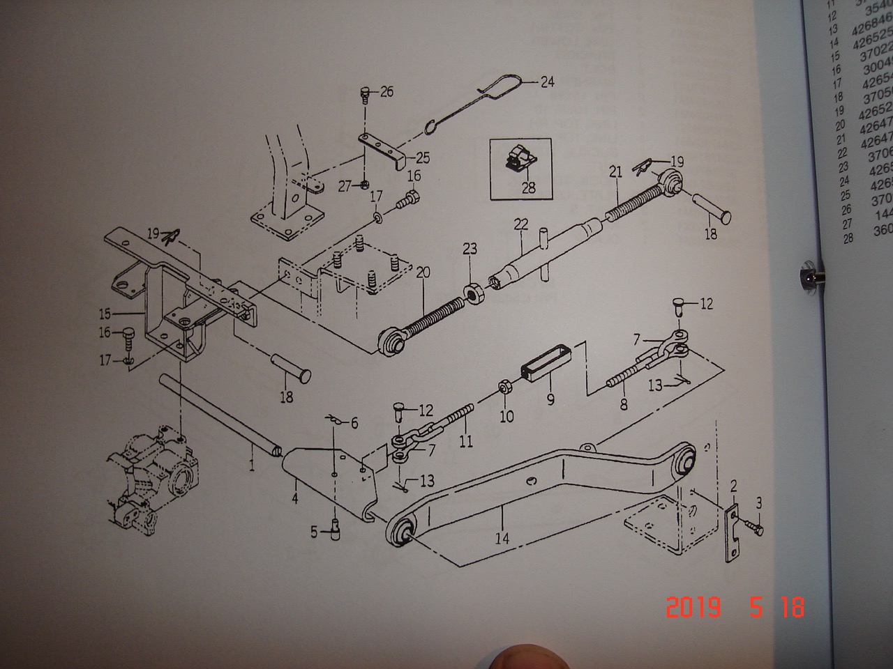

Need some help, please. I am a dope and lost part of the right lift rod for my 3pt Hitch on my GC2310.
The lower threaded part is what I am missing.
Does anyone know the part #?
/ GC2310 3pt Hitch Part # #3

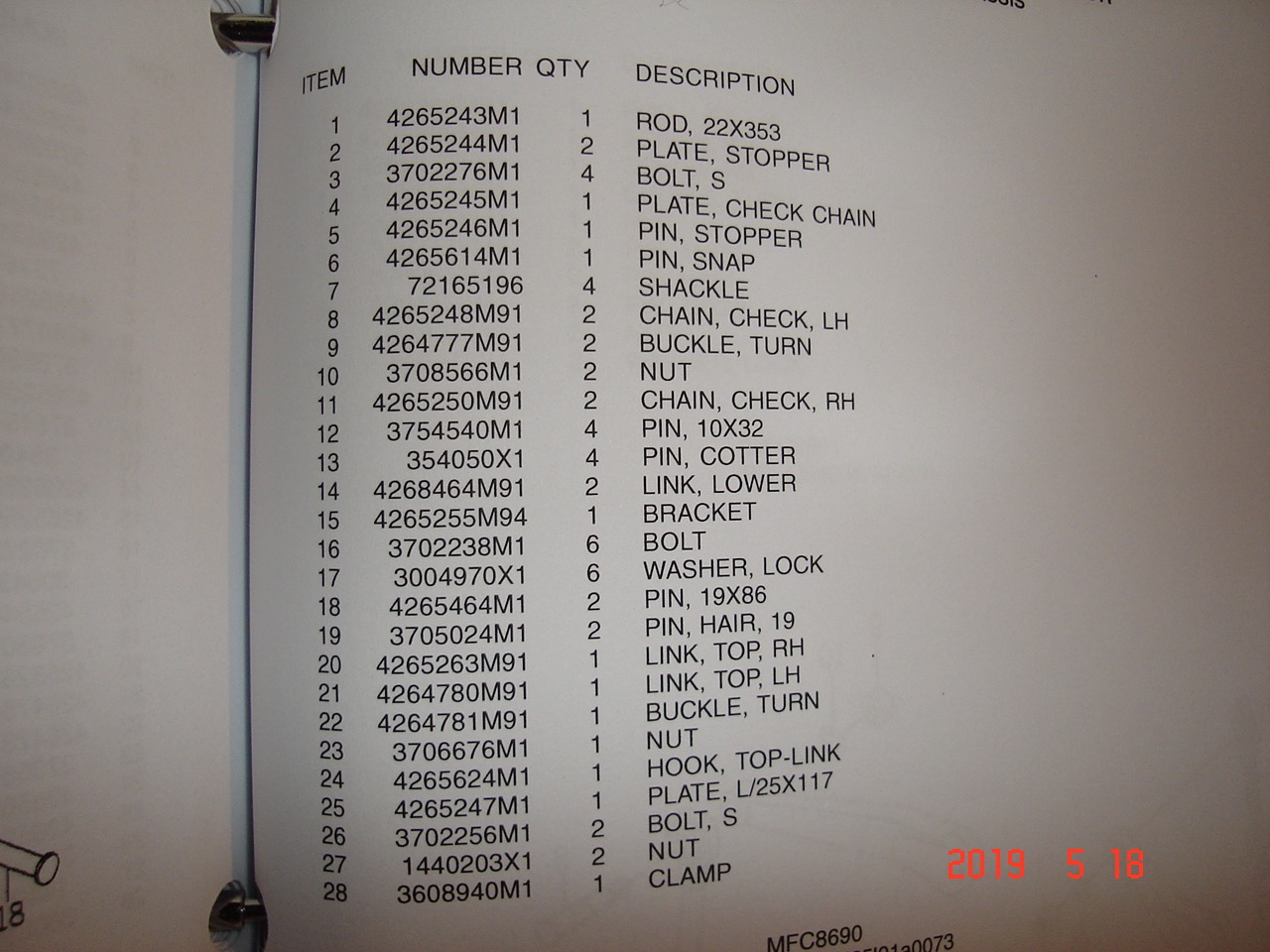

Ah, there you are! Here are pics from the parts book! As mentioned, it's listed under "Link System" on page 154. Which part is it you need?
Thank you - 21 I believe. Except i thought it was a forked end and not the eyebolt
