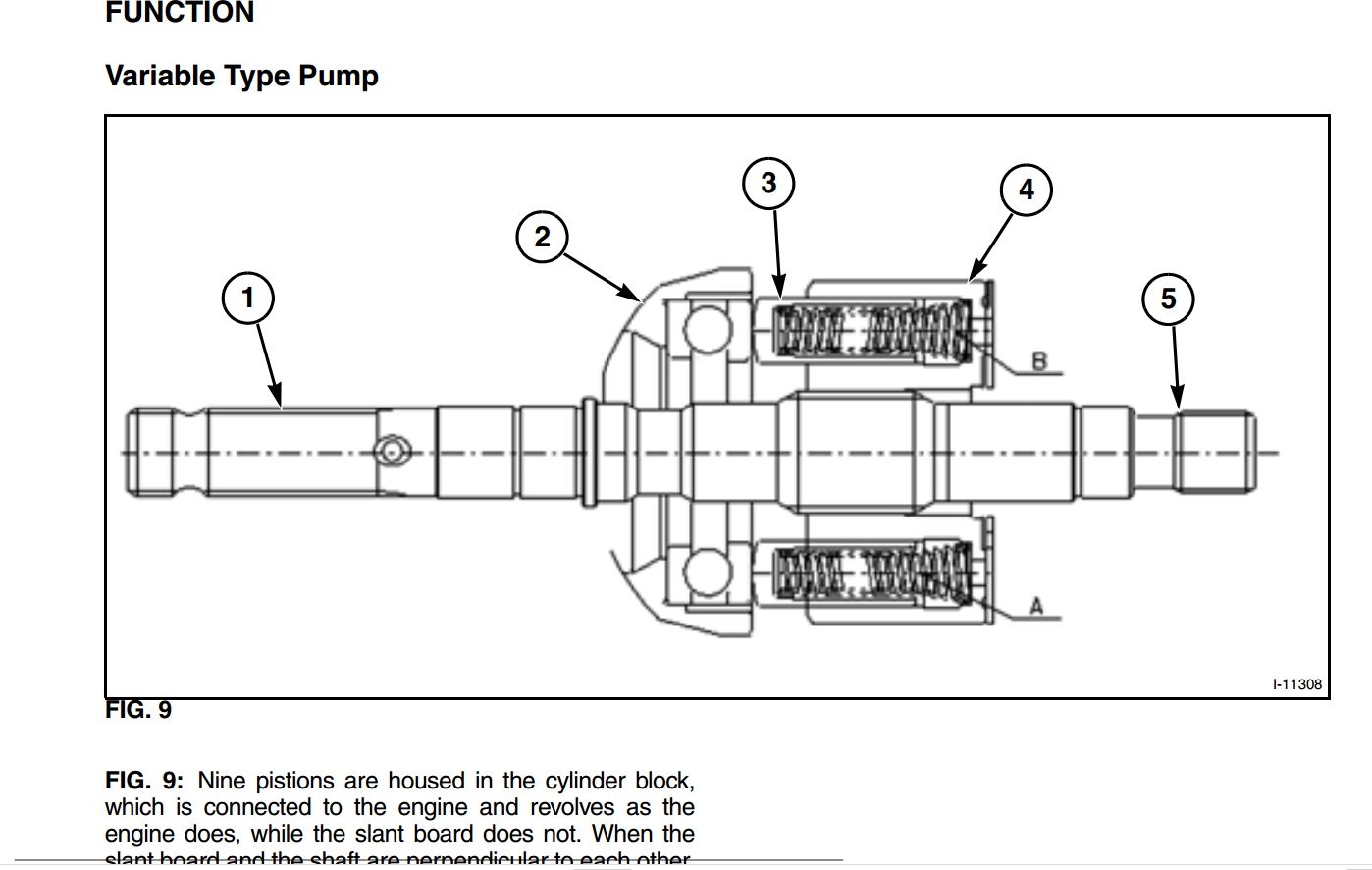

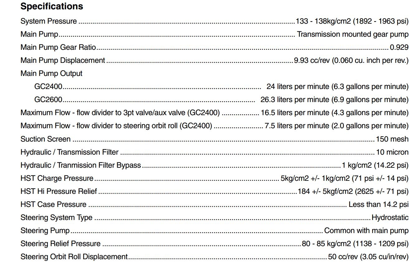

There are two hydraulic pumps.
If I am remembering it correctly, there is an internal pump is for the drive train, and the external pump operates everything else.
/ GC2300 hydrostatic issue #18
on my gc2400 the manual says steering pump is common with main pump, think that means main pump handles it.
this is all gc2400 service manual states about any pump in system
but with so many changes between gc23xx and gc24xx on wards who knows.
