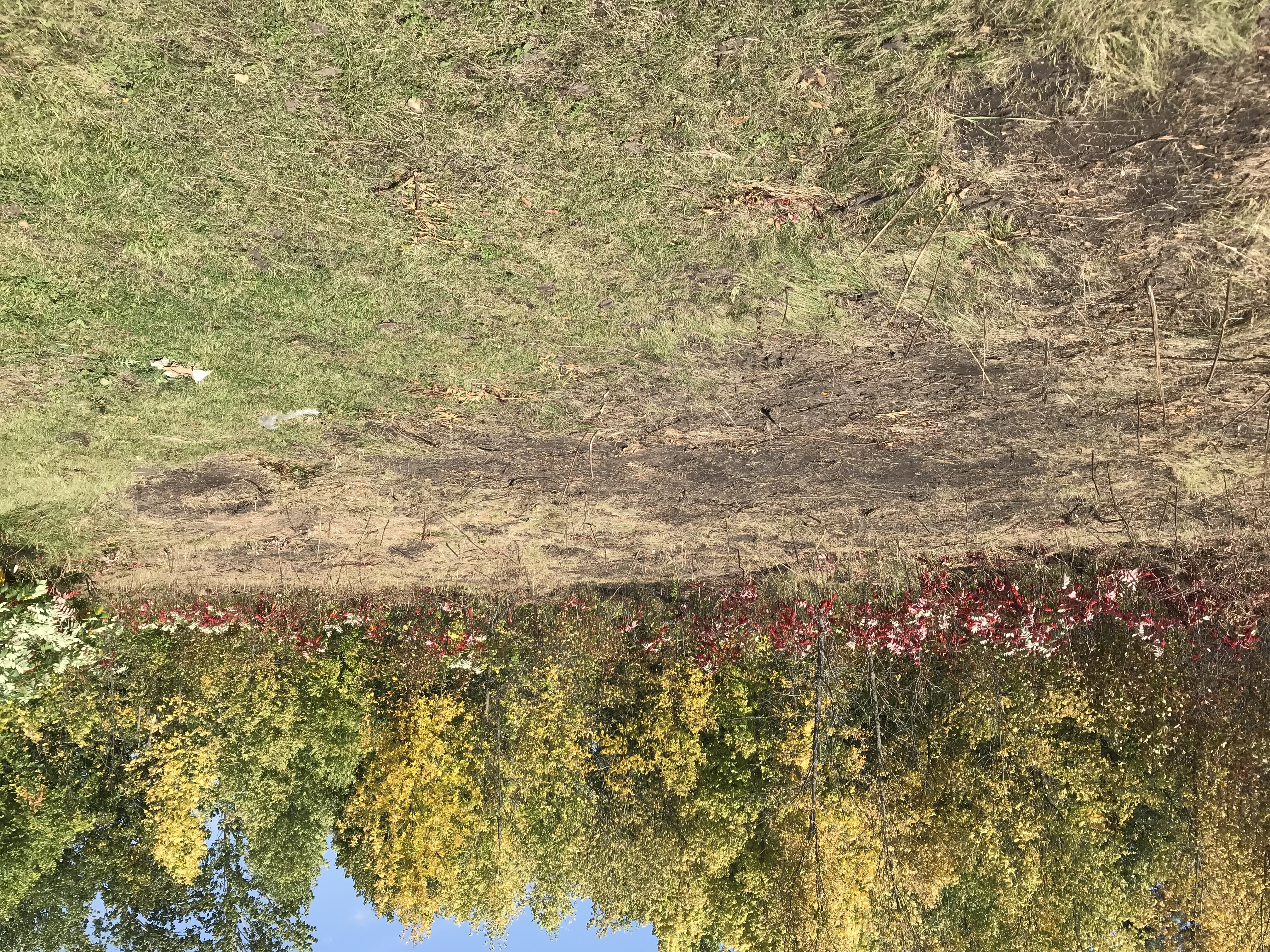

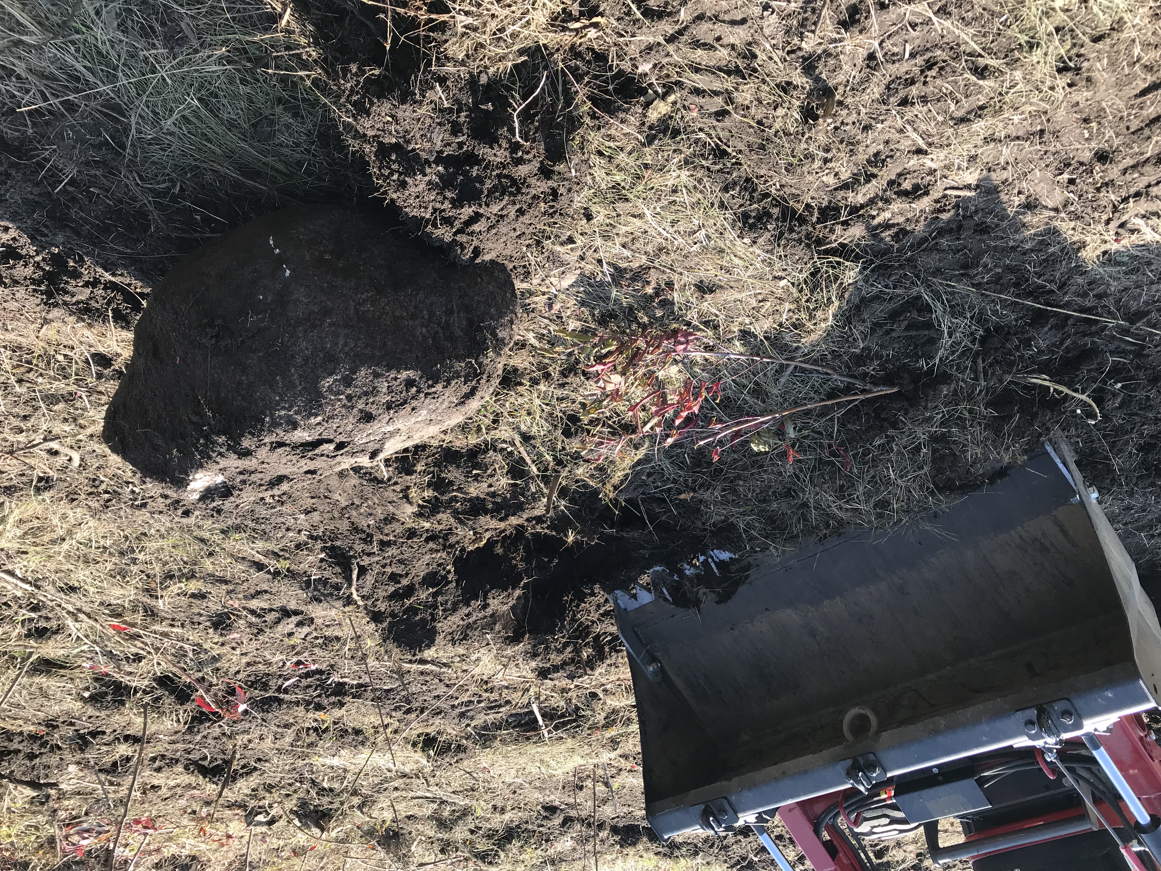

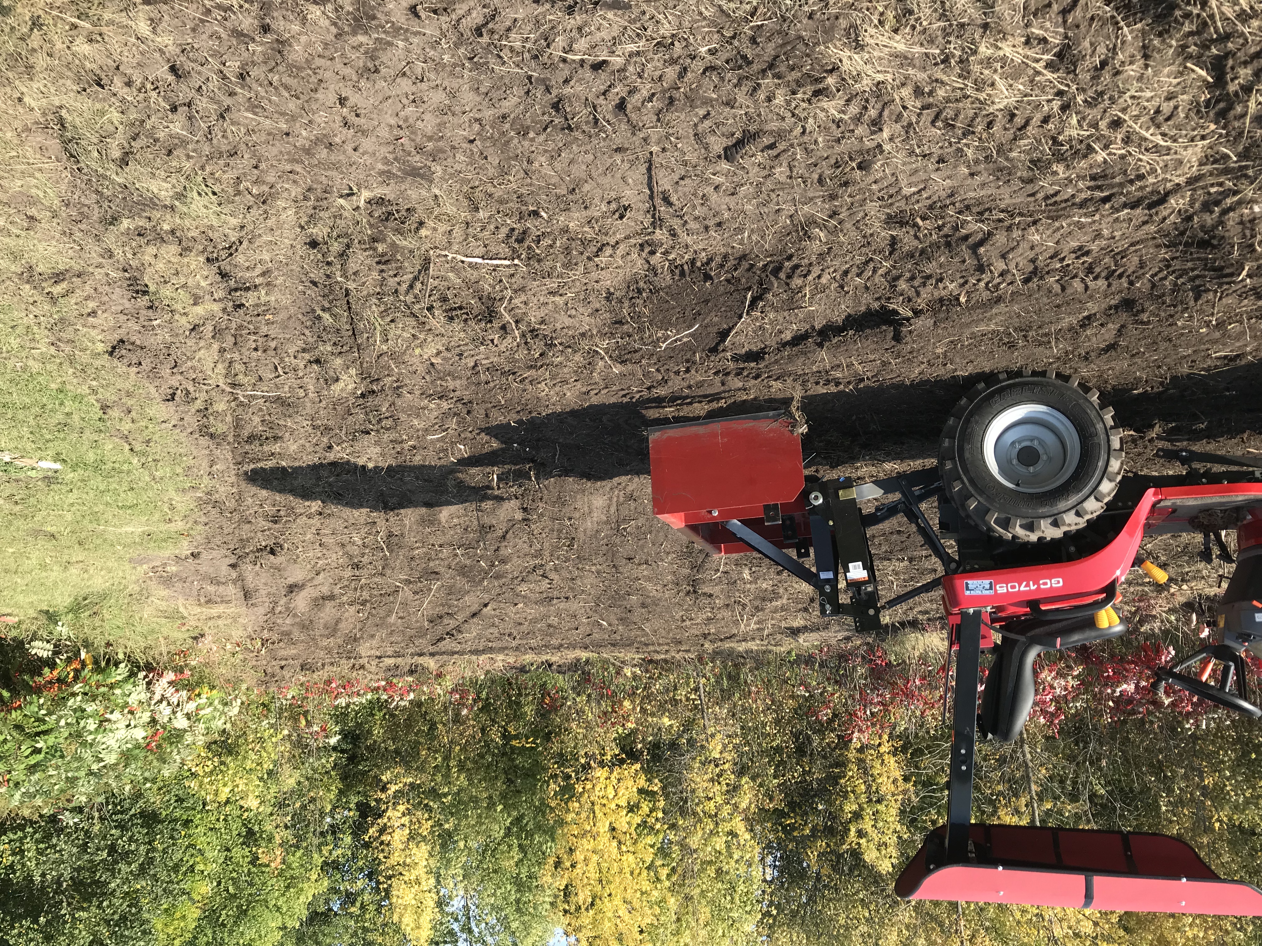

Well here is 2.5 hours of work and no deadheading the hydrostat, spun tires under load. I ended up extending the center tooth on the box blade and used it like a ripper and holy cow did I have piles of roots and sod, did that for about 1.5 hours and then I just kept running around with the box blade tilted just enough to cut high spots, I also found a good size rock to try out the Piranha bar on and it got it out.
Next time out I will drop all three teeth down half way and finish cleaning out the rest of the roots and leveling the ground, class 5 gravel will be used to level the whole area out.
This is when I started.
Getting the rock out.
What it looked like when I left today.

There were a lot of high and low areas when I started but it all ended up fairly flat by the time I was done.
