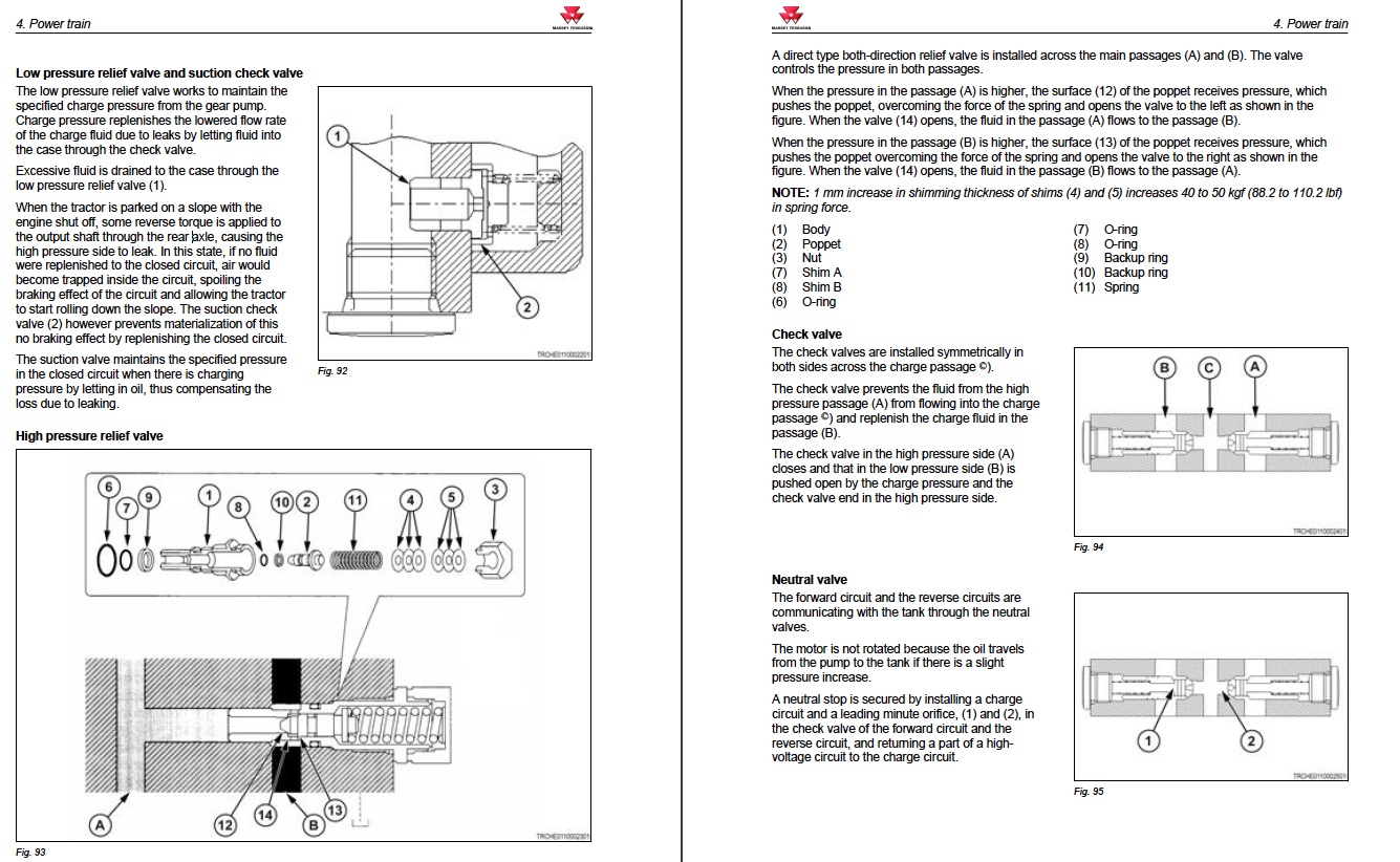

I believe on MF GC 17XX (05 to 20) series with ISEKI 3 cylinder diesel, all implements are are run off the pump in HST....

I seriously doubt that. How would that even be possible?. As with the swash plate in neutral the hydrostat pump make zero flow, there for zero pressure would be developed. Besides the first part of the paper he posted said the charge pump function was run off of the implement pump up on the engine... So NO>

Begging your pardon BUT there is no pump off camshaft of engine on the MS GC 17XX (05-20) series ... All pumps are located in HST housing all hydraulic plumbing originates on HST housing...... If I had not lost the copy of service manual in computer crash it would be easy to prove it....
THE flywheel end of engine block is solid ( and space directly next is occupied by muffler), and the timing gears for cam shaft and belts and pulleys for water pump and alternator occupies the "front" in close to radiator for engine (which is mounted reversed) ... Only thing I can find that may run off camshaft is diesel fuel pump....
Only "connection" from engine to all working parts of tractor is drive shaft off water pump, alternator belt pulley (crankshaft) to HST....

Well, I don't know where the implement gear pump is located on that machine, but the implement's DONT run off the hydrostatic pump. period. full stop. So what we may have is is a matter of semantics. You are now saying the implement pump is located internally not hanging out on the side of the engine. OK, cool. The implements still don't run of off the hydrostatic pump. Hydrostatic pumps are variable displacement pumps and are controlled by a swash plate with typically 9 slippers running on that swash plate and riding on those slippers are the pistons that direct the flow to the output ports. The swash plate angle is controlled by your foot. At zero angle or what we think of as neutral there is zero pump flow. That was my point, the hydrostatic pump does not run the implements. The implement pump is a continuous flow gear pump. The rated flow runs thru this pump continuously from the suction side from the sump thru the open center valves and back to the sump. So if we are arguing about a choice of words, fine, but I understood you to believe that the hydrostatic transmission pump was the source for the flow for the implements (FEL and 3 point lift, and any remotes if equipped).

Maybe issue is terminology, but the pump that runs all the hydraulics is internal to HST housing and uses same housing as its reservoir, you are most likely correct that it is NOT the HST pump that directly powers the hydraulics, but in no case is there any hydraulic pump(s) located on engine.... Only pumps on engine is diesel injection pump and water pump...... Since I lost all my reference material in computer crash, it is really hard for me to validate how system is designed and implemented..... Not calling you out I am actual pretty much in agreement with you...

Single hydraulic pump supplies fluid to power steering (2.6 GPM), FEL controls (6.5 GPM) , and 3PH (same 6.5 GPM as FEL), return to "tank" (HST reservoir) in that sequence....
The pump and geography of front of HST housing... "Control valve" portion of pressure regulator for 3PH ...
