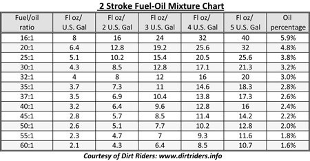

What is the recommended mixture? If recommended is 32:1 then 30 is probably OK. If the jetting screws were set for 50:1 and you're running 30:1 then it's getting less gas and is likely to run lean, = hot, (and seize). In any case, if it was running hot, the mixture screws need to be set for optimum power then a tad rich.

More oil = less gas, consequently 32:1 needs to be a little richer on the mixture screws. Oil is not a combustible component, if theres too much its getting in the way.
that I am in total agreement with- The fuel mix is also more viscous when more oil is added- which actually makes the engine run leaner- but with more lubrication. As long as the mixture is adjusted -jetting is correct then i think it is fine, I run my saws and string trimmer at 45 to 1 I have a 1954 Johnson Sea Horse that calls for 16 to 1 ( 30 wt engine oil!) I run that at around 36 to 1 outboard oil and had to adjust the jetting leaner.
The one other thing that I do disagree with is the statement that oil (types) make little difference - is when someone uses ANY 2 stroke outboard oil in ANY air cooled 2 stroke engine... the air cooled engine will invariably overheat and in most cases a bunch of compression goes away to if not also scoring the piston /cylinder wall or siezing. Just my :2cents:

Using more oil then recommended by the manufacturer is---in my opinion---a waste! One has to realize that todays oil is MUCH better then what was available years ago. I have used 50-1 ratio in my 1980 model Craftsman saw for years--with no problems!

32-1 = 3% oil While 50-1 = 2% oil . One ( 1 ) Percent difference .

FYI: 3% - 2% = 1% difference is wrong way to look at it.
3% is 50% MORE OIL than 2%, its a half again MORE more oil!

True there's not much real much difference between 32 and 50 except your oil jug empties 50% faster. People have more money to burn these days not like the old days, and oil was 97c for a quart now its $9.00/qt and nobody cares. For most that's a quart every other spring, not much to worry about.
Environmentally it doesn't make much difference because most people probably follow mfr recommendation 50:1
I'd use 32:1 in old eqpt, if I wasn't sure if it had modern nikasil cylinder or needle bearings. But I don't have that old stuff anymore. Which is odd, I keep a lot of old stuff - actually too much - but my 2-strokes are all modern.
But 32 is a good deal for the oil store especially at $6 - $9 per quart !

Folks should run what ever mix ratio they want to. I've run 32:1 - 50:1 and have settled on 40:1. Most of my saws are ported and turn more rpm than stock. I like a little more oil... I also use chainsaws more than the average guy, logging, thinning and cutting 15-20 cords of firewood a year.
I know several saw builders that say 32:1 in their ported saws make more power than 50:1 and that's what they recommend...
