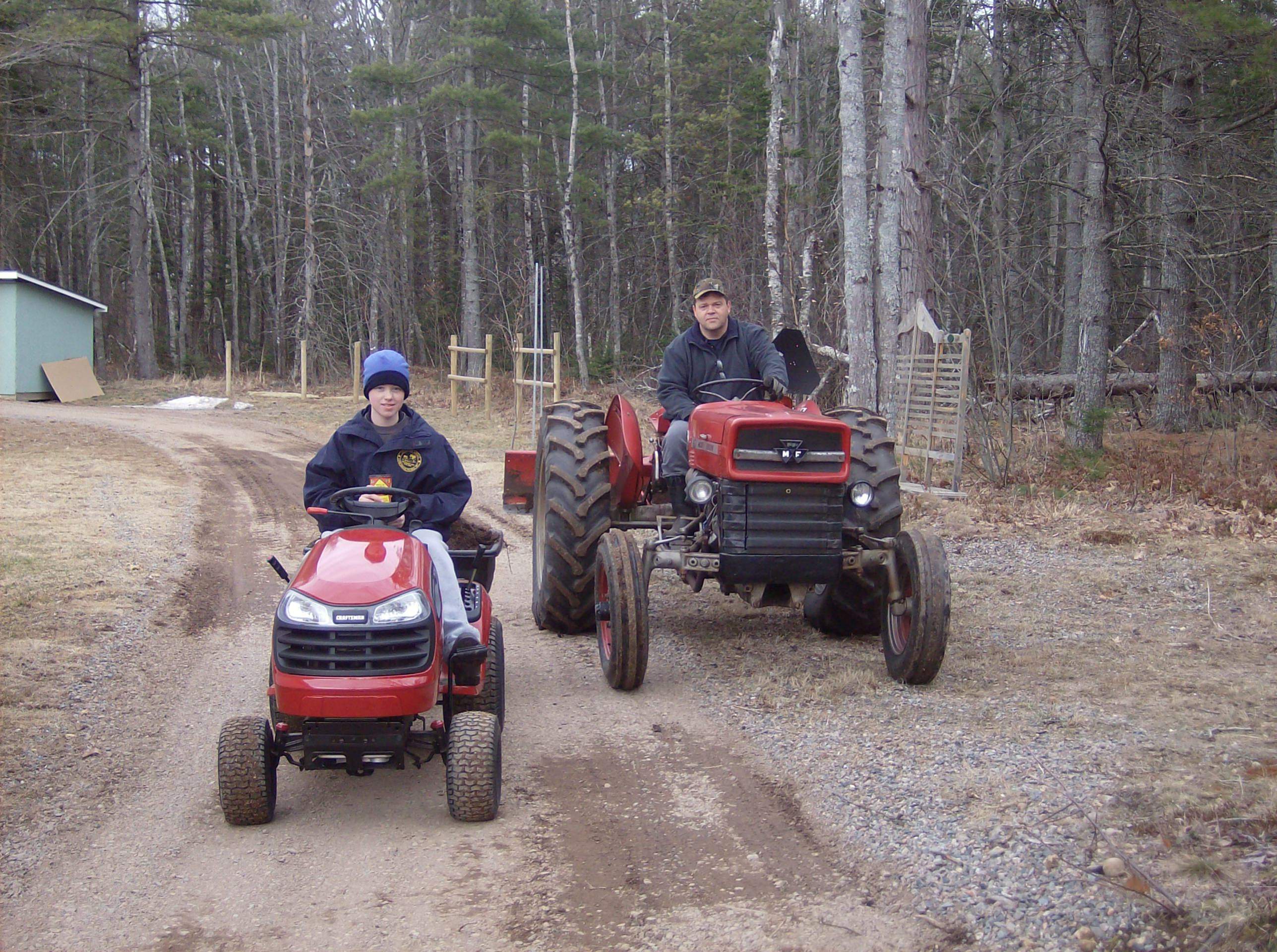

John,
As stated earlier, we use ours to haul dirt and rock to the gardens, and I've used it to haul a little gravel to establish trails through our property, but if I didn't have the old 135 and I was looking for something that would do most of what you are looking to do, I'd be looking for a used SCUT.
The advantages of a three point hitch and a PTO (post holes / tilling / raking / spraying) brings it to an entirely new level, and you will never exceed the machines capabilities for what you've described.
From your first post your intention was pretty much to mow the lawn, maybe tow an aerator and leaf collector, which can all be done with ease with a box store mower, been doing it for years. Now that you've included hauling several tons of rock is it possible there are other projects looming on the horizon the Mrs hasn't told you about........ :laughing: Why should you be any different than the rest of us.
Attached link is to give you an idea, 200 hours on a diesel engine is nothing. More money yet again than what you're looking at but a different league entirely.
$2500 ride on to a $4000+ ride on to a $7000 tractor..........
http://www.marketbook.ca/listingsdetail/detail.aspx?OHID=6864831&LP=TH&
