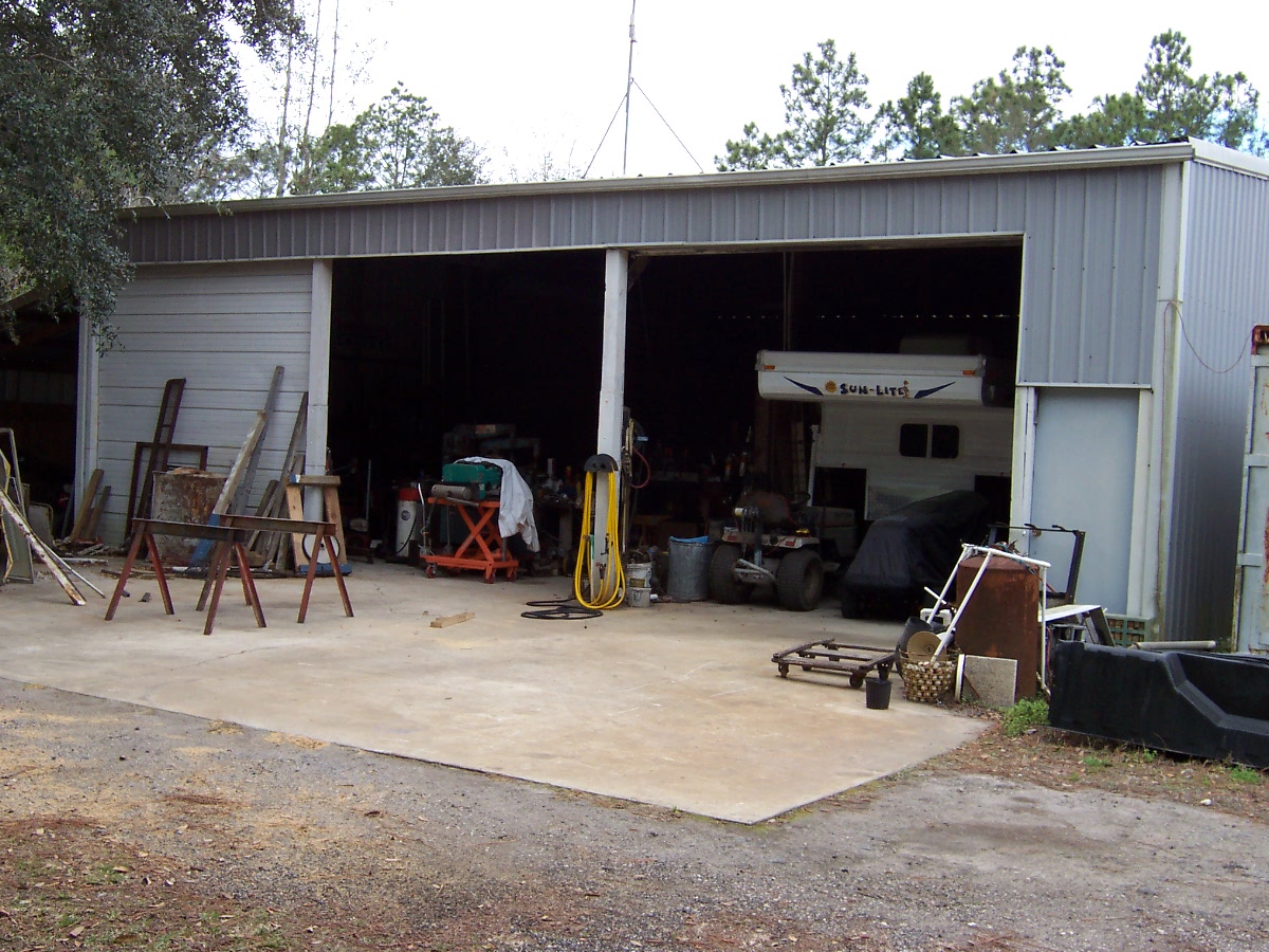

The building in the pic is my 40' X 50' shop.
When I bought my property it was a 24' X 24' garage with the roof pitched the wrong way.
I chained the front center post to a 6000 lb forklift, took the roof loose after bracing it with 45% 2X and raised it up 4' then added new post to the bottom and bolted it with metal plates.
I then went to the rear center post and raised it up 8' the same way. I built the rest of the building around it.
It is now 12' on the front and 15' at the center peak.
If you look at the two left door posts you can see the metal plates sectioning the posts.
I did all this by myself with no help!

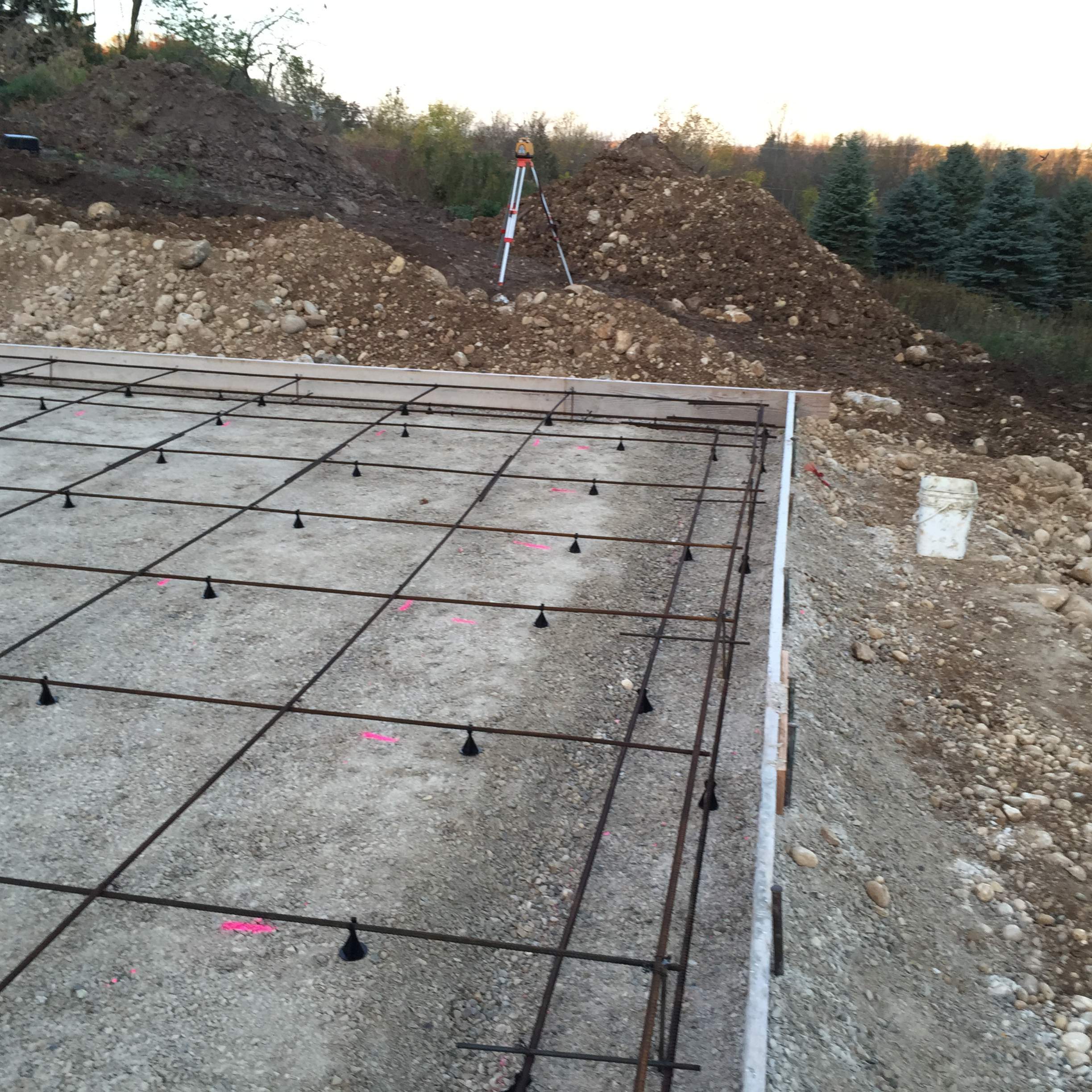

Very cool, I like the video. Any close up pictures of the foundation? Looks like an interesting setup.
/ Garage moving project
#20
It's a slab on grade design, 8" thick at the edges, 5" in the center with a 3' grid of #4 bars and (3) #5 bars at the edge. We excavated the native soil down to gravel and then built a pad back up using compacted 3/4" traffic bond. The bank walls are 12" CMU with ladder reinforcement every 3rd course and vertical #5 bars 48" oc. The verts are doweled into the slab to prevent sliding. The top of the wall is reinforced with a #5 bar in a bond beam with the vertical bars penetrating the beam.
The floor system are 2x10's 12"oc with the center span top supported off a W12x19 beam. The one end of the beam rests on the pilaster and the low side bears on a short double 2x12 header with (4) jack studs. The sheathing is 3/4" plywood, treated within 4' of the doors. To restrain the wall the plywood is screwed 4" oc with blocking at 24" intervals for the first 4'.
We excavated, built the pad up and tied the rebar cage ourselves. Our mason poured the slab and built the walls. We then took the project over; framing the floor and backfilling the foundation.
