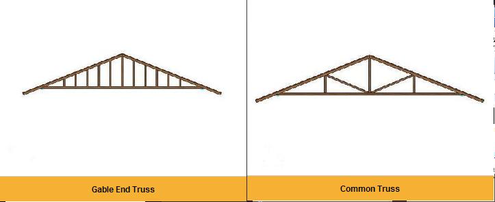

Gable trusses are usualy built to be placed on a weight bearing wall, and are not designed to hold any weight without being supported from underneath. Look in your attic to see if the gable truss looks exactly like the rest of your trusses. If not, you need to support that truss along with the gable. I build custom homes up to about 7500 sq. ft. I doubt if you will be able to frame any kind of header to span 16 feet that won't sag a little bit. Call a local truss supplier, they usually supply LVL material, glulam, paralam type beams, too. They will tell you what size beam to use, and they can supply it. Hope this helps.
I have to agree with this. I am currently building a new garage and the end trusses are designed to go on a weight bearing wall.
