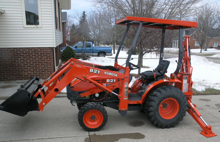

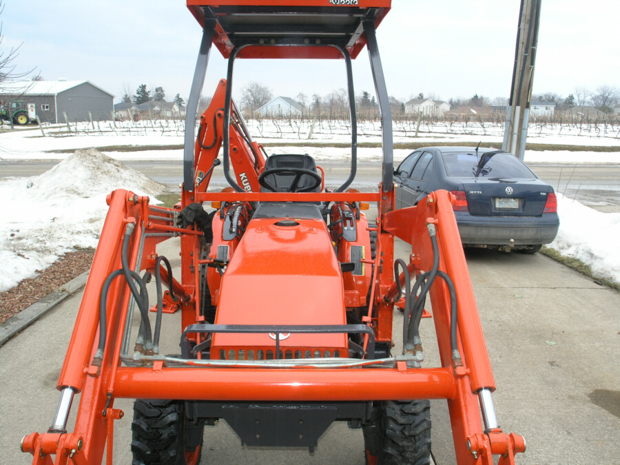

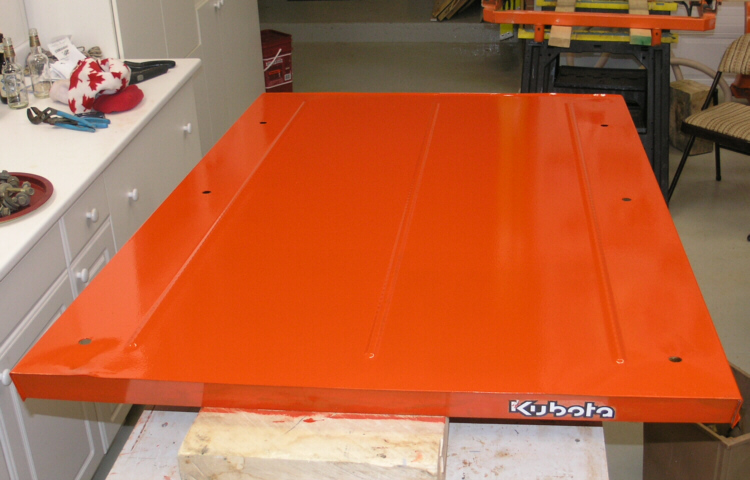

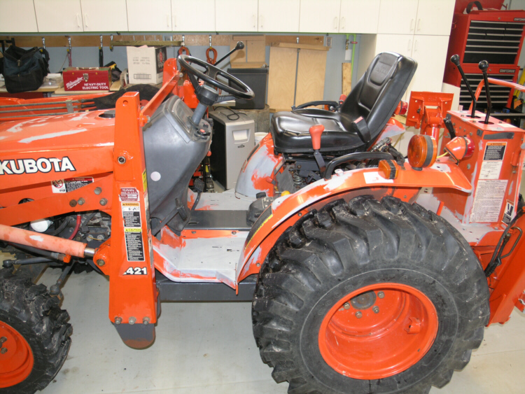

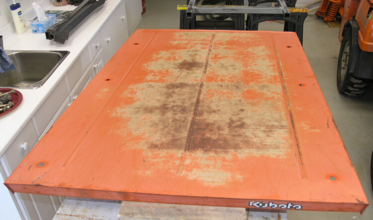

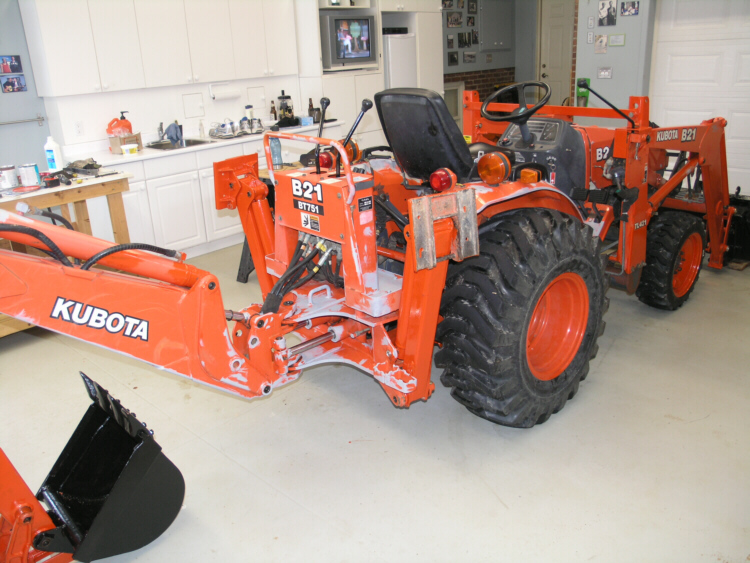

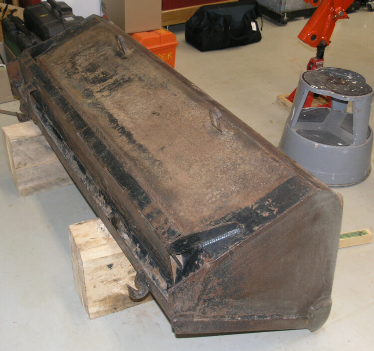

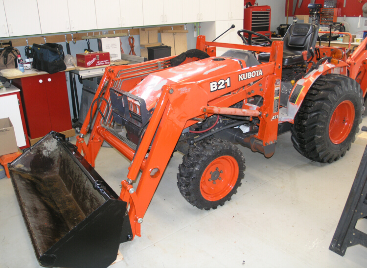

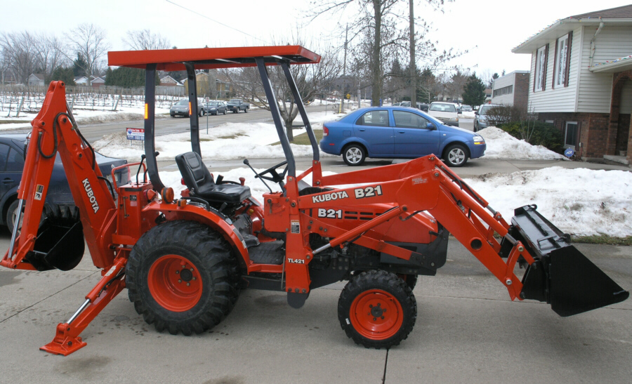

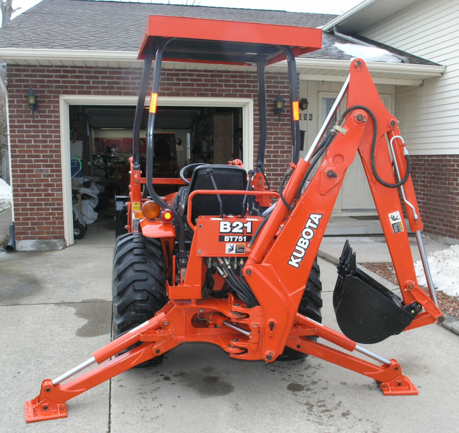

I'm done. Here's the finished paint job.
There was some earlier discussion about 5 ft. & 10 ft. paint jobs. I used a brush & roller for all the painting - mostly touchups. I call it a 20 ft., candlelight, 20/100, paint job - best viewed from 20 ft in dim light without your glasses.
At least all the metal is protected.

What brand of paint did you use?

The pictures look good. I looks like a professional job. You are probably the only one who is really going to look at it up close, and as you said, at least the metal is protected.
thanks,
reed
Kubota Orange from Carquest (their part no CFP 4707-GL). $45 / gallon. Good match. I started using rust oxide colour primer but found coverage was much better over grey primer.

It looks pretty darned good to me no matter how you did it.

Kubota uses a light tannish color primer. So you were wise to switch to a lighter color. Kubota doesn't use light primer to lighten their color, they do it for easier coverage with less paint.
Good job. I like how you detailed it including adding stickers. Very professional from my seat. And very time consuming!!! :thumbsup:

Not time consuming - all decals are original. I just painted around them.

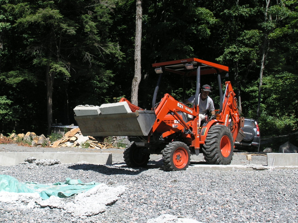

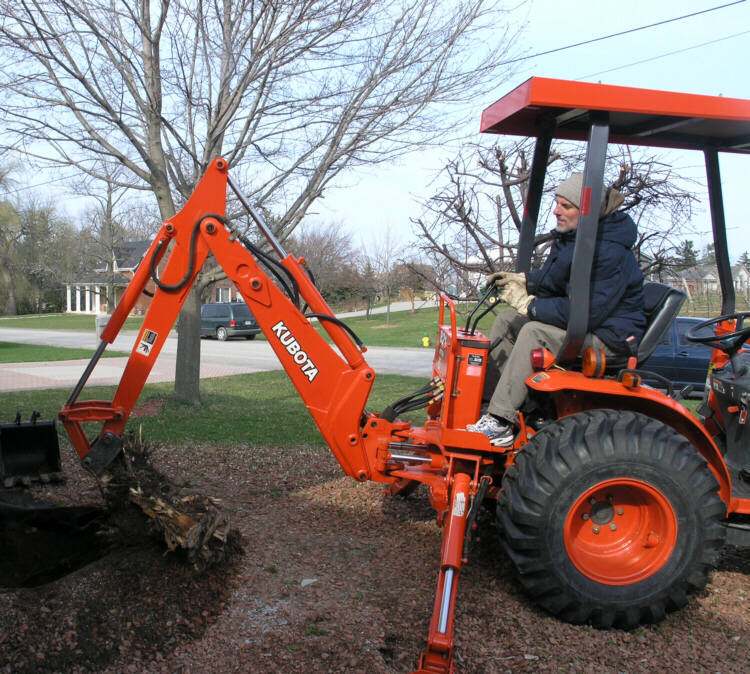

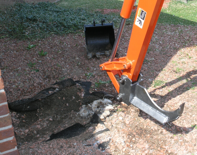

I thought I would give the machine a try at home before its one way trip to the cottage. I cut a cedar bush down last year leaving the roots. Last fall I bought a thumb & finger from Brotek. I haven't used the thumb yet but this gave me a chance to give that root the finger.

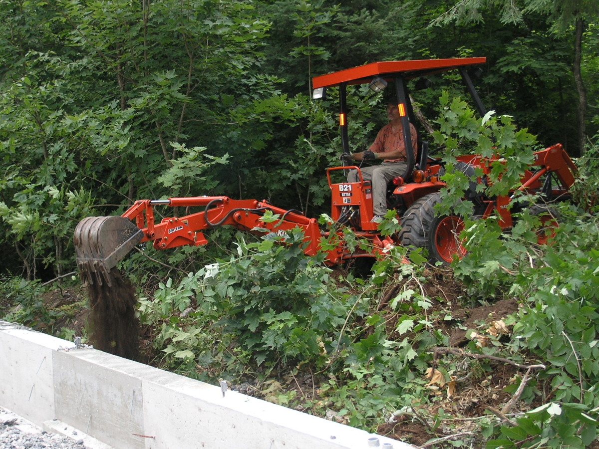

I'm finally putting this little beast to work. Lots of fun - I don't know how I got by without it before.
