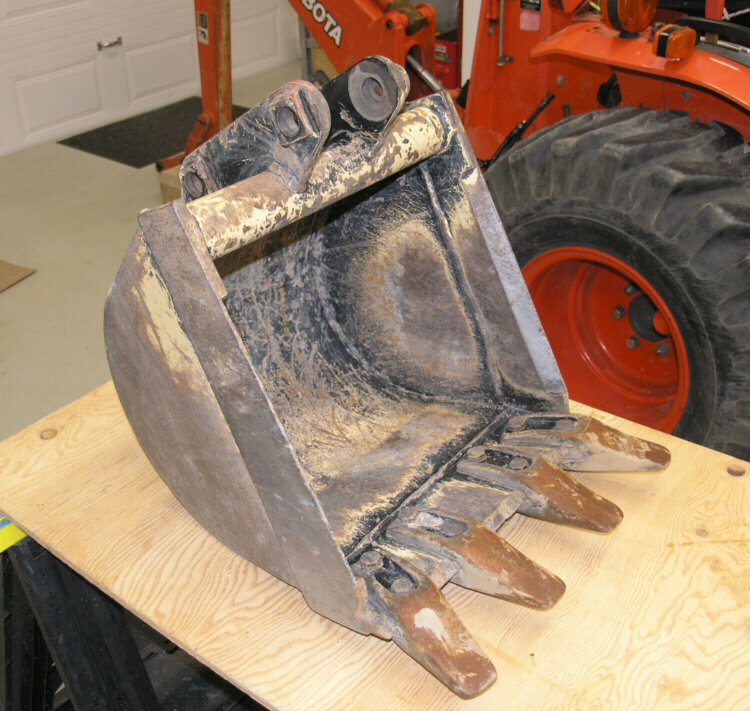

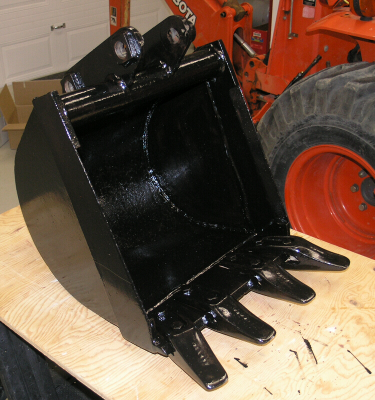

#24
My painting got sidetracked as I got involved doing some minor repairs.
Here's a start.
I know. I know. The bucket is just going to get all scratched up first time I use it. But you have to understand that this is my first tractor & I want her to look good when she arrives at the retirement home next spring.

The grey paint I bought from the dealer was less expensive than the orange, about $24 per quart. It goes a long way. I painted the bucket with it among other parts and since then I've done quite a bit of work with the FEL and the paint is not scratching. I'm impressed. I think it's worth the price. Oops, sorry, just noticed you said that you can't get factory paint where you are.

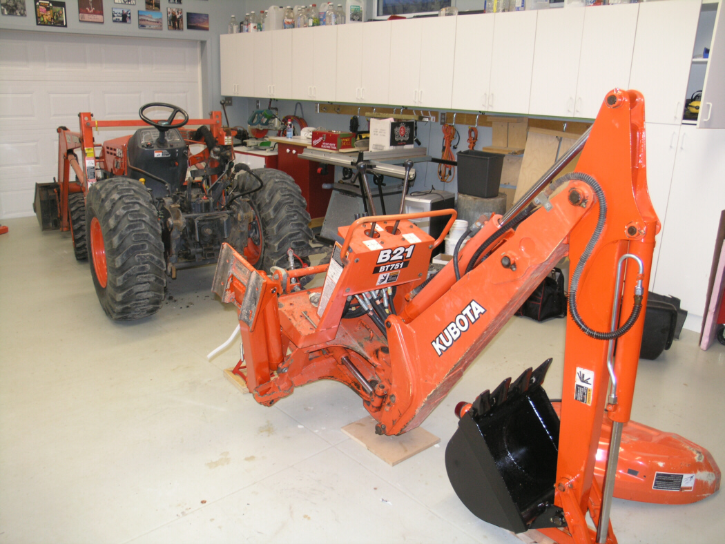

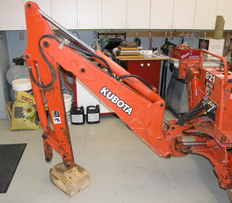

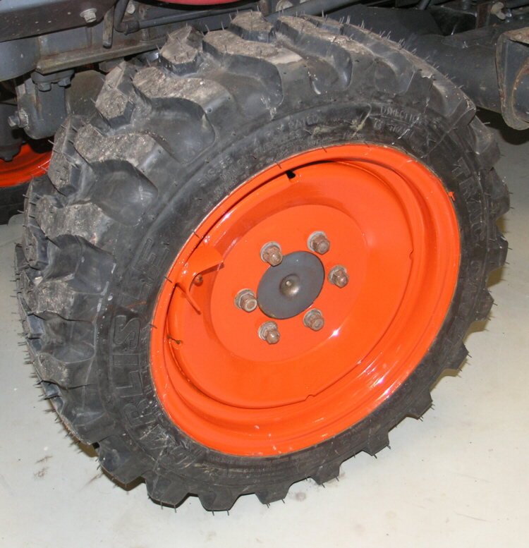

#28
... It's called a ten foot paint job. ...
Until now I've spent most of my time on minor maintenance items before I start painting. I just did the bucket & wheels with a brush & it looks acceptable. I'm calling it a 20 foot paint job. I'm more interested in making sure everything is OK mechanically than having a perfect paint job (or even a 10 ft. paint job).
I'd like to try some spray painting but I can't do it inside & its too cold outside, besides, it would take more disassembly than I want to tackle. So I've decided to concentrate on the mechanical side & touch up any bare metal with primer & finish paint. Maybe I'll end up with a 30 foot paint job.

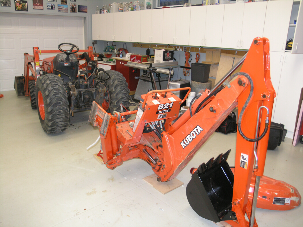

I haven't done much painting but the service & minor repairs are progressing:
- front axle oil seal changed
- new synthetic front axle oil
- new front tires
- new synthetic engine oil & filter
- changed most of the bushings in the backhoe
- changed 3 pins in the backhoe
- backhoe removed (that was a chore)
- hydraulic oil & filters changed, screen cleaned
- fenders removed
- complete seat mechanism removed & cleaned - ready for reassembly
- lubricated all mechanical linkages below seat with Fluid Film
I've been prime painting any bare metal I come across & touching up with paint as I go. I painted the bucket with a brush. The dipperstick's rusty spots were primed & touched up with a brush.
I'm focusing on getting all mechanical components operating smoothly & protecting bare metal.
