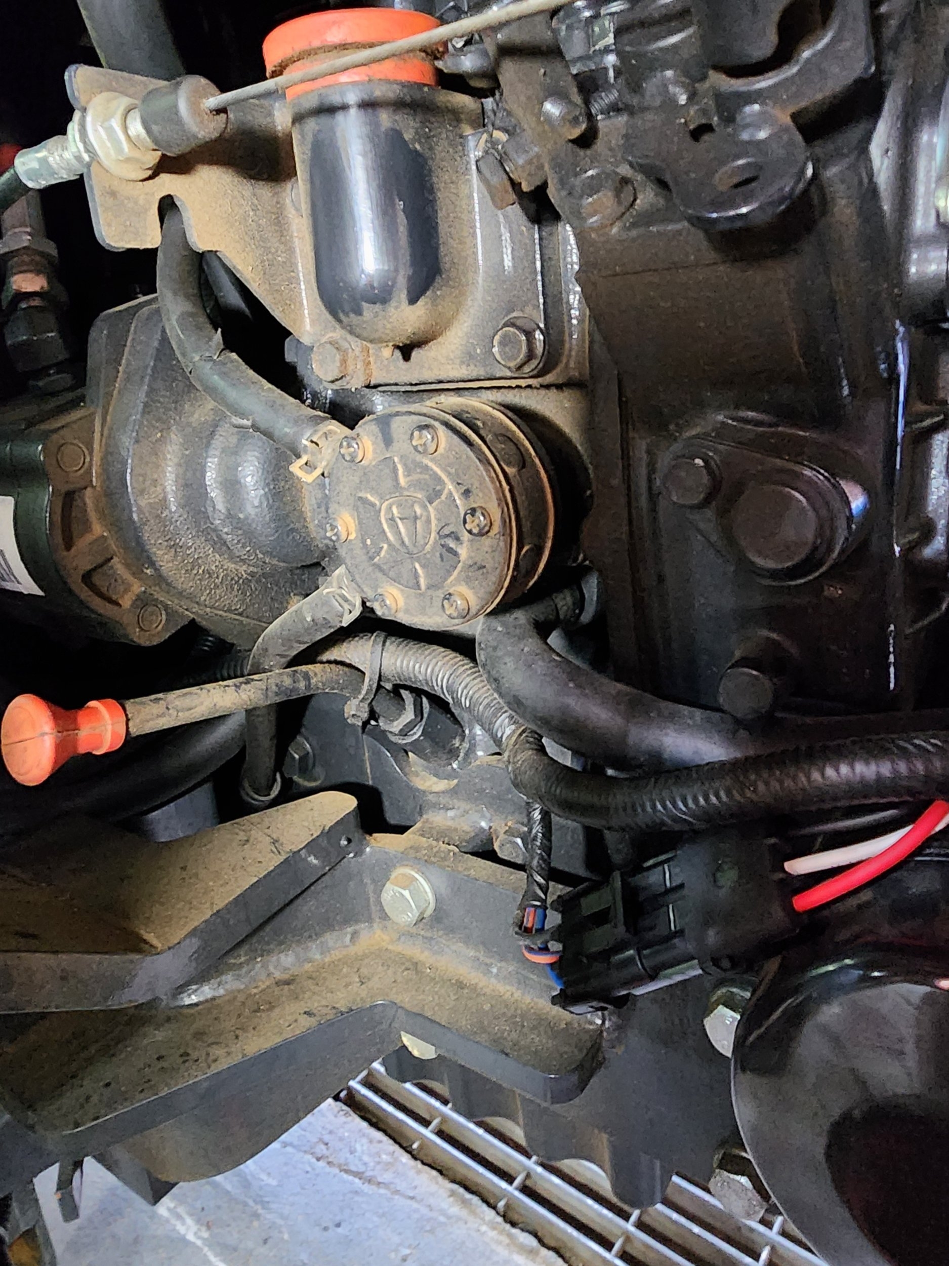

What would cause this type of problem in a very young, low hour tractor?

Well Im not a mechanic and the tractor is under full warranty so Ill let him do his thing
Am I correct in saying this is the fuel pump?? Actually disregard ...it is the fuel pump....LOL

Does the solenoid activate when the key is turned on??
Remove it from the pump, ground the mounting ear to ground, turn the key to start and see if the solenoid activates.

brand new solenoid....mechanic is coming here in the morning so Im going to let him do his thing

UPDATE:.....Dealer picked up the tractor and took it 2 hours away from where I live. 5 minutes after getting it off the flatbed, the Kioti mechanic had her running.
Turns out there was a fuse blown for the starter solenoid, a bad PTO Switch and two of the hydraulic hoses we switched around.
The previous owner had bypassed the PTO altogether.....*******.....So after a week I got her back in perfect order...Thanks to all who have assisted me with this pain in the ass problem......
