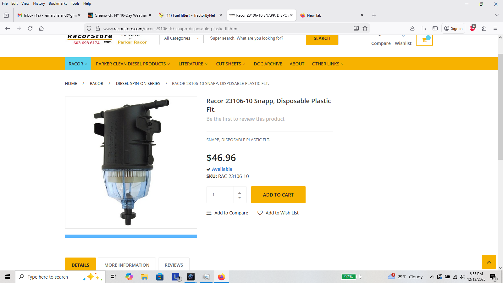

Of course I got to browsing the Racor website, guess what I found;

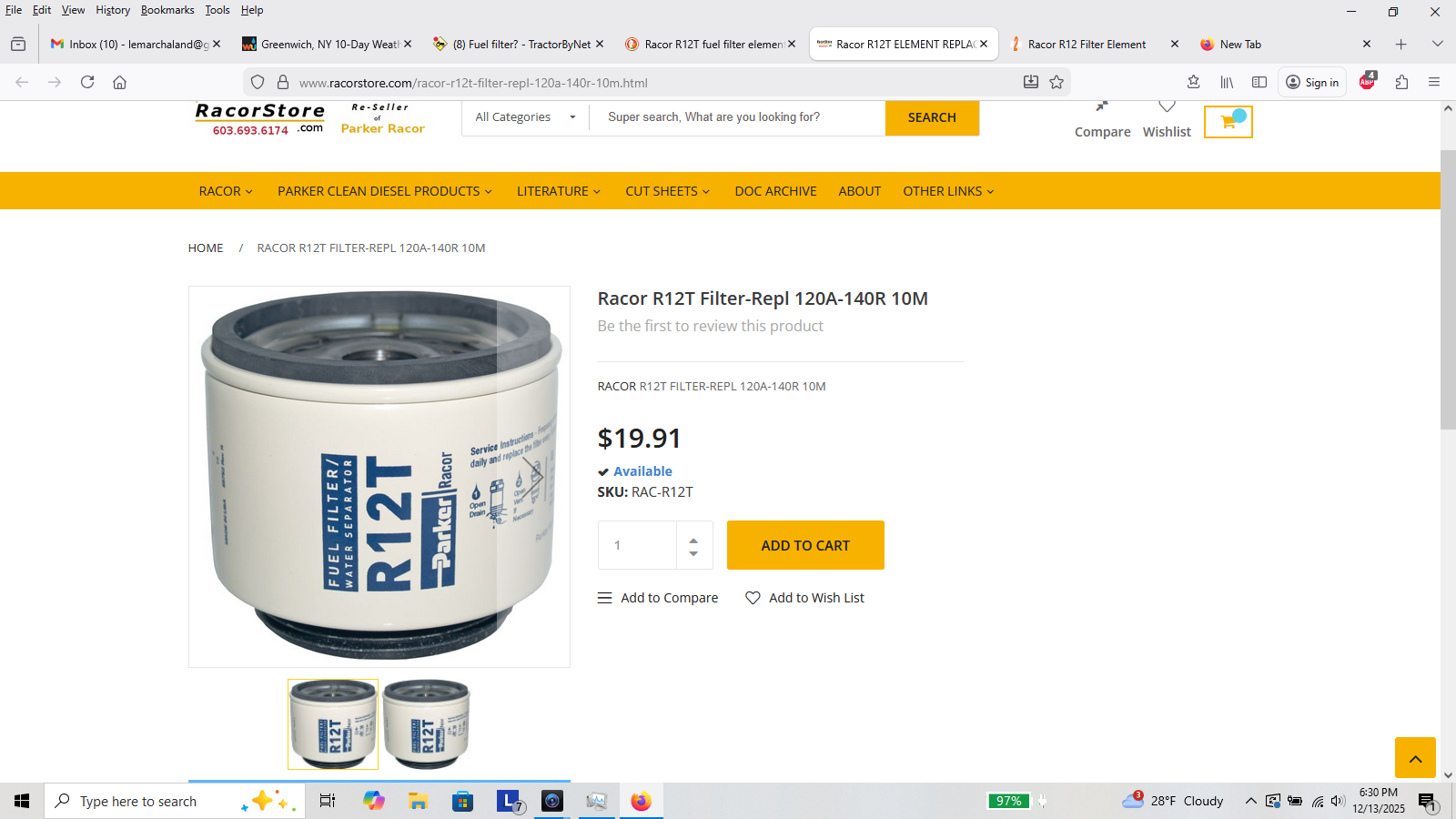

The genuine article complete;
They look awfully similar the amazon's one, probably made at the same plant,
I think i'll buy the housing from the amazon but the filter elements from racor.
Actually R12t is a 10 micron filter according to Racor website.
the 2 micron is R12SUL.

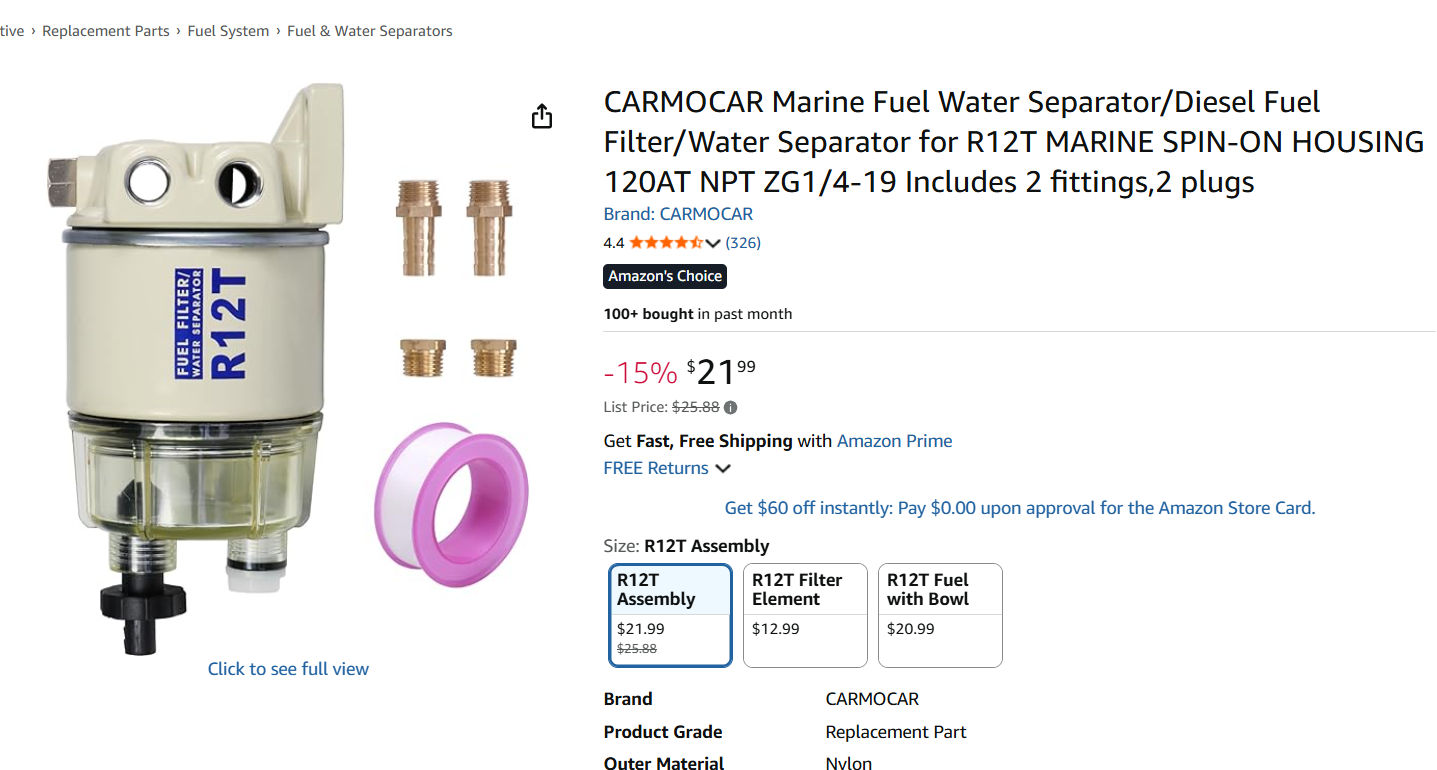

Finally got around to install a new fuel filter. I'm sure the old one would serve me for another 500 hours, but me being **** about maintenance wanted to do it now.
I decided to try one from amazon. If i didn't like it, easy to return. Chosen the one with the best reviews even though I'm 99% sure they all are made at the same plant with the genuine Racor, the only difference is the writing.
It looked to be very good quality which confirmed my 99% opinion. Really solid, great machine work and cost only $18 (with 10% coupon).
It is a little larger then the OEM, so I had to change the location and fabricate a new bracket. Took me a little while (about 2 hours including drying time), but now i hope i'm set for life.
Here is the filter: Amazon.com
