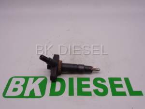

I bought this tractor not running, didn't know it was a 1998 emission tractor, PO said he changed the fuel filter and he could not get it to run after new filter. To say the least, I have learned a lot about the NH 3930 emission tractor and everything I have learned cost money, rebuilt injection pump, all injectors rebuilt, new filter assembly, not to mention learning how to get the pump set in time to take it off the tractor. It is a learning experience that I love, but after getting it all back on the tractor it runs pretty bad with no power like it is out of time. I stopped at that point waiting for a good day to check out the injectors again.
   / Ford New Holland 3930 Fuel System #14
87800132 Non-emissionized injector
87801538 emissionized injector
#15
These numbers must be for the nozzles for the injectors. I have not been able to find the replacement injectors yet. When I enter the number for the emissionized injector the search takes me to Ebay, Amazon, and a lot of other sites, but all I get is standard Ford NH injectors, nothing for the emission tractors.
My original injectors are marked LRABO 1601A JGR Lucus. I am sure some Diesel shop could direct me to the right nozzles
