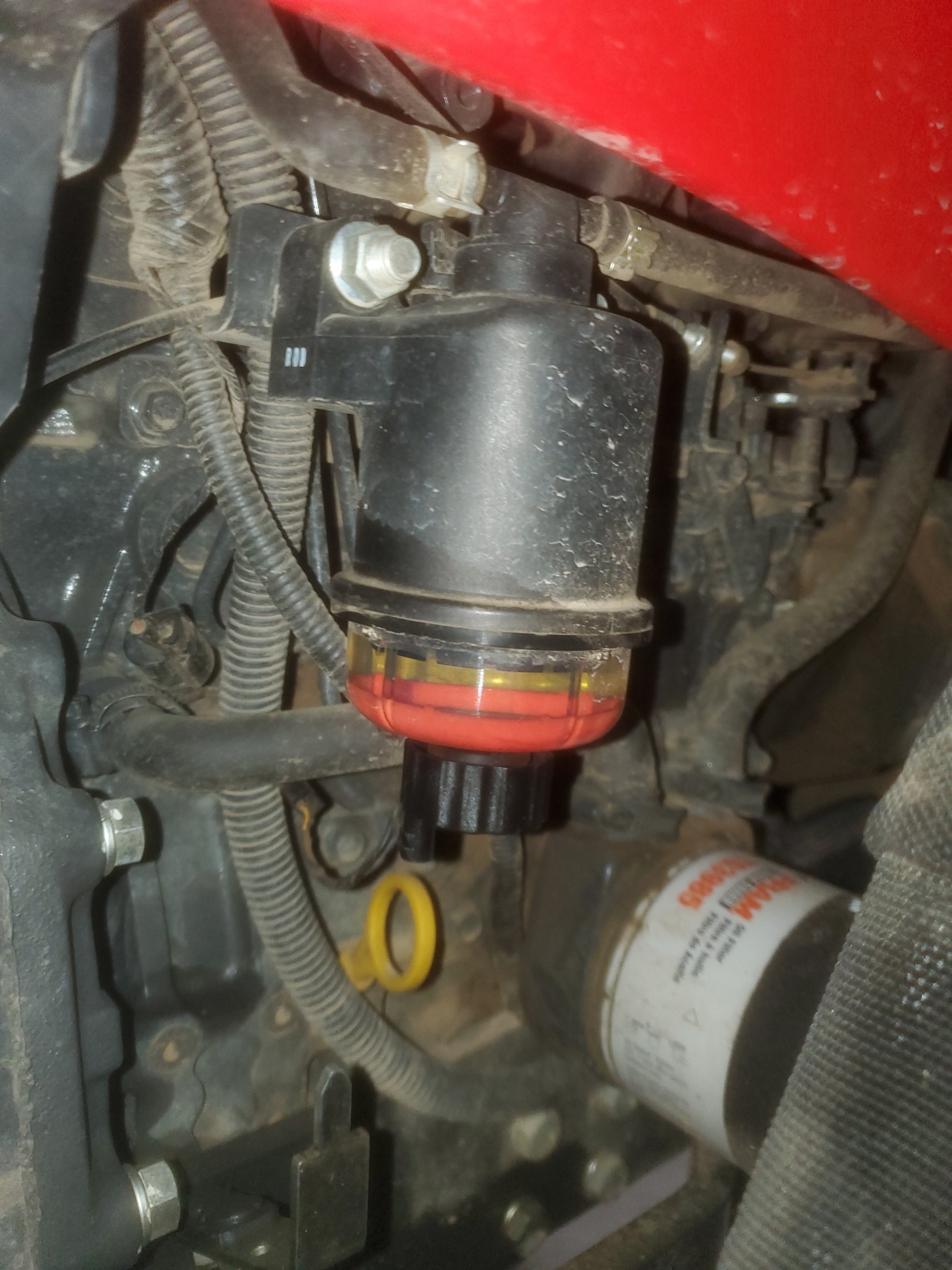

I have this kind of filter. There is no maintenance for it, just replacement, however, my search skills betrayed me again, i cannot find it online.
Where can i find one or maybe just replace with something more conventional?
What do you do TBN gurus?

Dont have a TYM, but... it appears to me that its a paper filler inside the bowl, or is this just a simple sediment bowl with a water bleeder? If its just a sediment bowl, and water bleeder, you would only replace if damaged.

Hmm, thats an "intresting" design choice... Why wouldn't they use a standard can type fuel filter thats screws to the assembly, Or use a removable bowl with a paper element? Seems like they turned a $30 assembly and a $10 filter, into a $80.45 part...

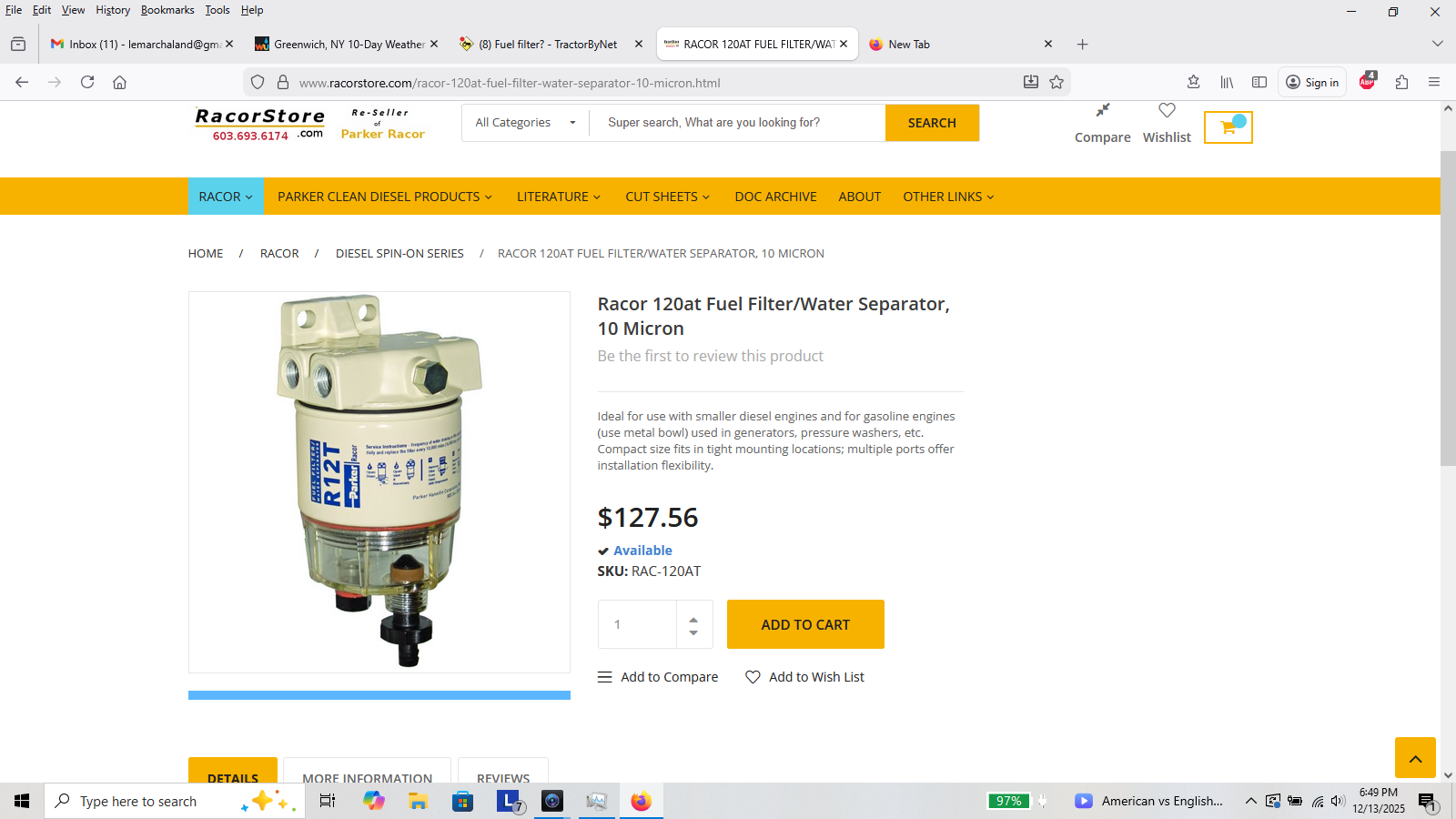

/ Fuel filter? #12
The chinesse housing is considerably less expensive then the genuine Racor,
the actual Racor filters are likely to be a better quality filter , in the R12 lineup you can actually get a 2 micron filter element.
/ Fuel filter? #13
The genuine article complete;
/ Fuel filter? #14
Of course I got to browsing the Racor website, guess what I found;
/ Fuel filter? #15
Buy once, cry once with the Racor filters. I put a 215r on my tractor with a 2 micron element. The replacement filters can be found a case at a time for $10 each.
/ Fuel filter?
#16
They look awfully similar the amazon's one, probably made at the same plant,
I think i'll buy the housing from the amazon but the filter elements from racor.
Actually R12t is a 10 micron filter according to Racor website.
the 2 micron is R12SUL.

Finally got around to install a new fuel filter. I'm sure the old one would serve me for another 500 hours, but me being **** about maintenance wanted to do it now.
I decided to try one from amazon. If i didn't like it, easy to return. Chosen the one with the best reviews even though I'm 99% sure they all are made at the same plant with the genuine Racor, the only difference is the writing.
It looked to be very good quality which confirmed my 99% opinion. Really solid, great machine work and cost only $18 (with 10% coupon).
It is a little larger then the OEM, so I had to change the location and fabricate a new bracket. Took me a little while (about 2 hours including drying time), but now i hope i'm set for life.
