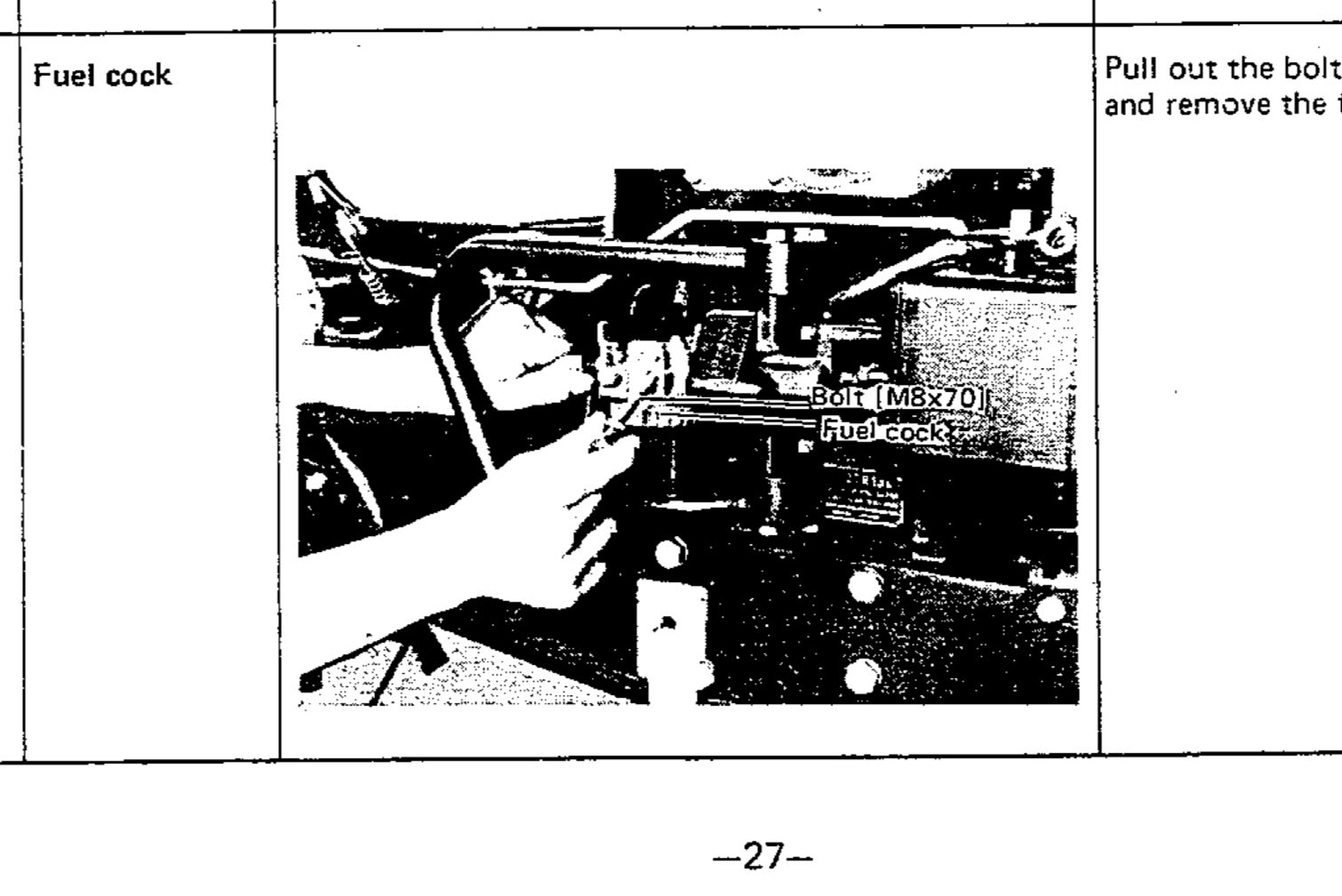

From an online manual, perhaps this horrible picture may help:

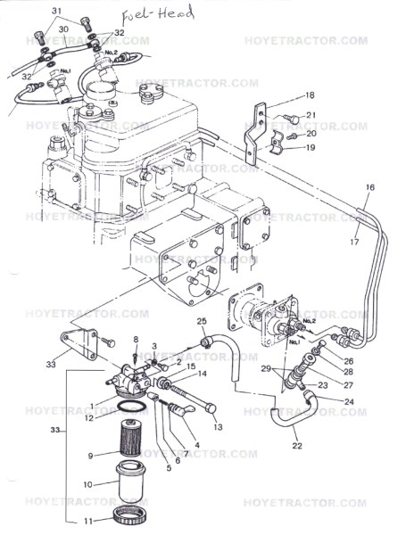

The 155 FB-1 Fuel bowl same as this Dia. The YM1500 is pretty much the same tractor.

For some reason I can't view your link...

You say its pretty much the same, any thing that might not be interchangeable as I look for parts? Thanks for the help

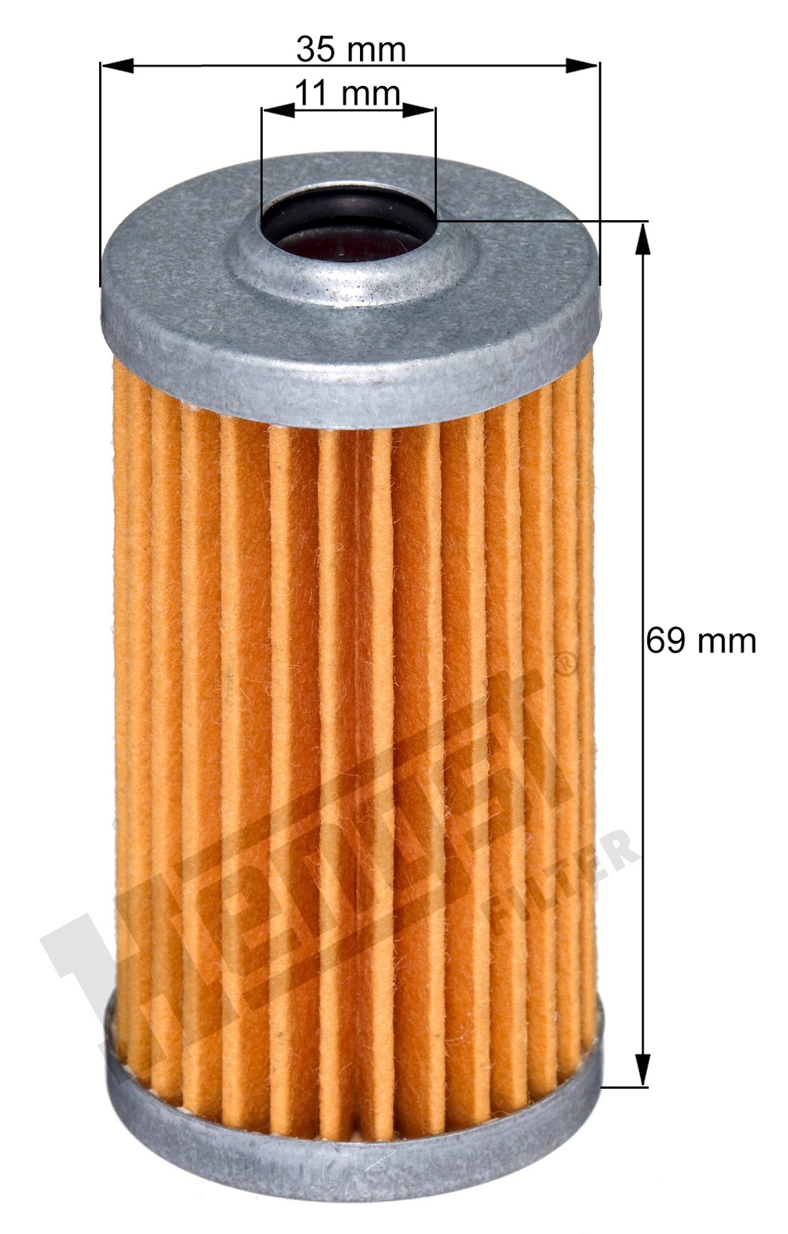

The tall filter is 88mm and the short filter is 69mm in height.
Here is the SHORTY.

The original bowls from Yanmar require the spring. The aftermarket bowls do not need a spring, instead they have a circular plastic rib at the bottom of the bowl.
Item-12, the spring.
