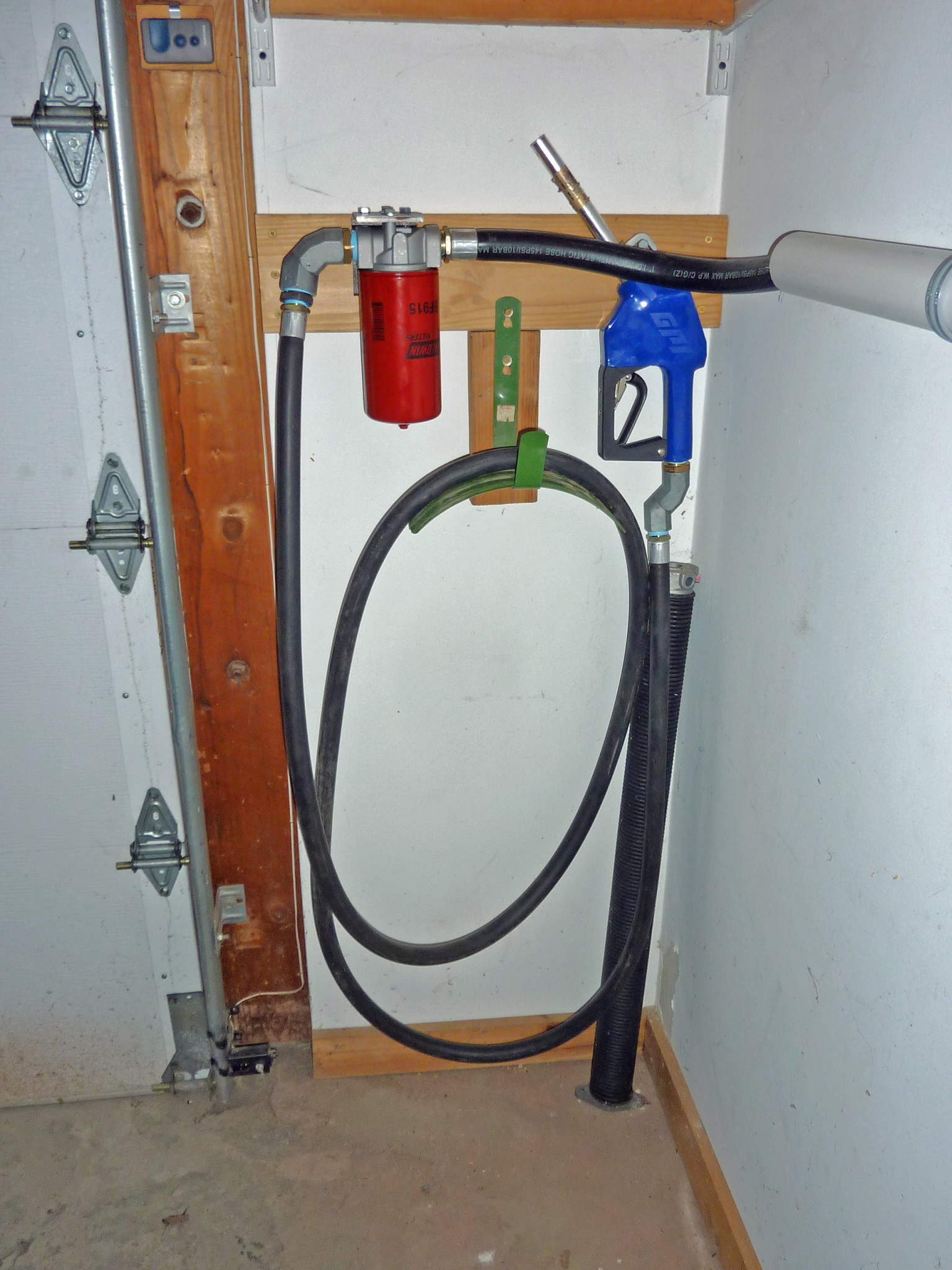

I've had it with those fuel cans. I ditched 'em all and installed this near the garage door:
I put a 110V fuel transfer pump on the 500 gal. fuel oil tank for my oil burner. In my state, home heating oil has to be ultra low sulfur, so it burns just fine in my tractors.
End of hassle.
Cool idea. Is the home heating oil #1 diesel, #2 diesel or kerosene?
The product is called #2 home heating oil. It is ultra low sulfur, dyed red, and is the equivalent of #2 diesel fuel. I've used it in all 7 of my Kubota tractors since 1979 with no issues. The temp gets down to -10F here on occasion and even though it's #2, I've never had a problem with it gelling. I filter it twice before filling the tractor and I've never had to replace any tractor fuel filters.
I know others who advise against doing this but it's worked for me for over 40 years.
