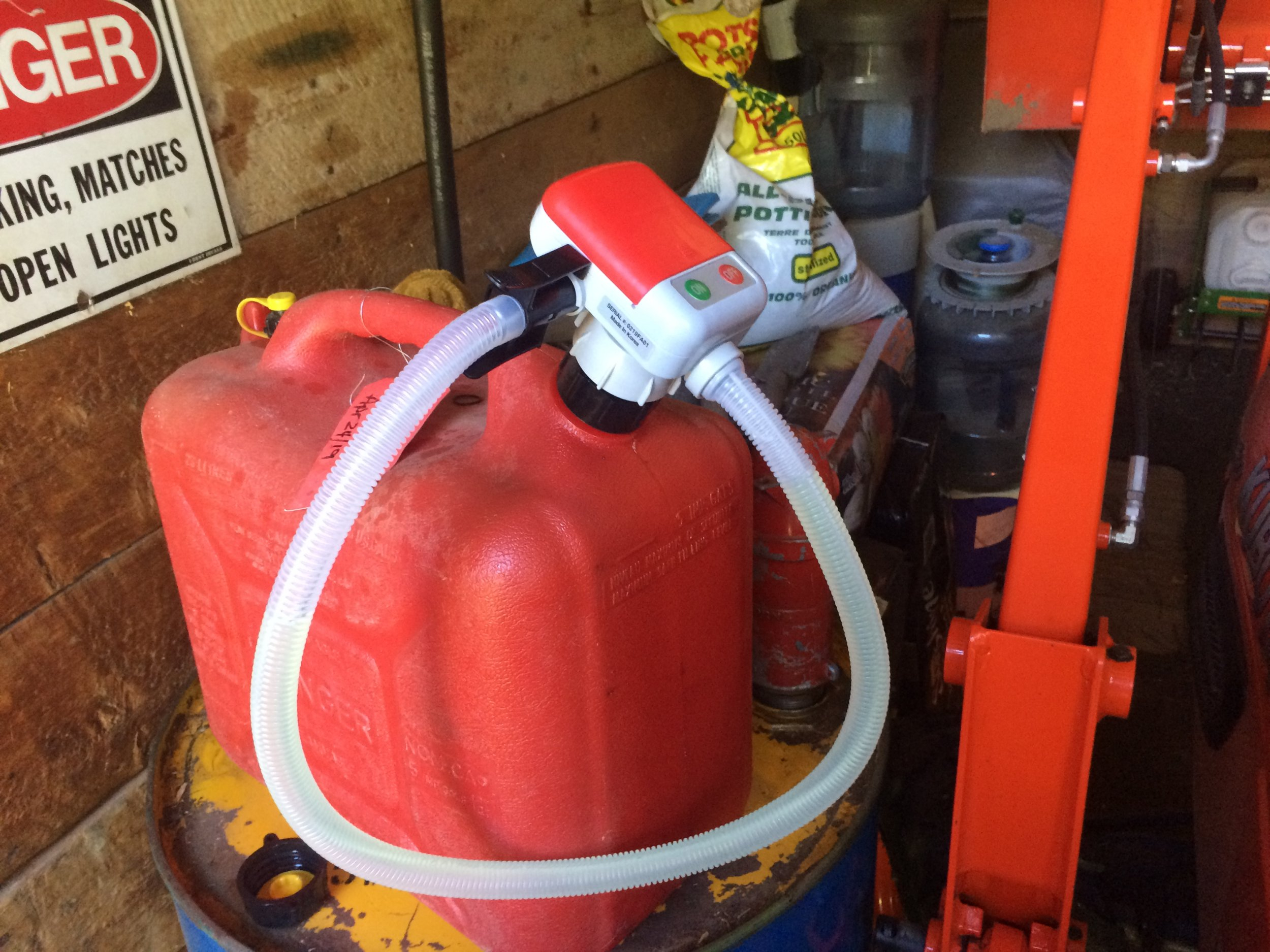

Maybe referenced somewhat before, but I too cannot easily lift a can up to my tank inlet, but have found these inexpensive battery operated pumps extremely easy to use. They will not totally get all the fuel out of the can, but what remains can then be easily poured into the tank.

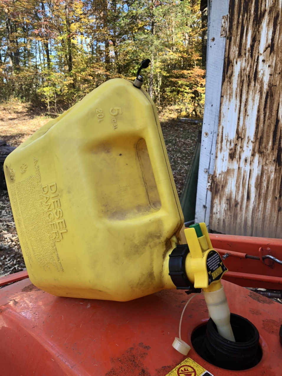

Like the no-spill diesel fuel containers. Even my wife can fuel the little tractor but doesn’t like to. The bad part was holding the button down. 5gallons took 2-3 minutes to drain. Added these vents.
ZOOYL Gas Can Vent Caps Retrofit Kit 6 Packs, Enhances Flow for Faster Refills, Universal Fuel Tank and Gas Can Replacement Vent Valve Made of Durable Stainless Steel with Attached Silicone Rubber Cap https://www.amazon.com/dp/B08VH2ZL1...abc_T7P0EXR2HVQBDW8NV2R8?_encoding=UTF8&psc=1
Now can drain 5 gallons in 30-40 seconds. Not a single drop spilled.

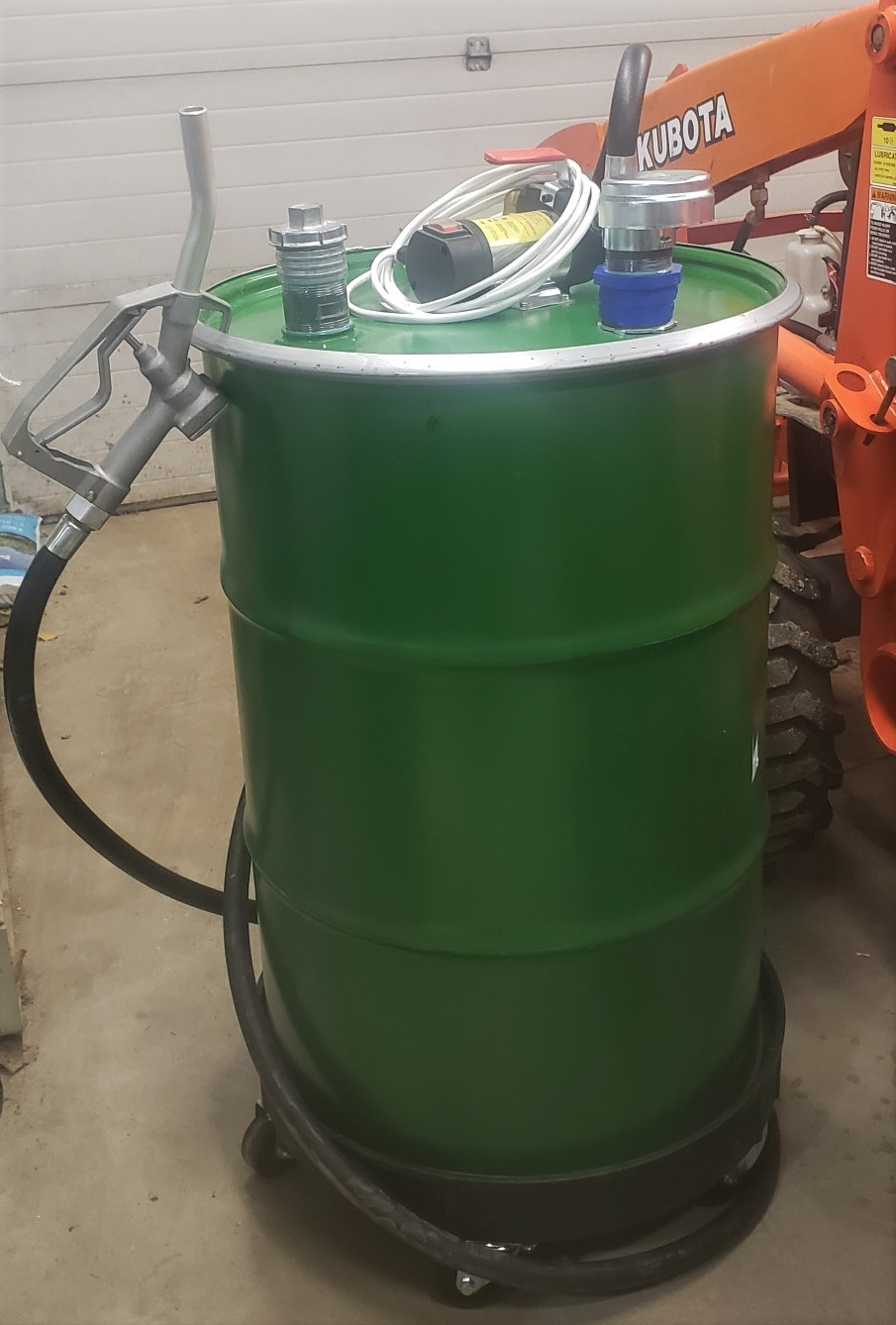

Still using 5 gallon jugs, but in the Spring I am going with a 50 gallon square tank and a 12v pump. I will mount it so I can load it and unload it with forks for a run for fuel. I've been using 60 to 75 gallons a year so 3 trips in two years will do me. I am considering stepping up to the 100 gallon version, it's just $20 more, but fuel isn't all that far away.
