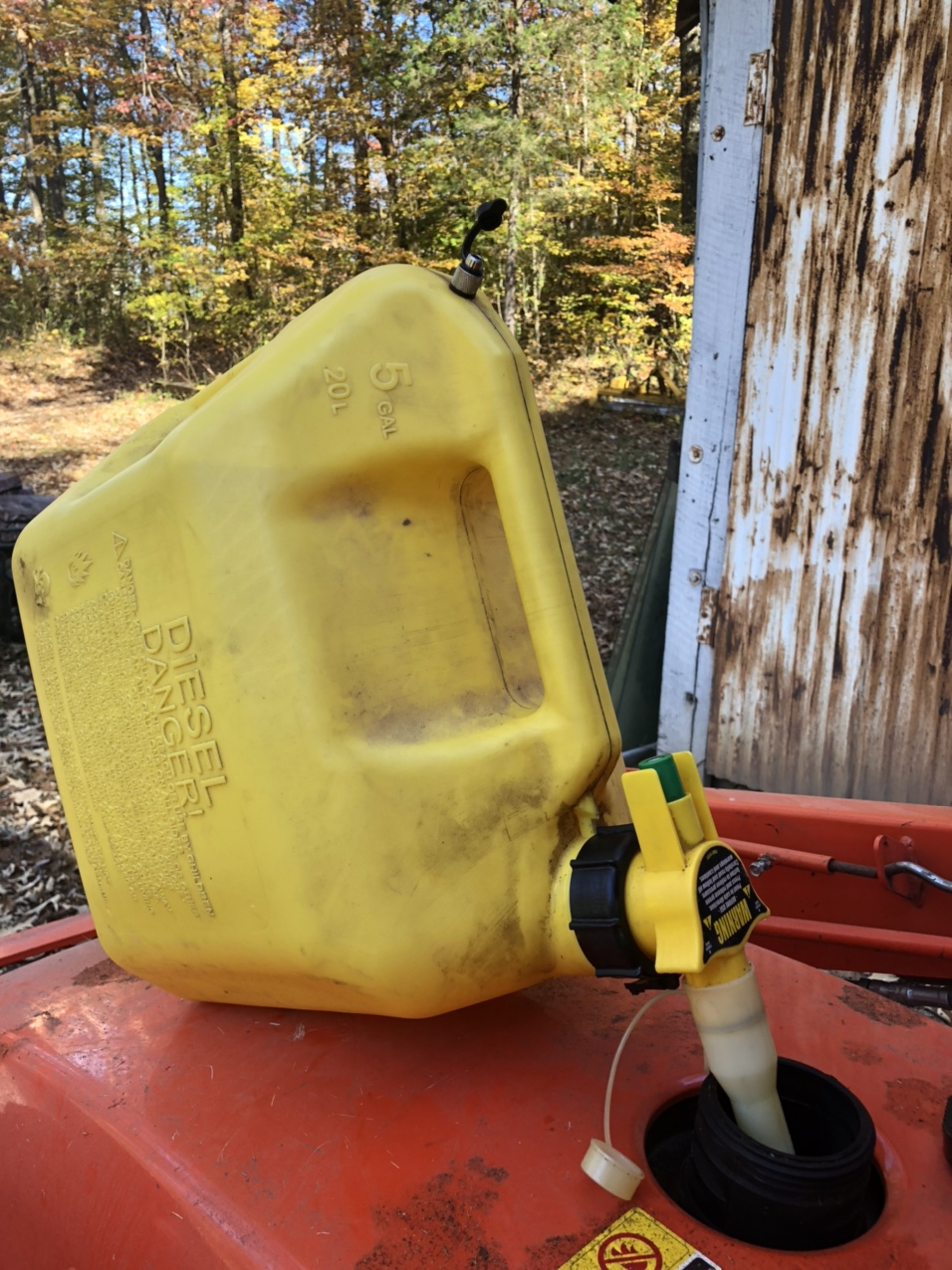

Like the no-spill diesel fuel containers. Even my wife can fuel the little tractor but doesn’t like to. The bad part was holding the button down. 5gallons took 2-3 minutes to drain. Added these vents.
ZOOYL Gas Can Vent Caps Retrofit Kit 6 Packs, Enhances Flow for Faster Refills, Universal Fuel Tank and Gas Can Replacement Vent Valve Made of Durable Stainless Steel with Attached Silicone Rubber Cap https://www.amazon.com/dp/B08VH2ZL1...abc_T7P0EXR2HVQBDW8NV2R8?_encoding=UTF8&psc=1
Now can drain 5 gallons in 30-40 seconds. Not a single drop spilled.
Also retrofitted some jugs for the bigger tractor.

But does the NO-Spill still shut off with added can vent as its designed to do with spout vent?
That’s a good question. It’s so controllable I have no trouble filling to the top without spilling with or without the vent. Haven’t challenged if flow would stop at nozzle.

This is what I have:
   / Fuel cans
There are some new nozzles that are absolutely impossible to use without spilling. Have retrofitted some old and new jugs to large flexible nozzles readily available. Maybe not legal in some states but not spilling fuel is important to me. The particular brand of jug in the picture works good for the smaller tractor. Two handle design helps lifting.
Not having to support the jug till most of the fuel is transferred helps my old joints.
