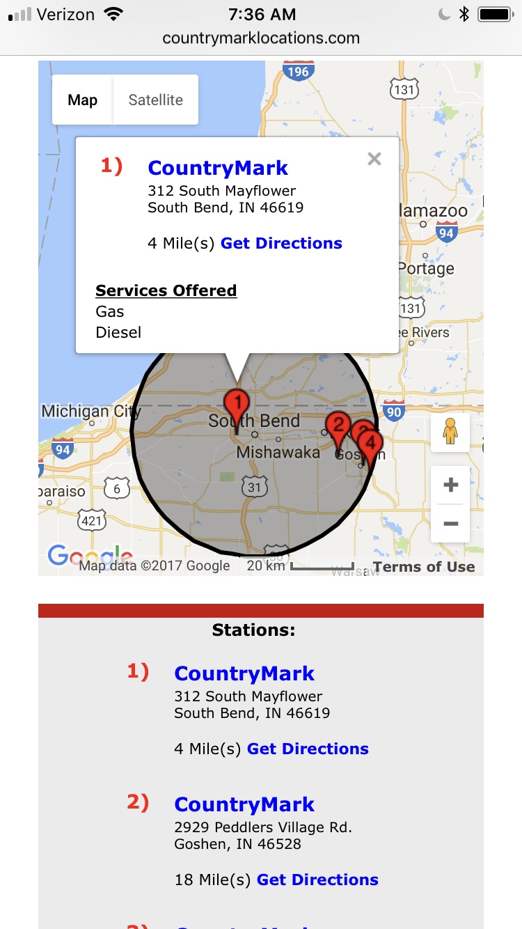

Not sure where in northern Indiana you are but I purchase ag diesel at the Countrymark Station in Fort Wayne. They’ve already converted to a winter blend.

I'm over by south bend. Interestingly while my property is rural the closest gas stations are in the city. They sell diesel but I would not trust their pump jockeys to know what blend is in the tank.
The weather men and women here are all predicting a colder and snowier winter.
/ Fuel addative #28
Looks like you have some Countrymark locations close by. The one I use sells Ag diesel and ethanol free gasoline which I prefer for my small engines. They both store well.
