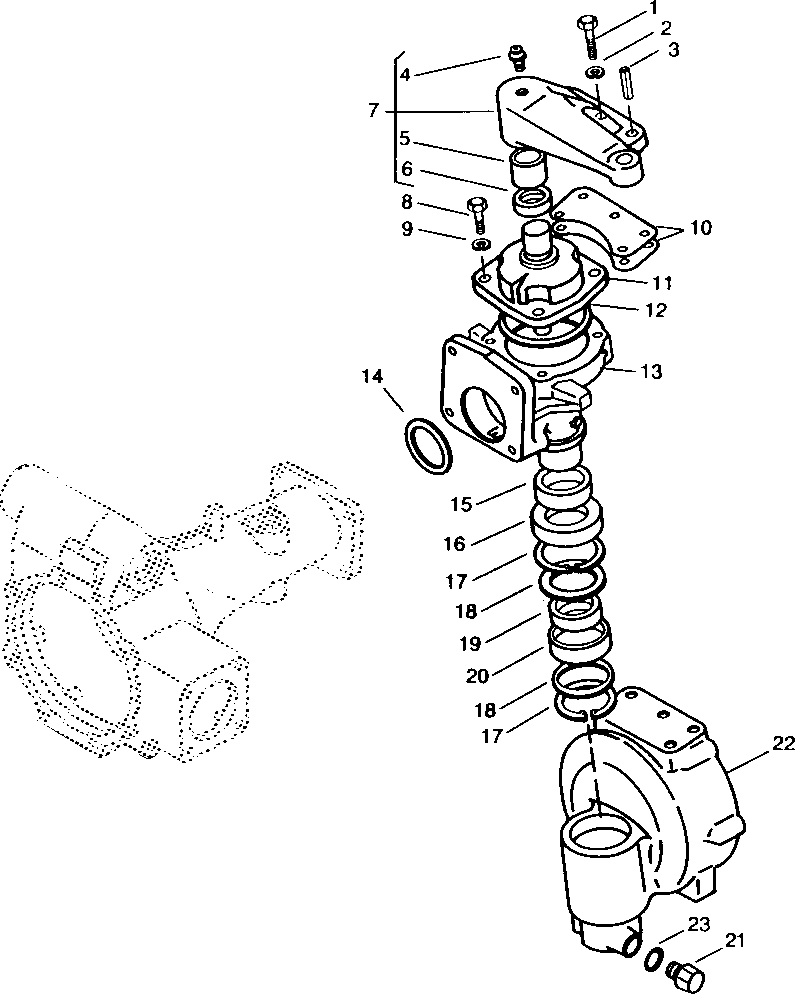

So, had to share this story and ask about next steps. I changed all the fluids on my auction bought JD650 (never trust another man's maintenance). Glad I did, it was a mess. The gear oil in the front end came out like liquid ****. Brown, think, almost chunky, it was gross. Then I pulled the dip stick (hadn't actually checked it before) and it was bone drive and ...rusty. Sigh.
Changed out the oil, made sure it was full, ran it for while over a couple of days, and then when I was changing out the coolant, I looked down and saw the left side wheel leaking. Checked the oil and the dipstick was dry. Well, it's a used tractor, I have to expect this stuff, right?
So, going to need to replace the seals on the front wheel drive I think. Really don't want it to be a huge project, just get it sealed up and git 'er done. Any advice on this? I have the tech manual, but of course that section starts assuming you've disassembled the whole front axle assembly already! Will I need to drop the whole axle off the tractor or can I remove the wheels, drop the wheel axle units (I don't know what the heck you call them) and replace the o-rings and seals. Might repack the bearings while I'm at it.
Thoughts?

shouldn't have to remove axle, just the ends, bearings run in oil

So, after letting the tractor sit for a week (because of moving back to standard time...sigh...I miss daylight.) I checked the front end and realized that both left and right sides are leaking and fairly significantly (noticeable puddles under both sides.
Might start the tear down this weekend, but would rather order the parts first so its not sitting on jack stands for a couple of weeks.
So, looking at the parts diagram(below), the leak is in the assembly between parts 13 and 22. So, should I just order all those parts in between (parts 15-20) or just the seal? I don't expect that I need to replace everything to fix the leak, but since they all seem to work together on that joint and aren't overly expensive (seal is most expensive part), do I just get them all and rebuild that joint?
/ Front Wheel Drive on JD650 #6
I would replace all seals and any bad bearings
/ Front Wheel Drive on JD650 #7
Hate to rain on your parade but item 15 (ware sleeve) is no longer available from JD but you can check with SKF or Timkin for an after market sleeve that fits the dimensions. Last resort is having a machine shop turn one for you. The sleeve is .1" thick and rides inside the oil seal.
You'll want to attack that little job through #22 and there is an oring on it's face you might want to pick up.

Got all the parts today, except for that ware sleeve. But, I think I've found a place for those! Weaver Tractors Weaver's Compact Tractor Parts & Compact Tractor Salvage Going to order them, since the seal will only be as good as the sleeve.

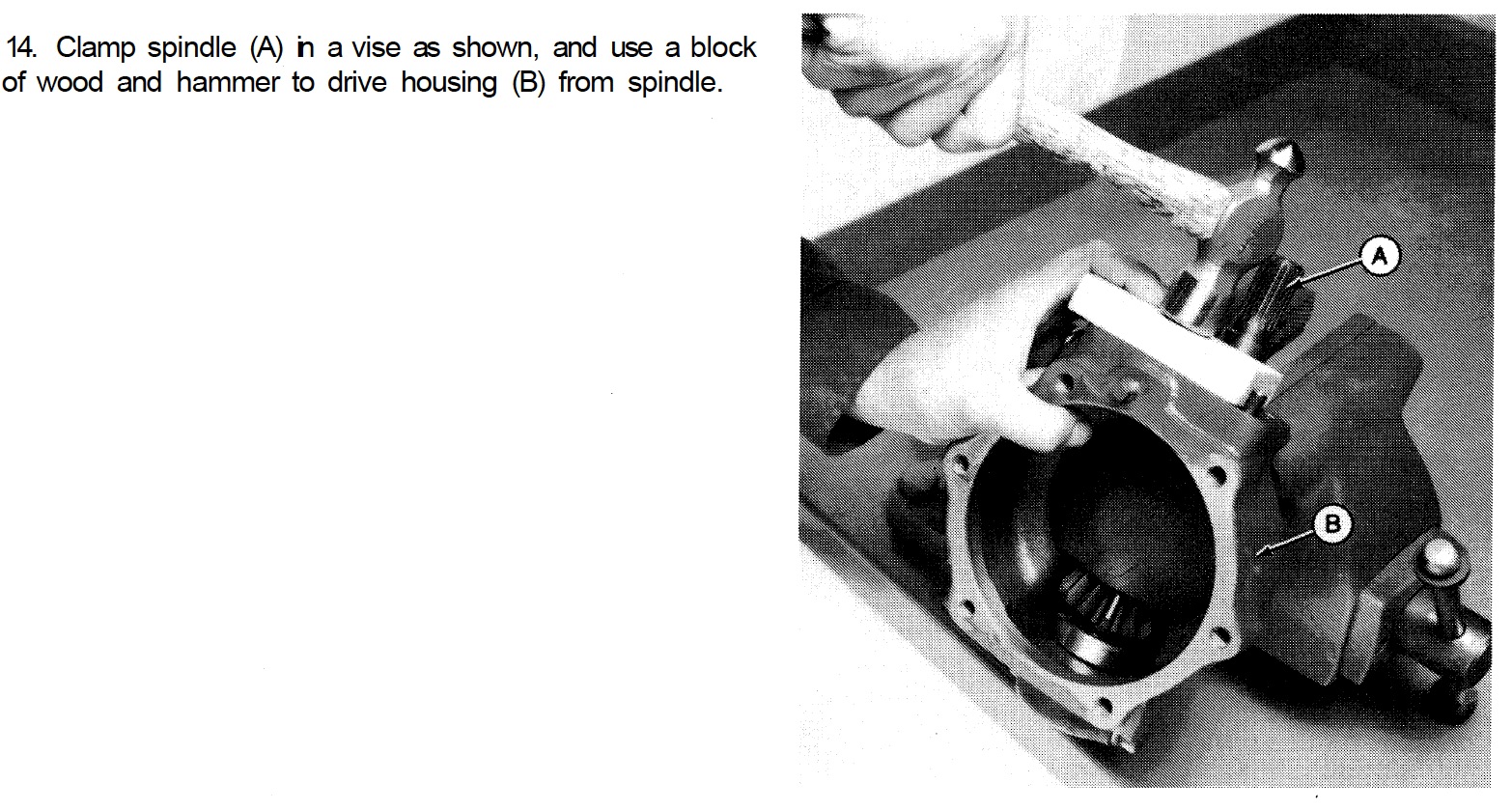

I was able to drop the housing on both sides and bring them inside to replace the seals the morning. Ran into my first gotcha, removing the spindle from the housing. Tech manual instructions below. Been mucking with it for over an hour and it's just no budging. Any advice? This is a stupid way to have to take this dang spindle out and I am worried about screwing up the drive gear (although it should be catching on the housing without screwing up a spline).

My YM186D has that same axle,but haven't worked on it yet. Is the gear holding it?or the inner bearing race #19 ?? If the inner race is stuck,it looks like it will come out if you remove the upper snap ring,and you can remove it later. Is the bearing bad? If it aint broke,don't fix it.

Well, the trick is... soak it with PB Blaster and go take a nap! A clear head and a couple of good whacks and it came off. Now I'm tearing apart the spindle housing and the needle bearings came out in little pieces and the retainer was completely shredded. Glad I got all the parts! Can't get the needle bearing housing out now, so it's soaking in PB Blaster while I relax and have dinner and maybe an adult beverage. Hopefully the right side assembly will go easier after I've done this one (assuming I'm able to get the new parts in there without a hassle!)
