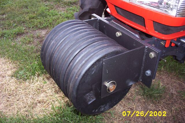

My dealer wanted $425 plus shipping for a set of suitcase weights (240 lbs) and the bracket. I made a simple bracket to hang 300 lbs of barbell weights. I couldn't find any used weights, so I ended up paying $150 for twelve new 25 lb barbell weights.

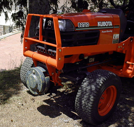

I used a piece of 21/2 X 2 1/2 square tube about 22" long. I filled it with lead and bolted it to the bottom of my grill guard. That added 62# to the front end. I put a bracket consising of a 12" round plate with a 2" pipe welded to the center. Round plate has four mounting holes for bolts thru wheels. I put 2 pieces of 2 1/2" x 10 1/2" round stock on each wheel. That adds about 300# to rear of tractor. Tractor is a B7500HSD.

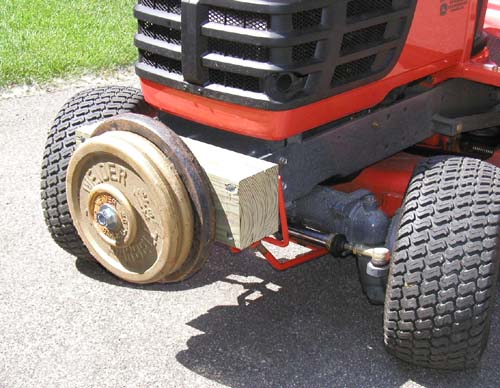

   / front weights #27
Re: POST YOUR PICTURES OF FRONT WEIGHTS / BUMPERS
Since I'm not a welder, here's what I did.
   / front weights #28
OOP's!
Try this again.
   / front weights #29
O.K. here is what I did. Used two smaller wheel weights that are about 60lbs each. Just bolted them to the front bumper.

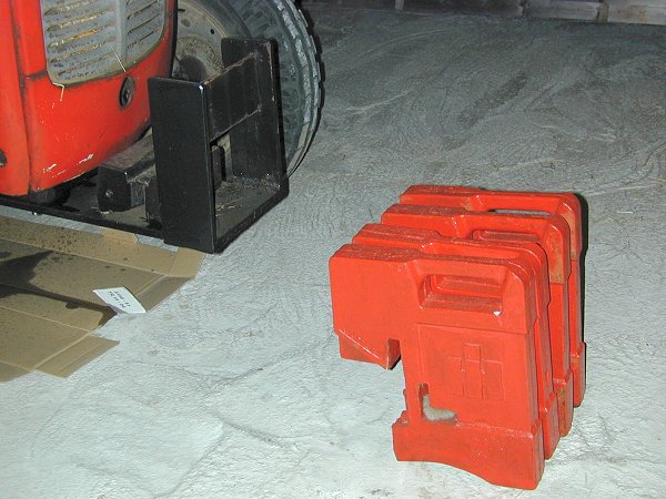

Is it realy so difficult to find used suitcase weights in the US?
My local scrapyard always seems to have a few in stock.
I resently bought four IH weights of about 60 lbs each for aproximately $10 each. When I welded a simple bracket from sheet metal found at the same yard and bolted it to my MF35 as you can se in the attached picture.
The small weight is from a dismembered washingmachine, I thought it was better to recycle it!
