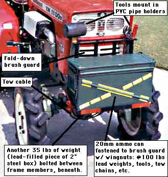

Since I'm not a welder, here's what I did.
