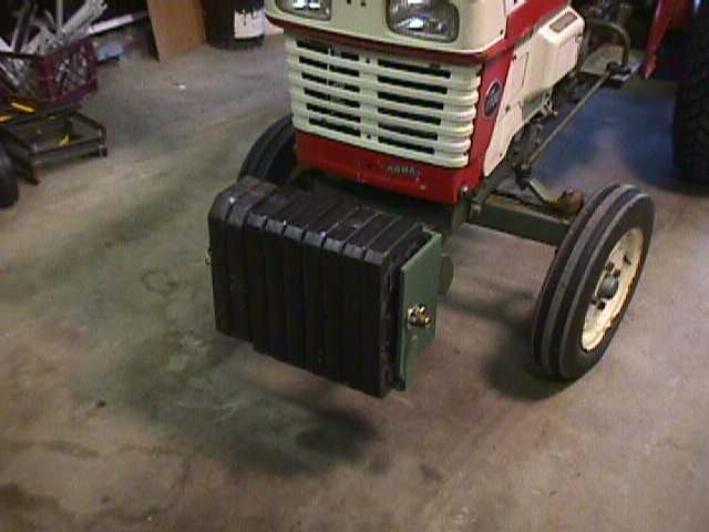

Another shot
/ front weights again #12
It was made from 2" galvanized pipe. The center frame is made from angle iron cut to fit around the pipe. I put bolts through and welded the heads to the frame so you can set it up on the bumper and not fight the bolts. I had paint matched to the frame. I don't mind questions, it gets boring this time of year.
/ front weights again #13
thanks again..I doubt that my bumper will look quite that nice,
unless you're in the business of custom fabrication! /forums/images/graemlins/grin.gif
if you're taking orders, I need one to fit a 1401 /forums/images/graemlins/wink.gif
tony
/ front weights again #14
Inspector 507, that's another nice looking set-up.
thanks! /forums/images/graemlins/smile.gif
/ front weights again #15
</font><font color="blue" class="small">( I will attach the bumper / weight I made for my first YM1510. The 2" pipe was filled with molten lead. It was much heavier that it looks. )</font>
How much do you figure it actually weighs? Very nice!!
Bob
