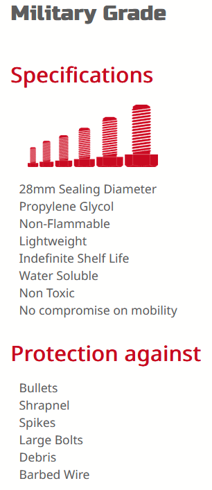

The Kevlar sealant has to be this way per the military standard code MIL-A-46106.
- Non-Corrosive, Non-Flammable, Non-Hazardous
- Remains Fluid Down to -52 degrees C
- Easy Clean Up, no Mess on Tyre Changing Station
The military has to have more than one source for Kevlar tire sealants.
Kevlar Tire Sealant at the Affordable Price | PermaShield
Gemplers UltraSeal was the military standard back in the day, however, it can not maintain extreme cold temps nor speeds over 30mph.

kevlar is not the unique fiber ingredient to any of this.
It is a useful fiber on the strength to weight ratio/ It makes great fiber reinforced panels/

This is what we have to use at the MRO depots for the military service fleet trucks. Only Kevlar formulas are used. There are other detail sheets specifying the fiber lengths, normalized fiber diameters and the youngs modulus range. The fluid is propylene glycol 57-55-6 or known as the pet safe sweetener found in salad dressings, BBQ sauce and gummy bears.
