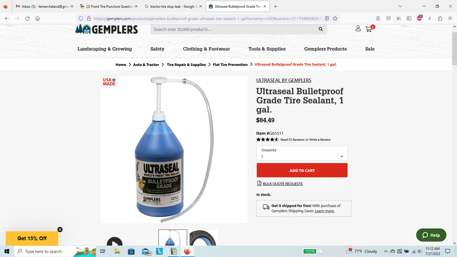

Then Gemplers has several including this one;
I used these one many years ago in West Texas on a little IH 300 utility because of the numerous Mesquite thorns.
It was a tubed tire and I used several gallons it was amazing what the tube and tire inside looked like when I finally broke it down, it was a complete pin cushion almost impossible to handle from all the thorns.
