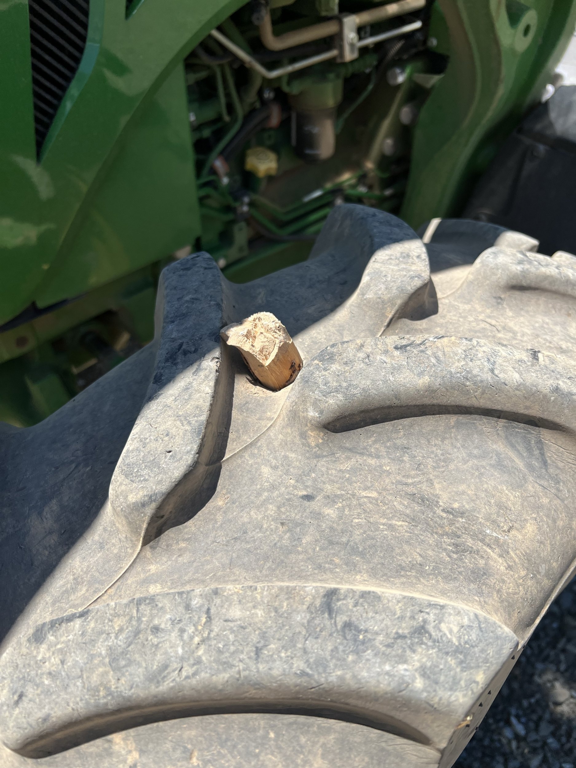

I got a deer antler in a rear tire of one of my tractors. Too large for normal fix and feel secure about the fix so I booted the antler hole which should have been good enough to hold air, but then also tubed it to make sure. Common practice in this area to repair a puncture.
