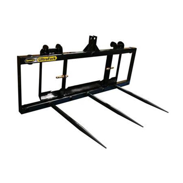

I have a Speeco UltraFork that fits front or rear. you could build a fork frame the same way.

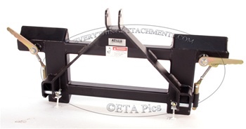

I found one so far. EAs has one listed ATI 3 point to quick attach adaptor at 1100 bucks including shipping. ImageUploadedByTapatalk1454444110.676709.jpg
Anyone sees any more please post.

Ya, $1k is kind of insane. My SSQA to 3pt cost me $100 in used parts, would have been under $300 with new parts. The male SSQA interface is more complex with the pins & levers, but I can't see it running more than $500 to make one. Back when I looked prices were stupid high in that $1k range if memory serves. One of those things with low demand jacking the price up I guess.

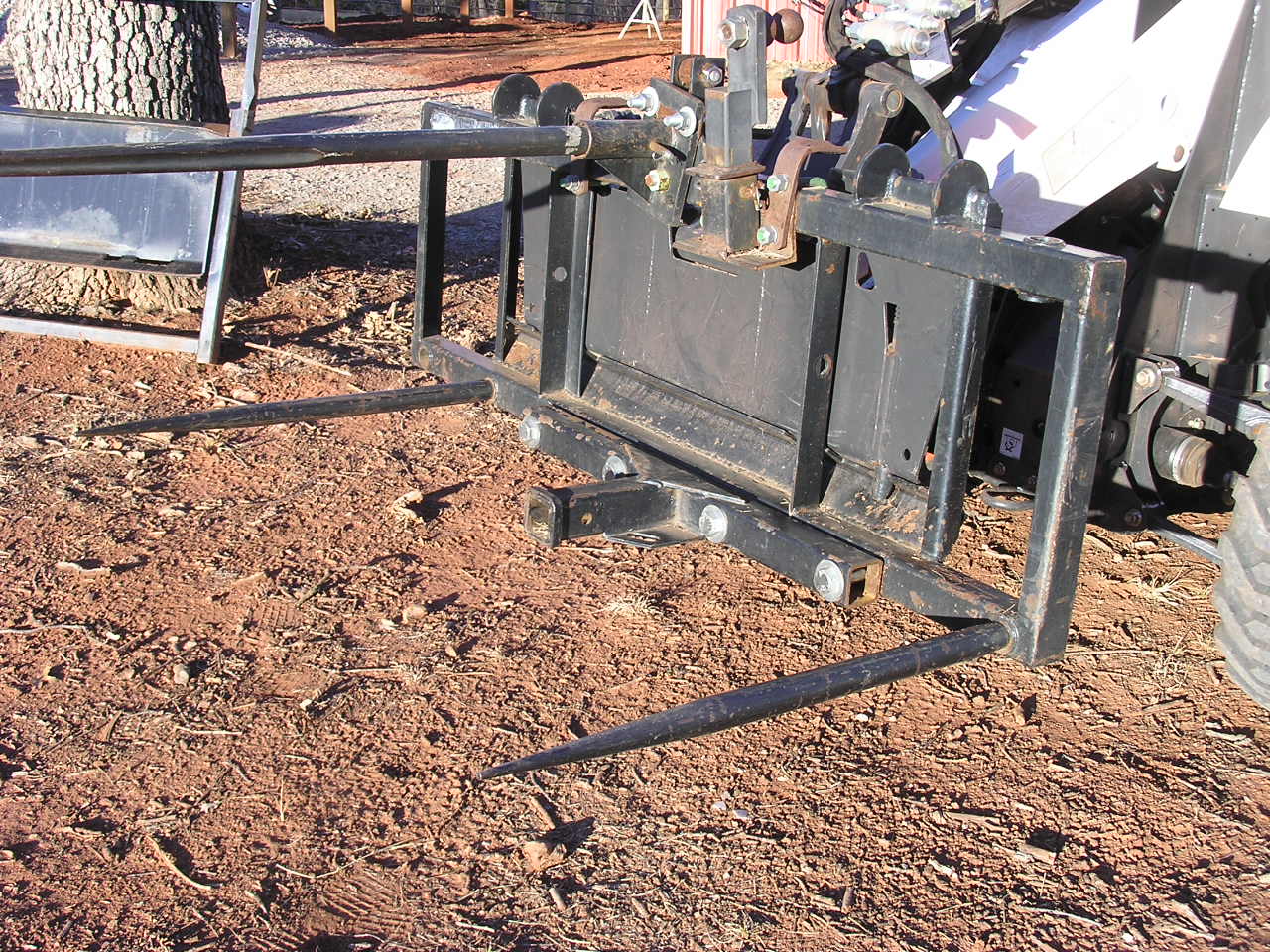

Here is what I did.

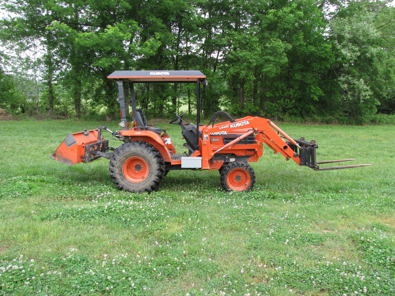

Leejohn, that's exactly what I had in mind. Can you show a close up of that rear setup? It looks like a pin on to SSQA plate modified for three point?
I figured I could use the pallet forks to carry a carryall box/ballast etc that way when the bucket or grapple is on front and the bucket when the forks are being used.

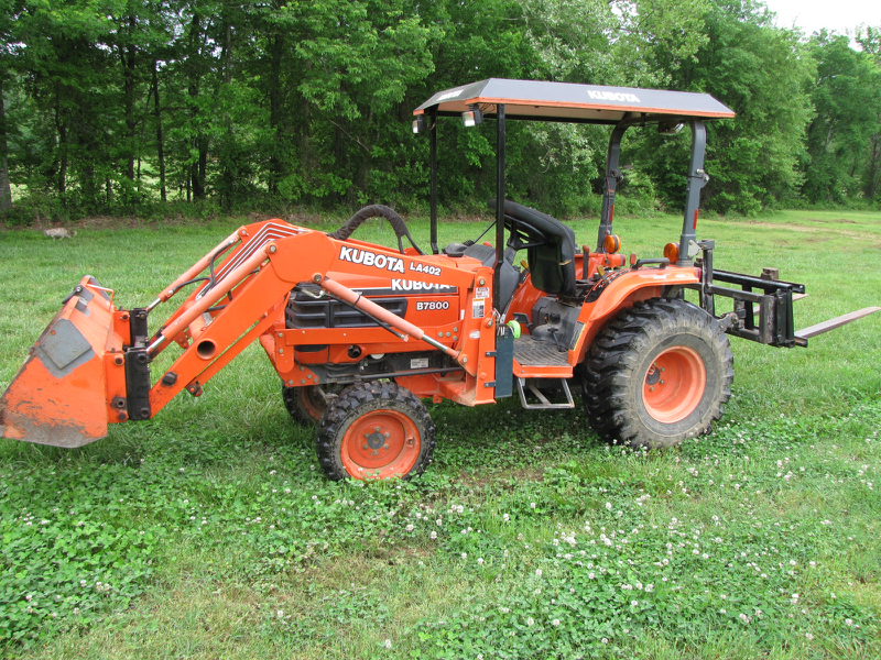

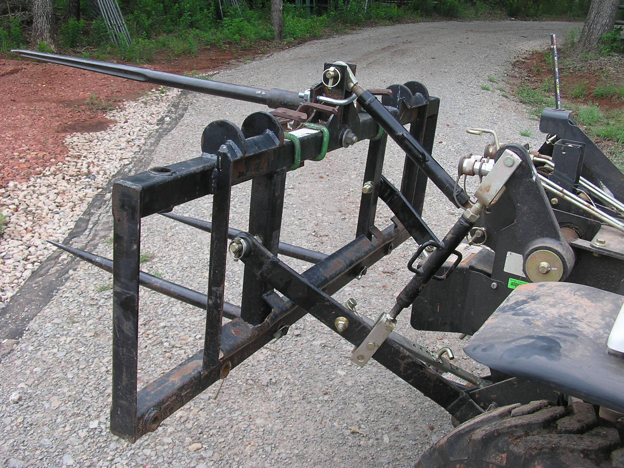

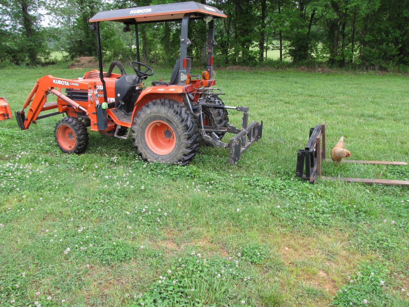

!st off they don't make a SSQA for my B7800, so I came up with this. I must say I like it better then the one that came with my L4240. If I can find the time I'm going make some hyd cyls for the pins to hook and unhook it.
The frame I made for the 3 pt started out as a hiller and planter, then I made another set of brackets for the bucket. I also can use the forks on the back without the frame set up.

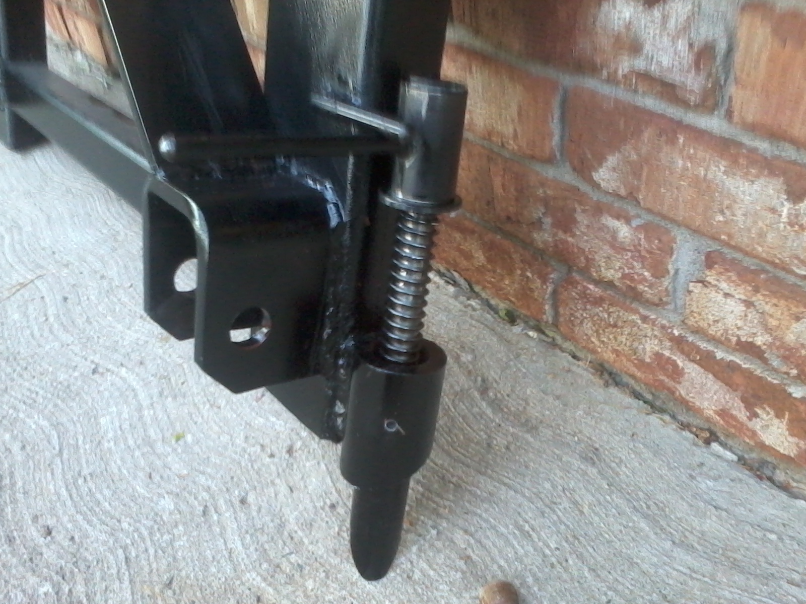

I built this from scrap metal and never used it yet. Just thought I needed it I guess. Hope it helps.
Steve

Steve, where do I need to come pick that up since you don't use it! <laughing>
That's exactly what I was thinking of.
